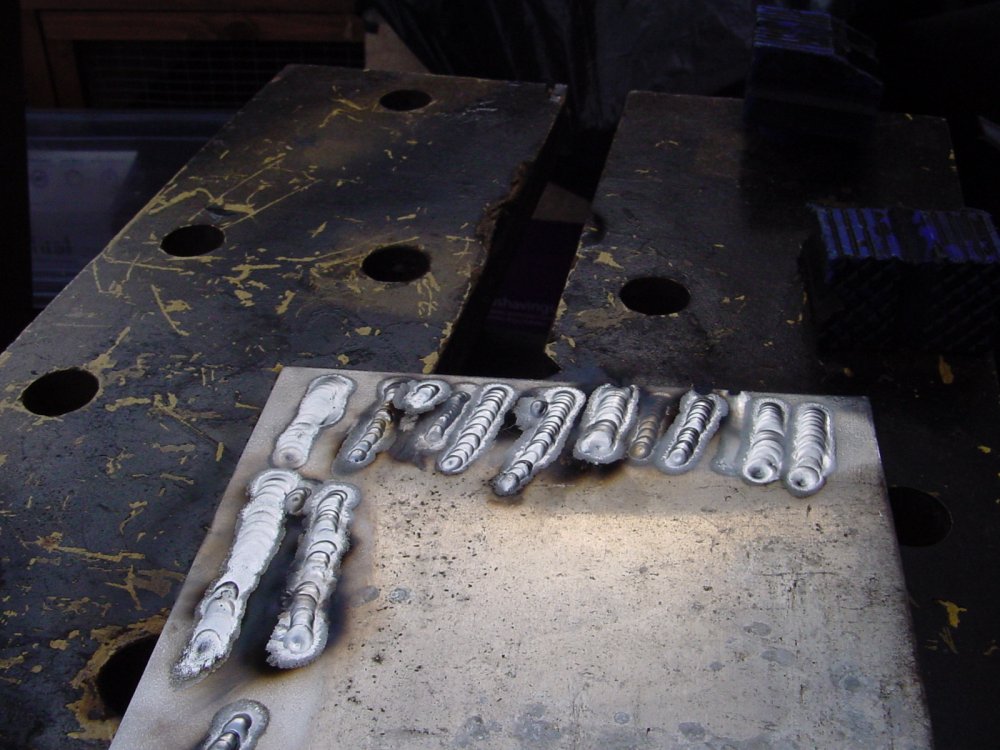

Aluminium is a fantastic heat sink.
The current required will increase with the size of the job.
It will also vary depending on how near the edge of the sheet you are welding.
This is one of the reasons many say a foot pedal is needed
Jabbing the tungsten into the weldpool is common when starting out on ali due to adding more filler rod giving a taller pool as the weldpool size is generally bigger than with steel,
The tungsten may be getting jagged for a couple of reasons, one being where you're touching the pool or possibly not enough ac balance cleaning?
Be sure to regrind the tungsten if you touch the pool or touch it with the filler rod, very easy to not bother and think you'll get away with it, we all do![]()
The black sooted welds are most likely where you've dipped the tungsten into the pool or touched the tungsten with the filler rod,Cheers I noticed that, after practising the arc gap with steel all of a sudden with ally things are all change
I was going to ask exactly that as well about the tungsten. So after "every" touch down no matter how small it needs regrinding? As you say it still works so is it that critical ?
I need to read up on ac balance as am only using the default Lorch factory settings the machine comes with
As it is sometimes the weld bead looks to come out spot on with no black edgings, then the next one is blackened so I assumed user error ?
pic below some look ok .. ish, others are blackened on the outsides ?
Am on it, many thanks for all the pointers. Much appreciatedMaybe get on youtube with keywords like 'tig ac balance'
Clean the material properly and it will make a big difference
Depends what you have used it on before. A new or dedicated stst wire brush or scotchbrite and acetone is what gets it properly clean. If there is any trace of oil grease paint etc it will be embedded into the surface of the ally.
