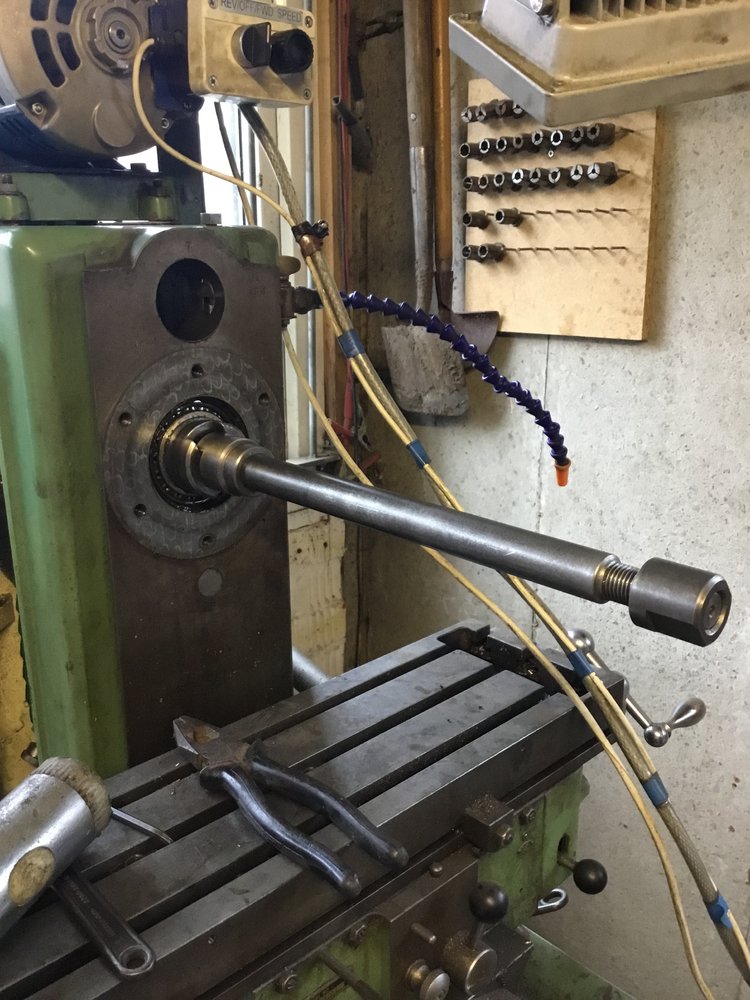

I'd say that was a No 30 taper looking at the drive dogs....

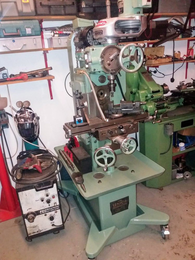

Crikey, miller on wheels! Did you make it?The horizontal harbour is MT3 on the Tom Senior M1
I have the same machine
The dogs are to drive the vertical knuckle head or slotting head.
YesCrikey, miller on wheels! Did you make it?
I to have a Tom Senior. But bought without the horizontal spindle and supports. Draw bar at the back or should be needs unscrewing. Or make a puller with piece of tube if no drawbar. Don't wack it out.Hi got myself M1 milling machine wonting to change dividing head as you see on photo unfortunately this bar doesn’t won’t out don’t won’t to damage it some advise please

It must have a draw bar
