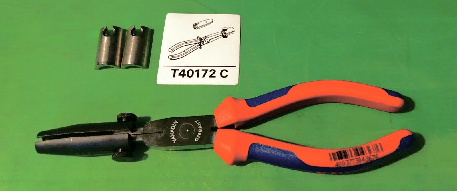

That’s a pair of knipex pliers with some adaptors on the end. Can it be replicated with a lathe?I need to remove the boot liner on my tt to run a cable
The fixing is a spreader rivet about 40mm down a hole
Audi tool is this
I really don't want to spend £200 on a pair
Anyone know what the tip profile is or got a non oem version?
Or a suggestion to pull the pin? Long nose pliers maybe?
If you do order new clips from your main dealer, ask price of pliers (I have found them to be cheaper than advertised online) if price is still too much ask whether they'll remove the clip for you
pennington forceps has to be a good starting point at two pounds fifty pence. rub with a flap disc to sharpen the end ,
If you don't mind destroying the clip, drill centre and use a woodscrew to extract.
