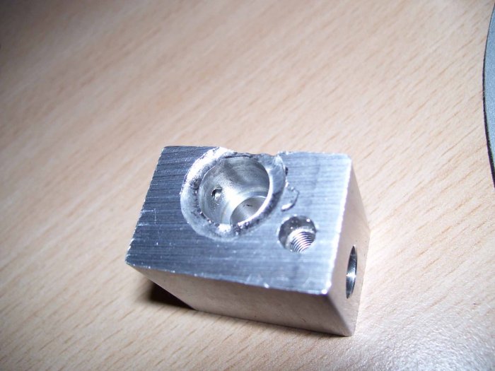

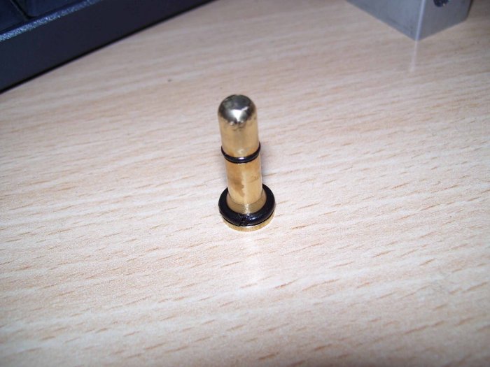

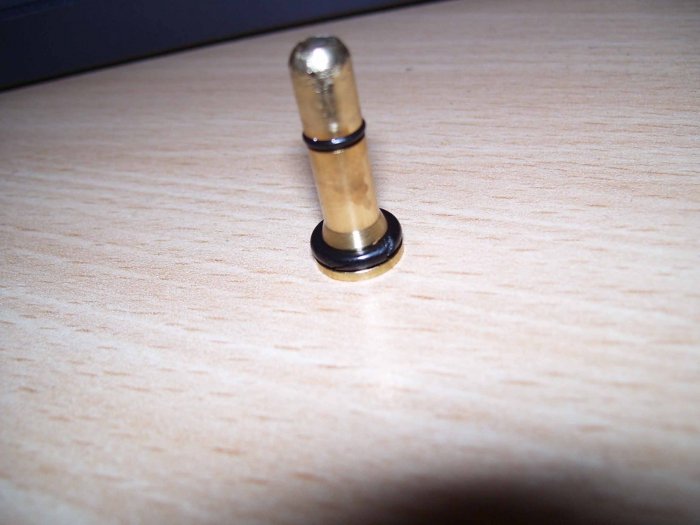

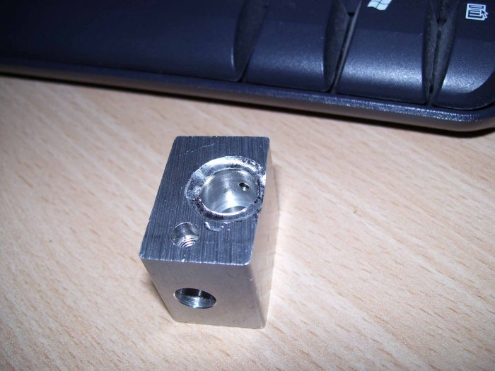

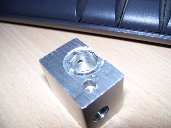

To all you Clarke MIG Welder Fans. Recently had a leak in my torch trigger gas valve. After cleaning it I decided to dismantle it. Good job I did. To my horror I found a large burr in the O ring chamber area where the sealing of the gas flow takes place. This in turn had gouged the O ring severely causing the gas to leak passed at a high rate of knots. I did quite a bit of research before buying my first MIG and Clarke came out on top. Must make the competition pretty poor if that is the case!!!!! Very Disappointed
See Photo's Attached
