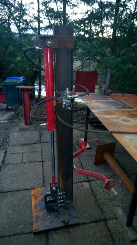

Thought I'd share a pic of my latest workshop project - it's a 3 point linkage mounted hydraulic log splitter for my mate's farm. My mate supplied the ram, removed new from a slurry pump, and I sourced the rest of the materials/components.
main frame is 89x152 RSJ with 3"x3" heavy angle for the top ram mount. The splitting blade is made out of a lump of heavy plate approx 1 1/2" thick - took forever to cut the blade point! the rest of the splitting head is made of 10mm plate and 50x50x5 angle. Base is done with 3mm tread plate and some 3" channel to brace it. Rear 3 point linkage is also from the slurry pump that supplied the ram. Single spool 3/8 valve and associated hoses to plumb it all in.
All in, about 4 hours work to make it - testing takes place tomorrow!
