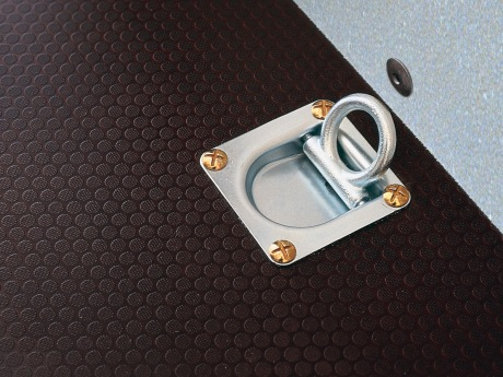

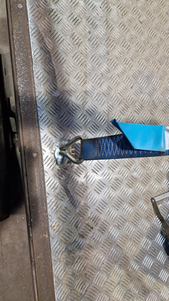

Every trailer under 3.5 tons I have ever used seems to have broken or bent lashing eyes. They never seem to be strong enough.

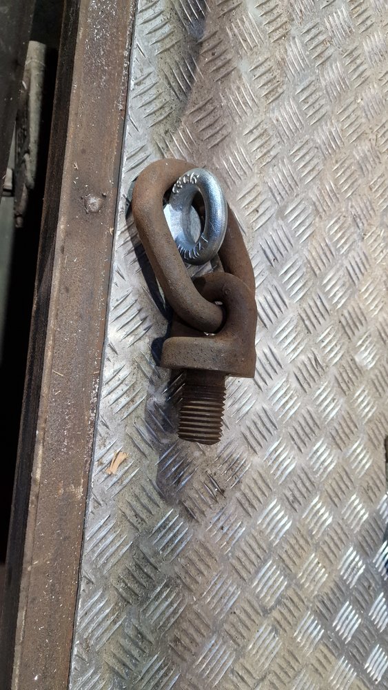

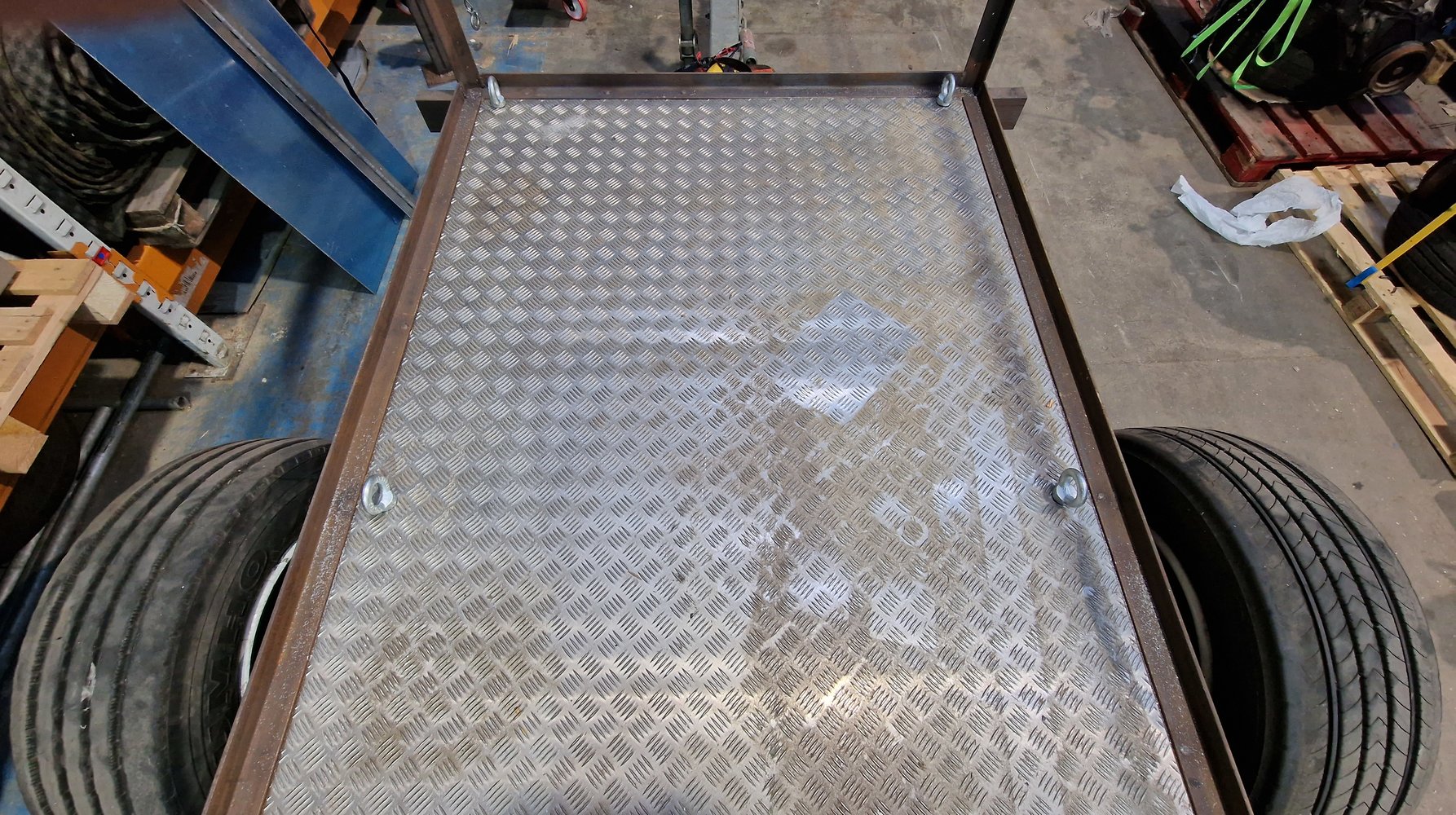

So I decided to go a bit heftier

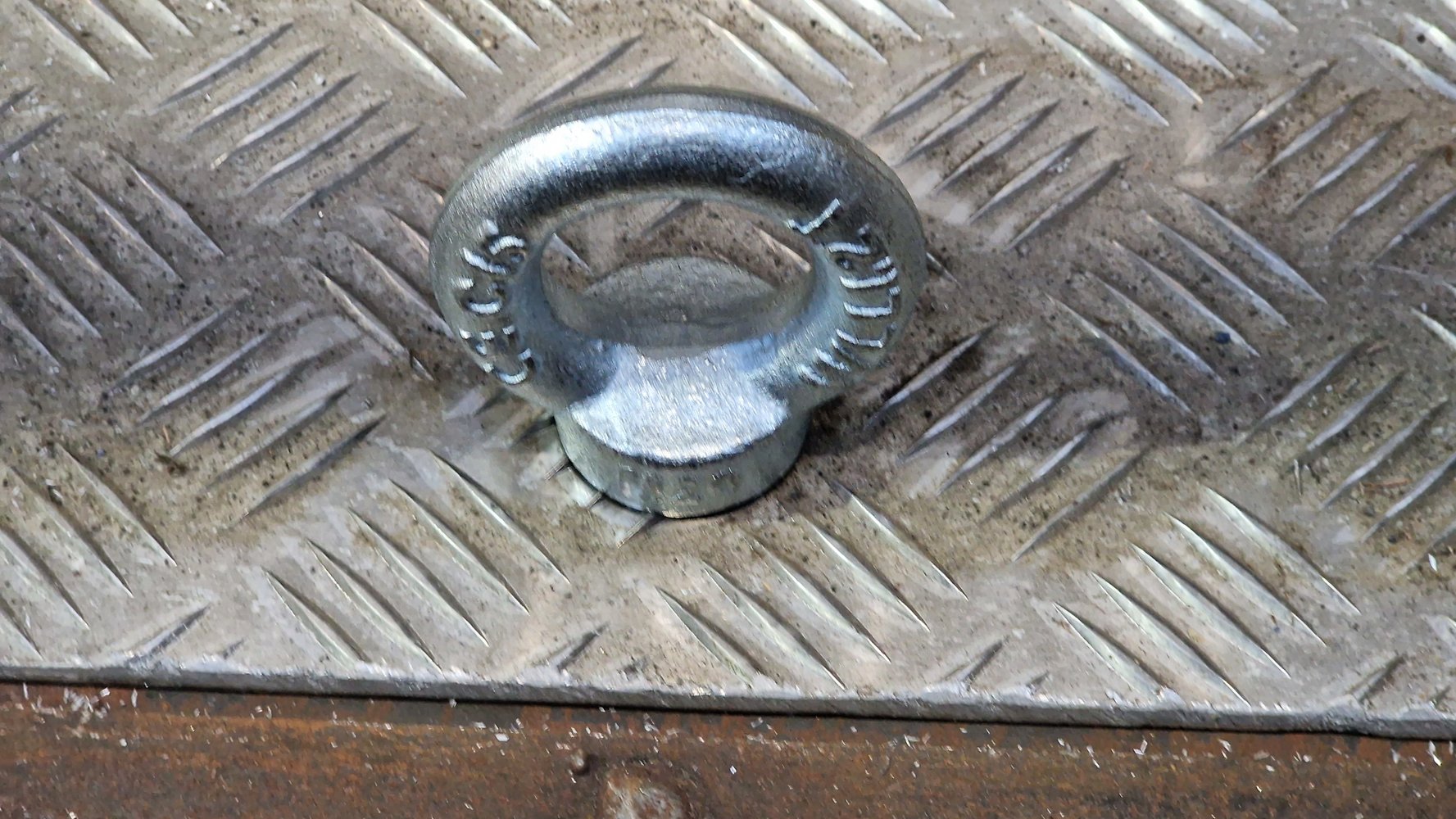

Threaded the main chassis of the trailer M20 - so these can pivot if they need to or be removed easily.
Ideal for holding down lathes and milling machines. 6 in total.
