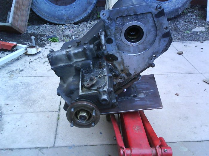

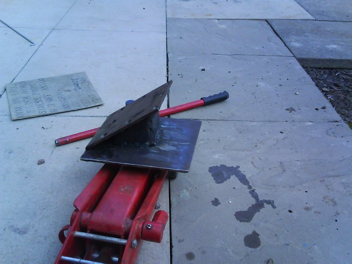

punctured case whilst helping mate move some stuff bar in ground came up and hit it.
could have just changed plate from disco one i had.
gave me excuse to put disco box in as mostly used on rd these days as shes getting old and battered like me.

im just about to put another disco box im my 90, infact i went and got the other box today.

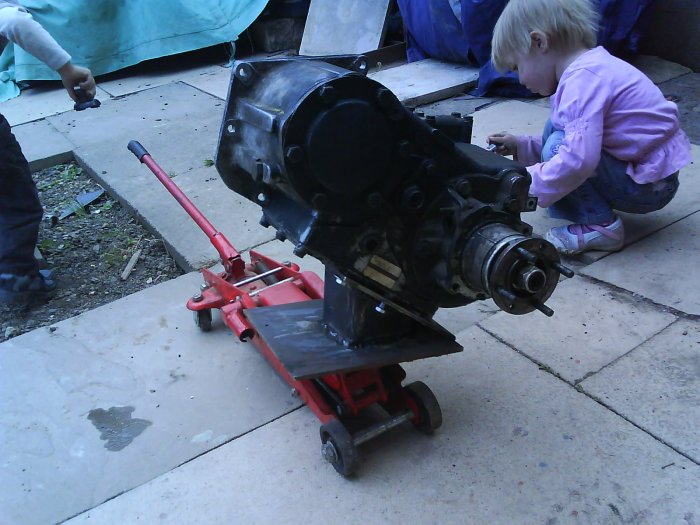

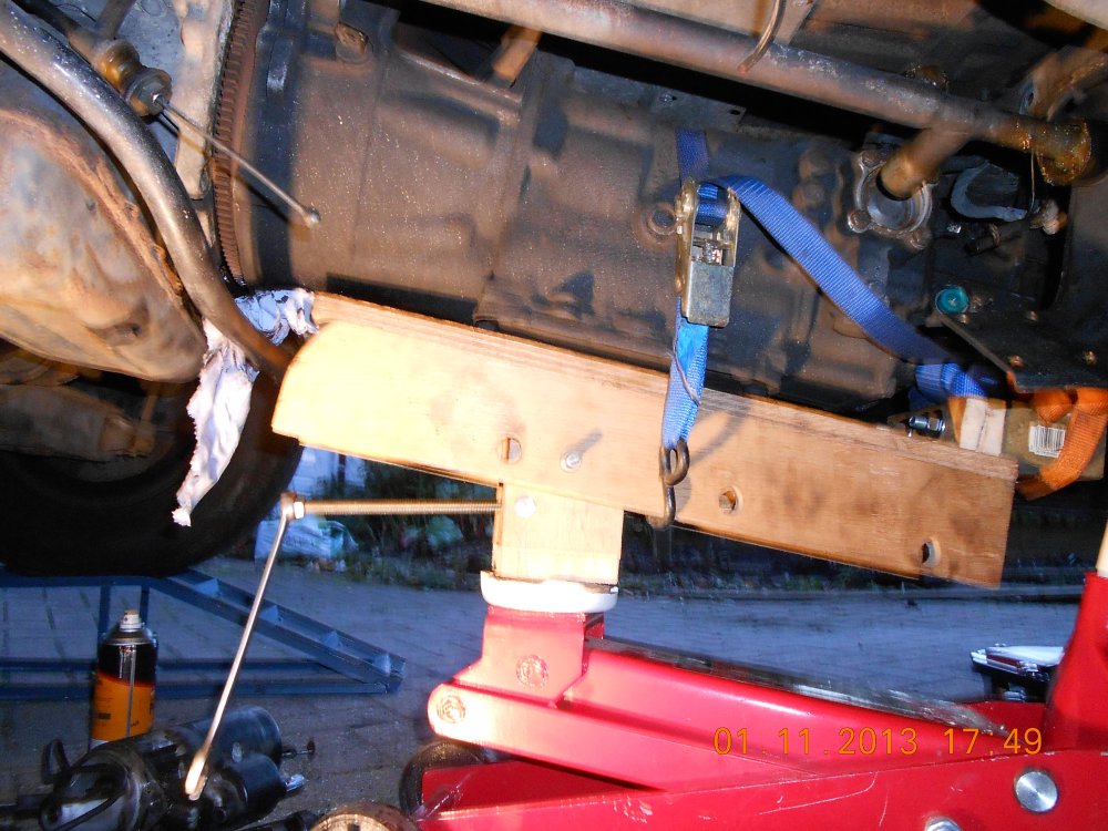

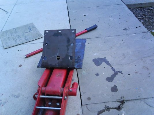

liking thye idea of the stand on the trolley jack, as there heavy to lift of your chest!
the disco box thats on at the min is full of metal shards, so i will be putting this other one on at the weekend.
one of the best things i done putting it on, i find that i could do with a 6th gear as it pulls really well in 5th.
Nice, but do you know that roverdrives do an extended LT230 sump? Presents a flat face (well, pretty much flat, it's got fins for heat dissapation) to the bottom, as well as increasing capacity, and cooling.

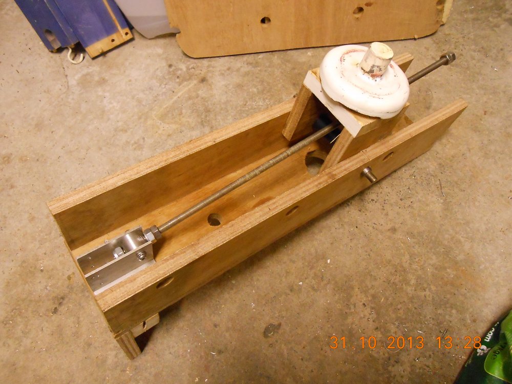

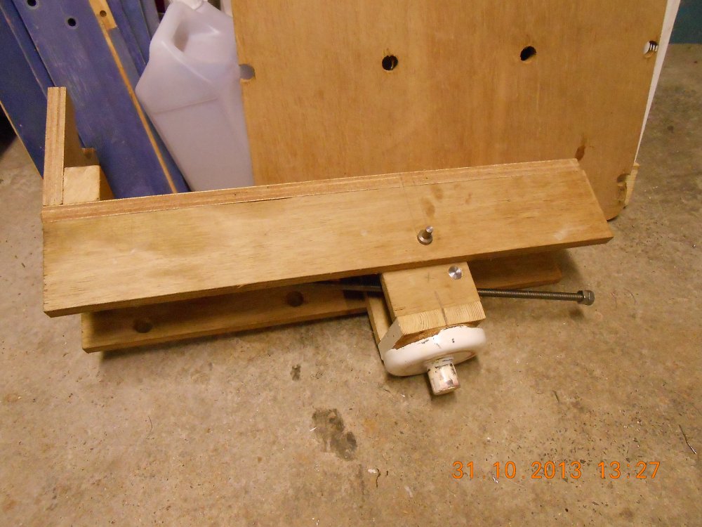

Not a steel fabrication because I have more wood than steel lying about, and since the van would not move, I used what was there. Got the design sorted for a metal one, so that is on the 'project list'.
