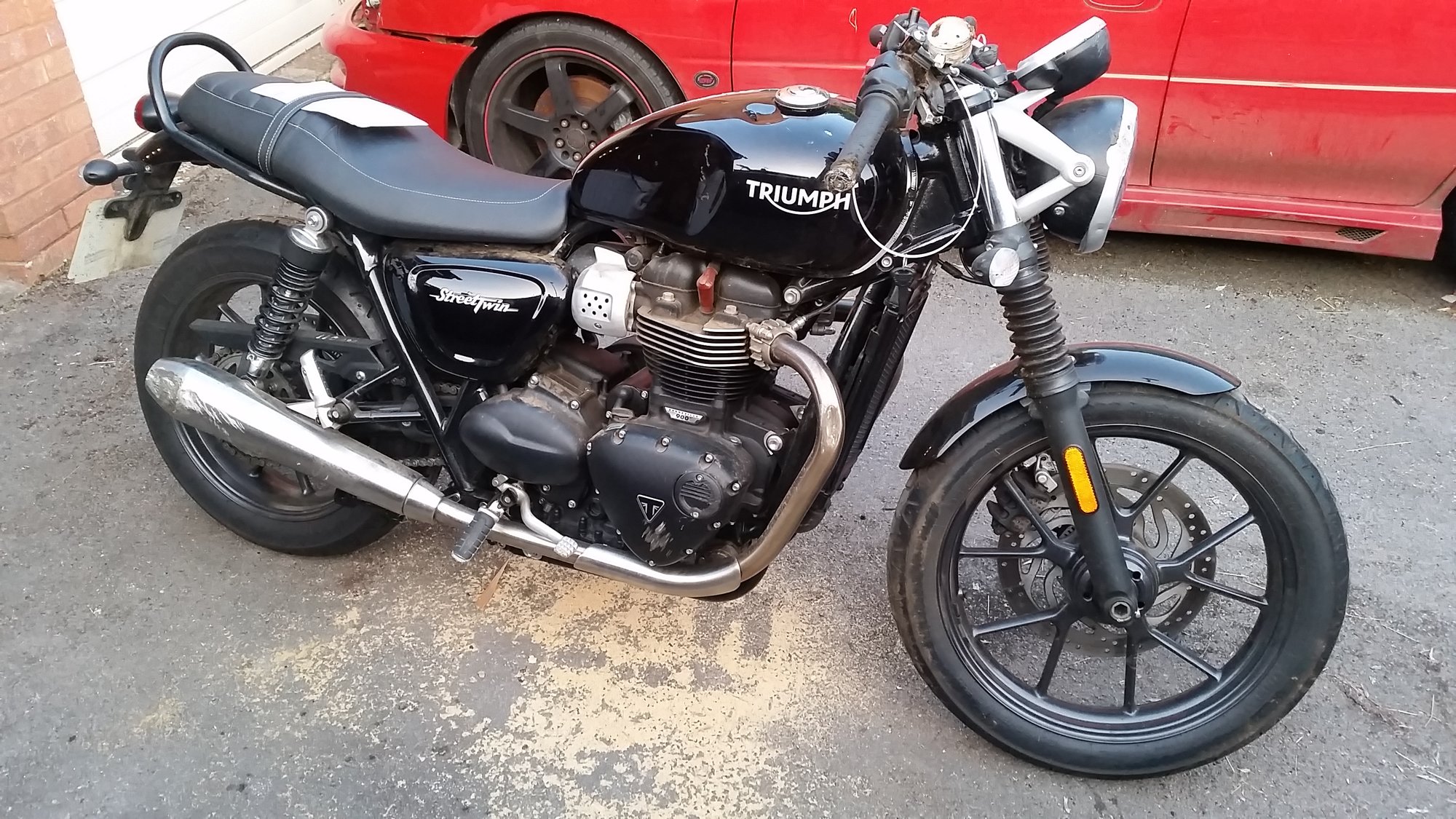

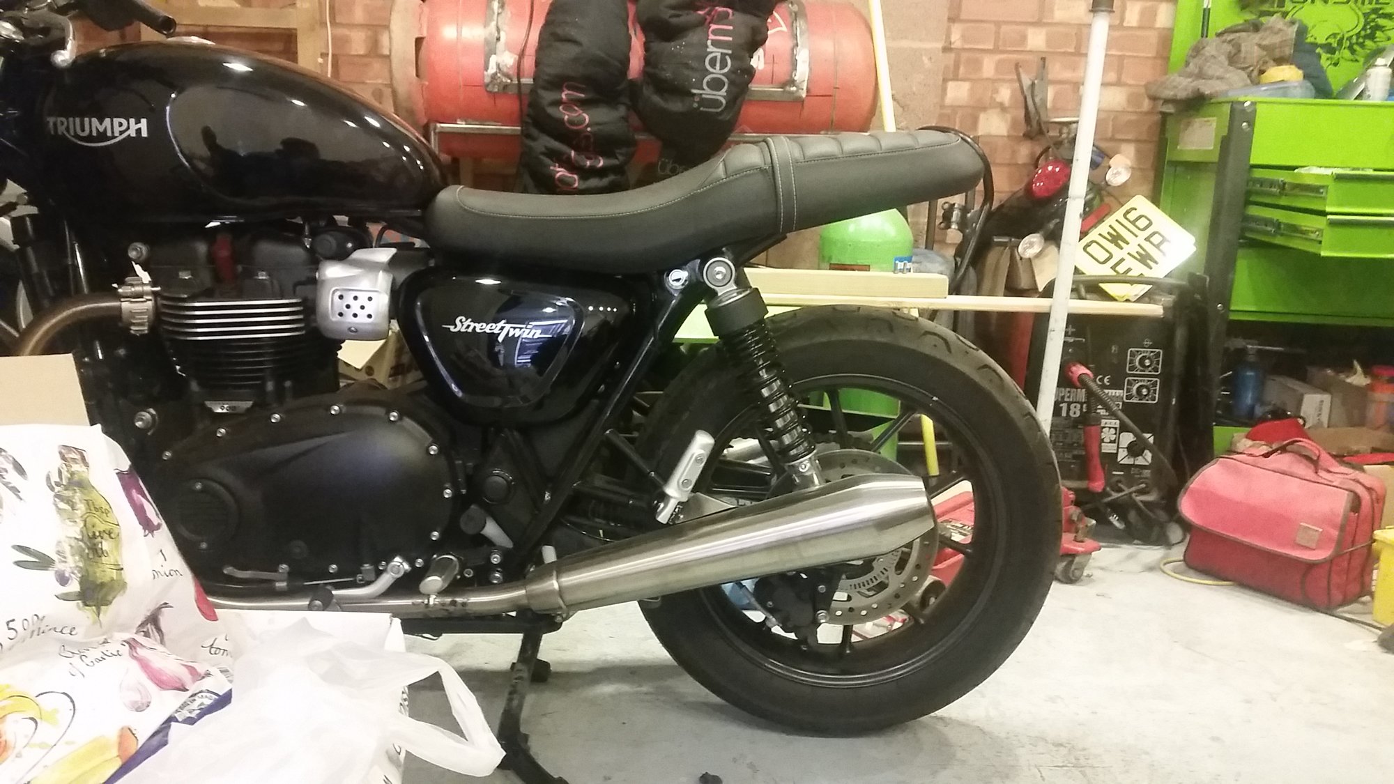

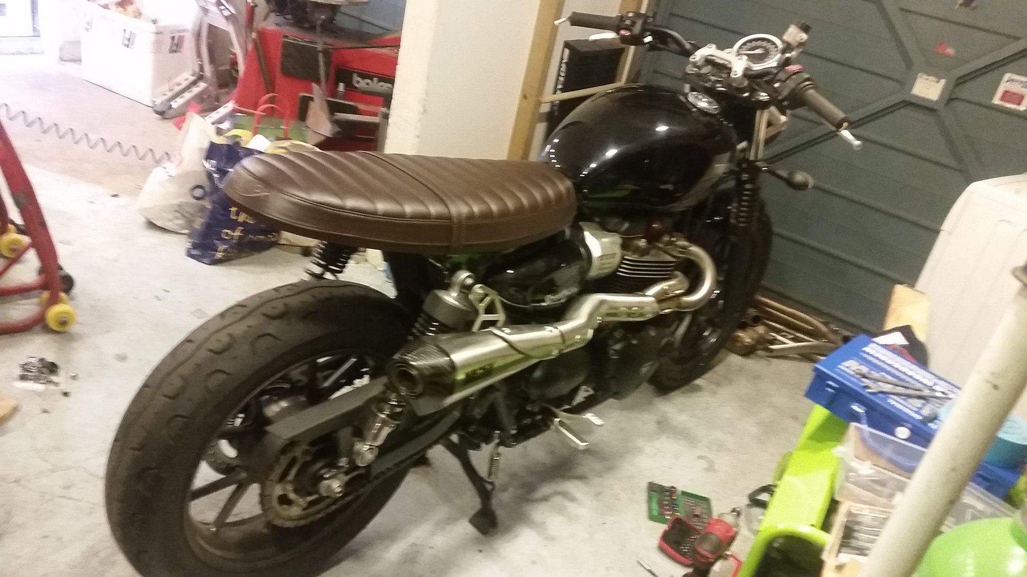

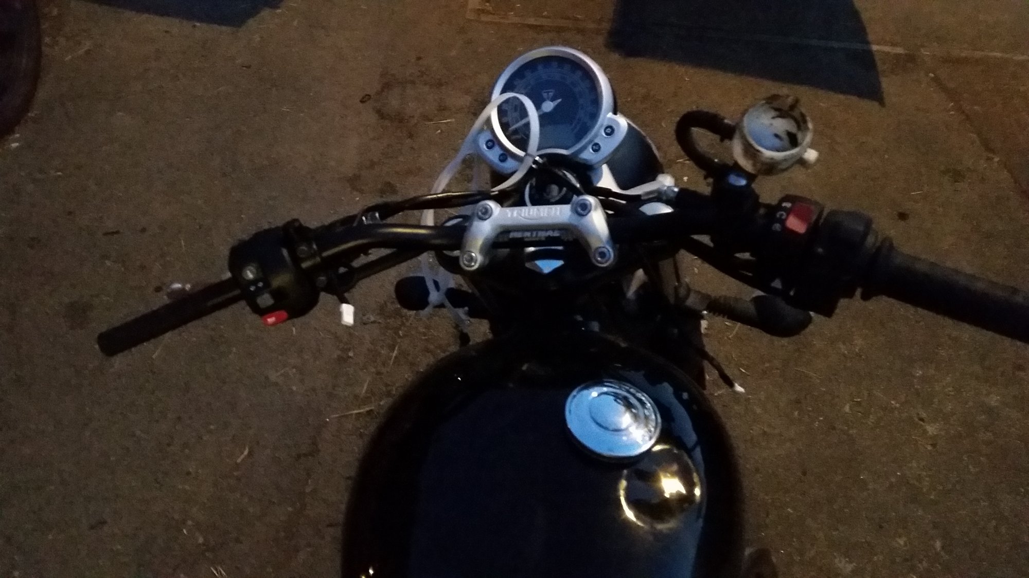

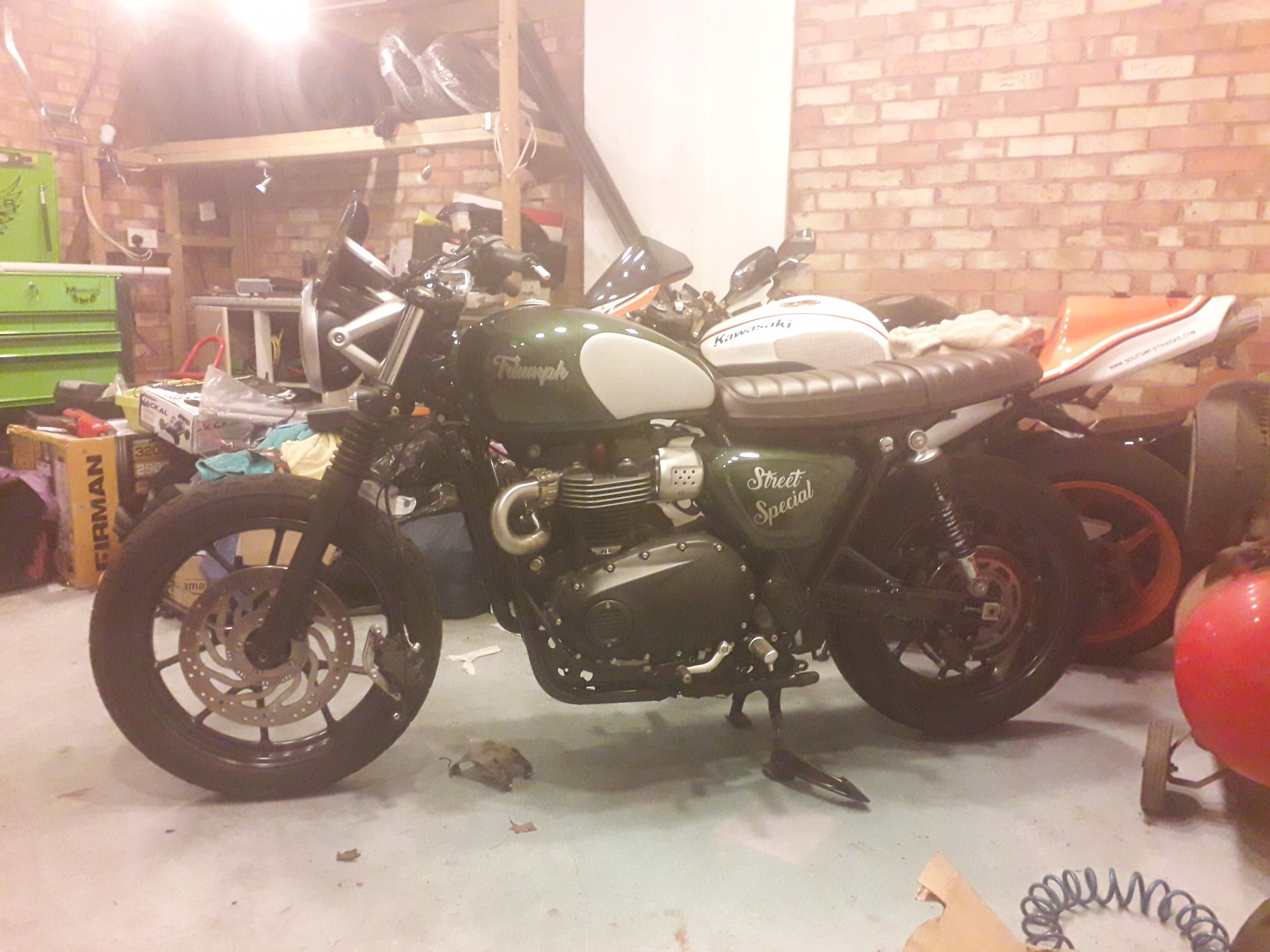

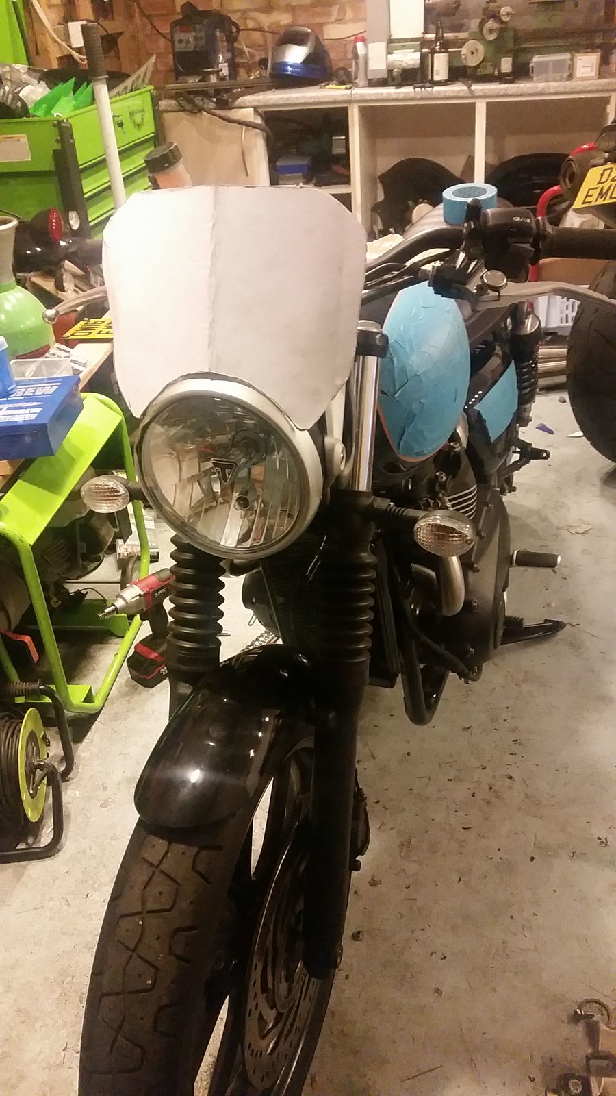

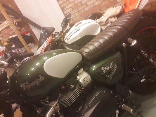

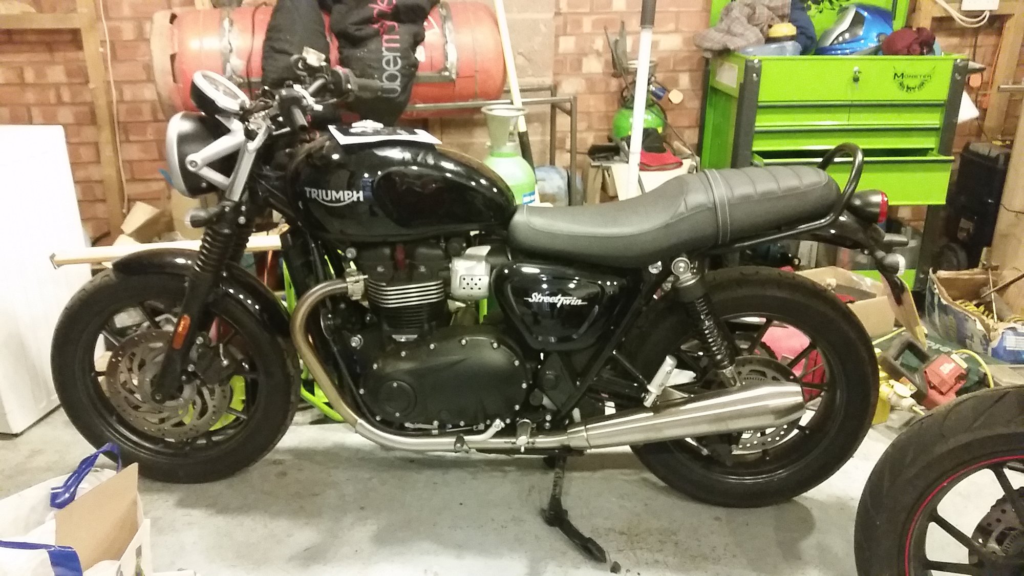

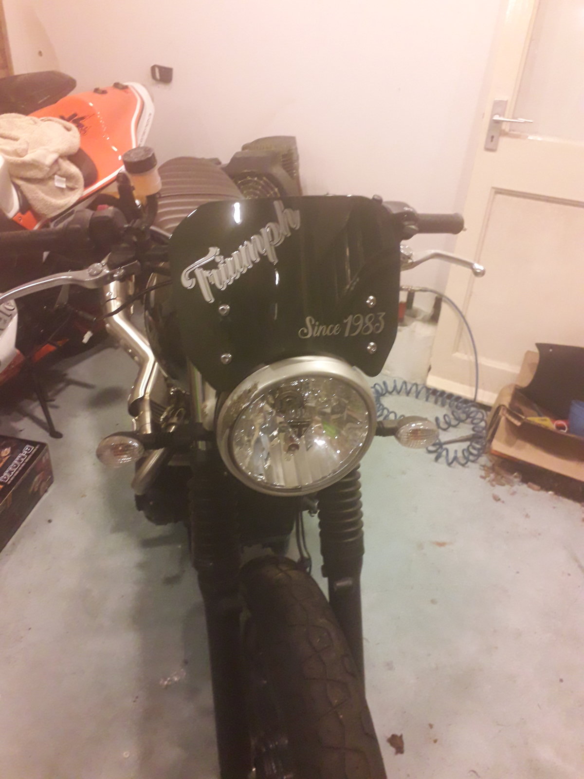

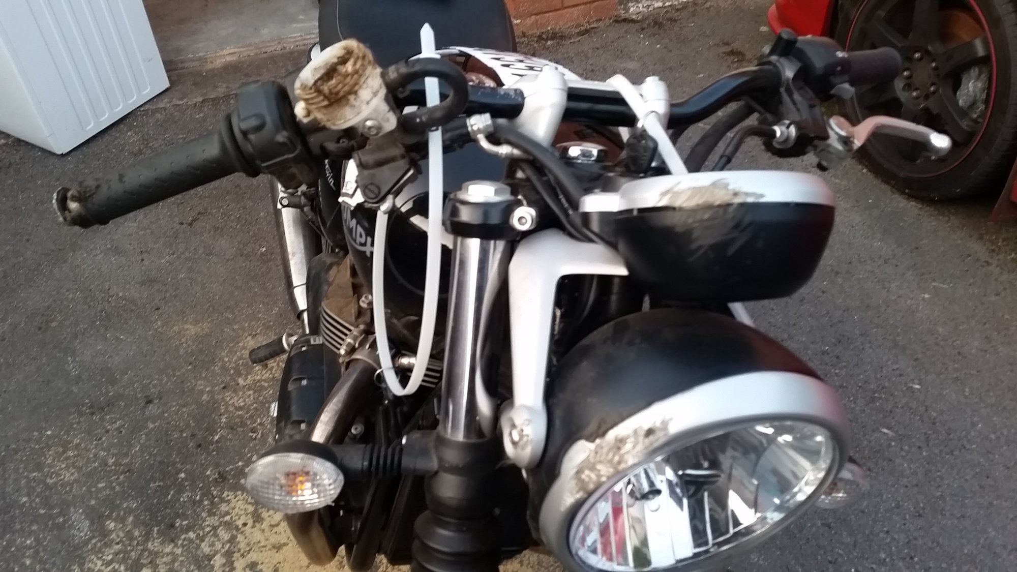

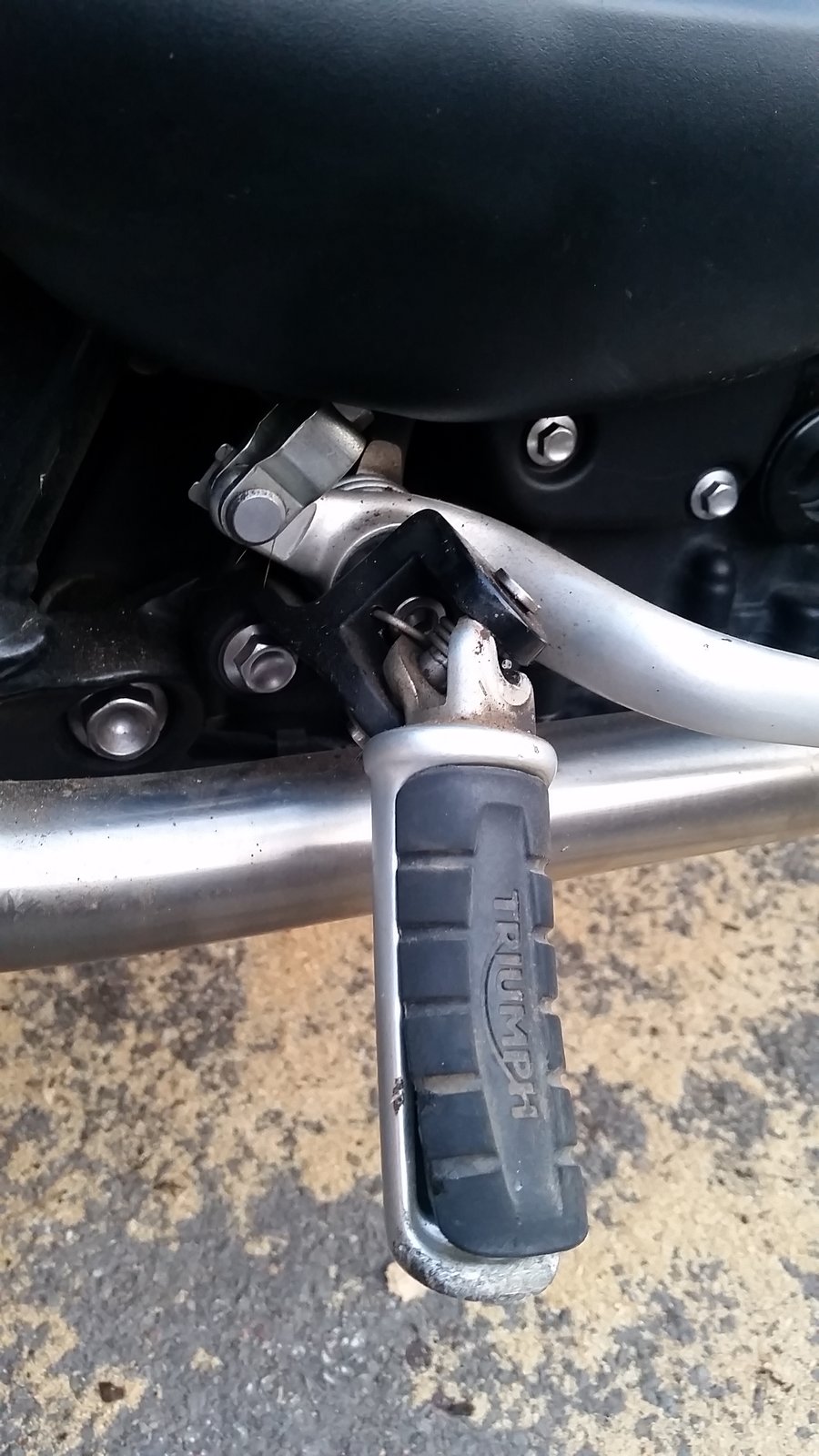

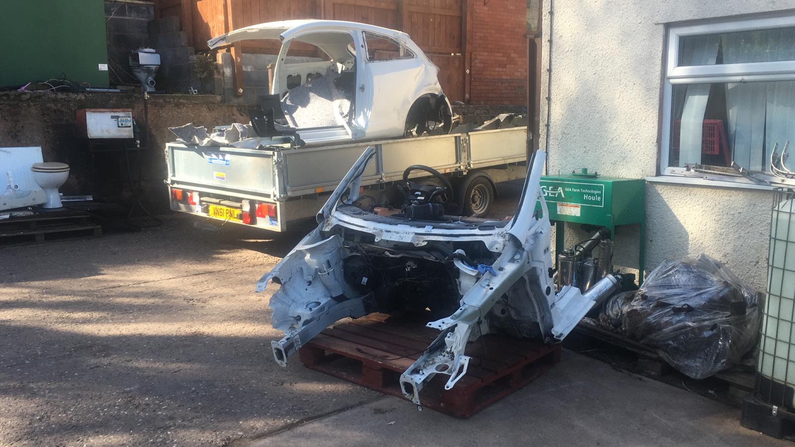

So not so much a welding job but thought some people would like to see it.

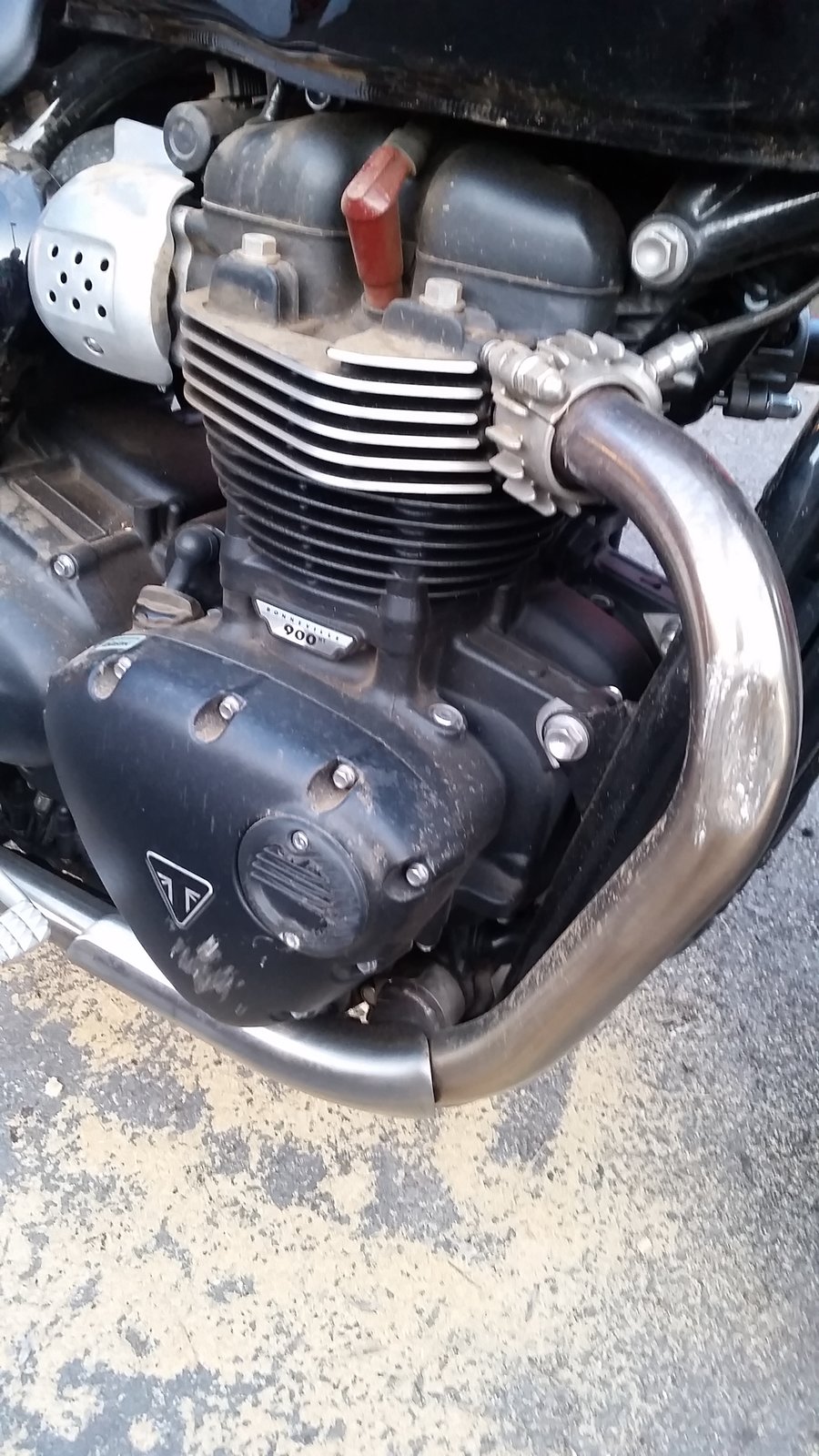

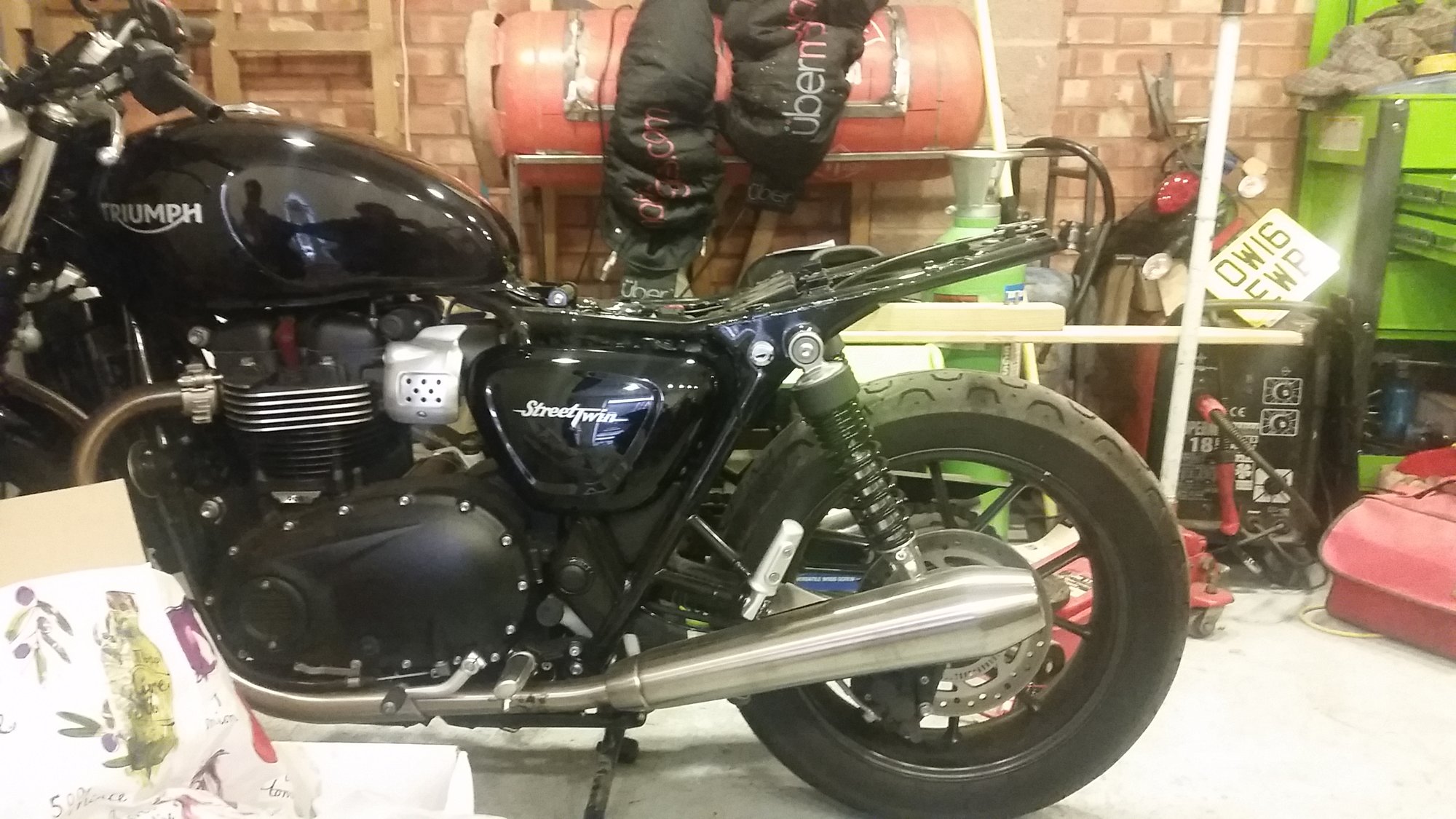

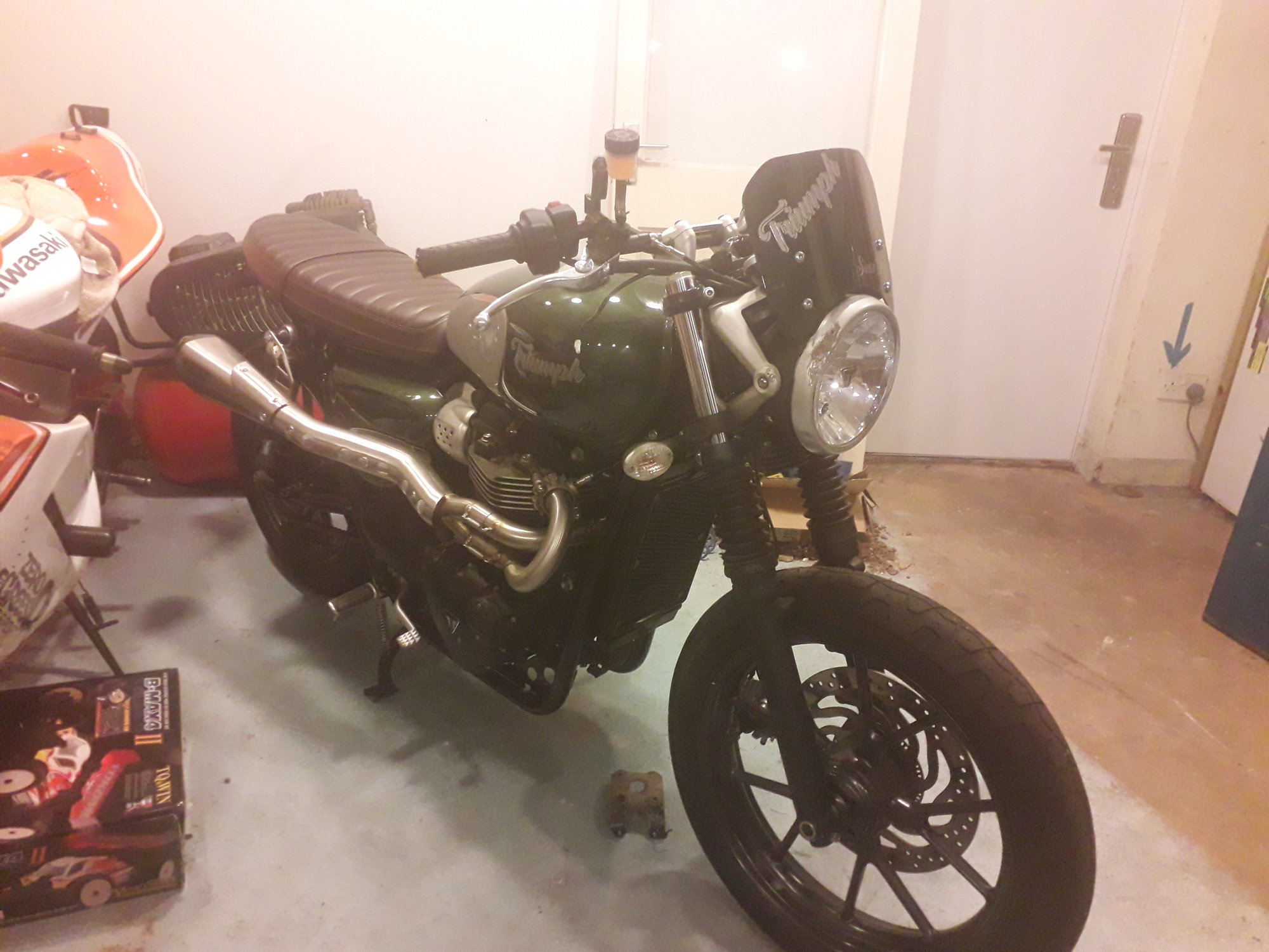

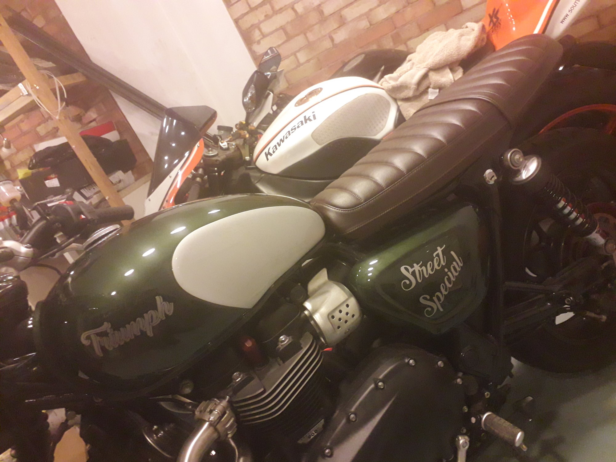

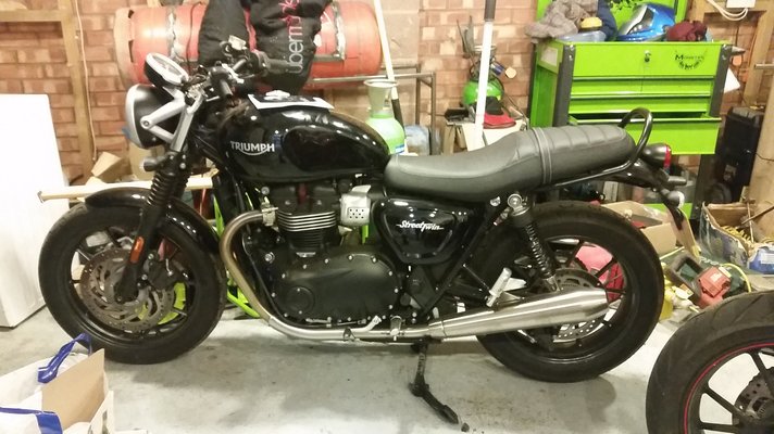

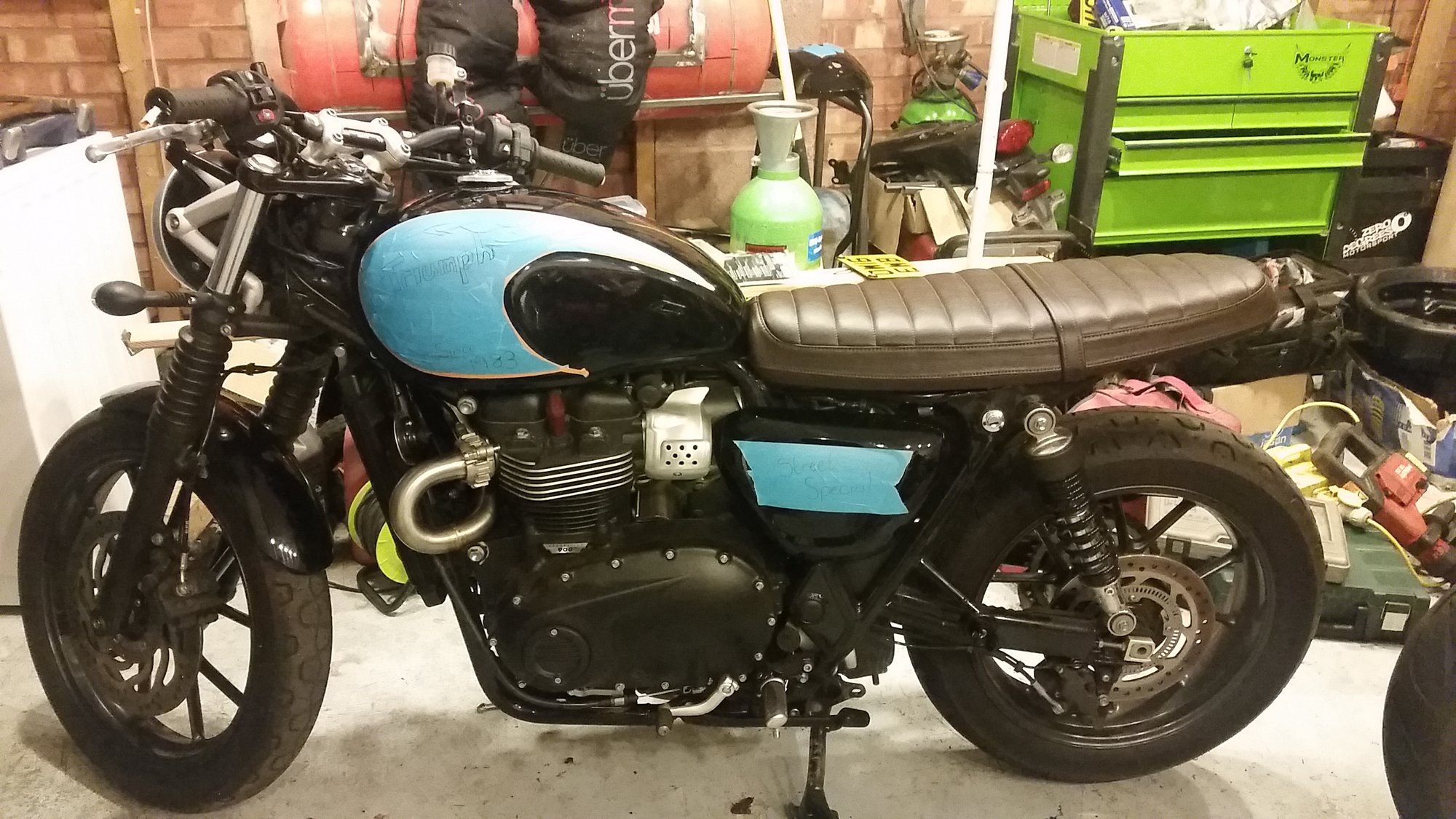

2016 street twin, 3k miles on the clock.
Cat n write off but picked it up for about 35% of retail price. I already had a few plans for it as soon as seeing it.
So repairs to get it back on the road, replace handlebars and peg, and then got carried away with removing stuff. And more stuff. And then thought I think scrambler/flattracker would be a bit better. So got the vance and hines high exhaust and flat seat also, just awaiting the rear light to turn up to finalise the tail tidy and then strip for paint.
