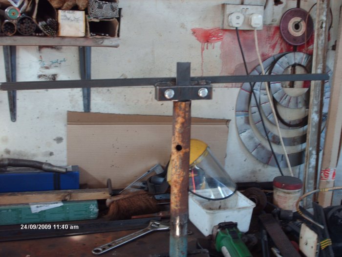

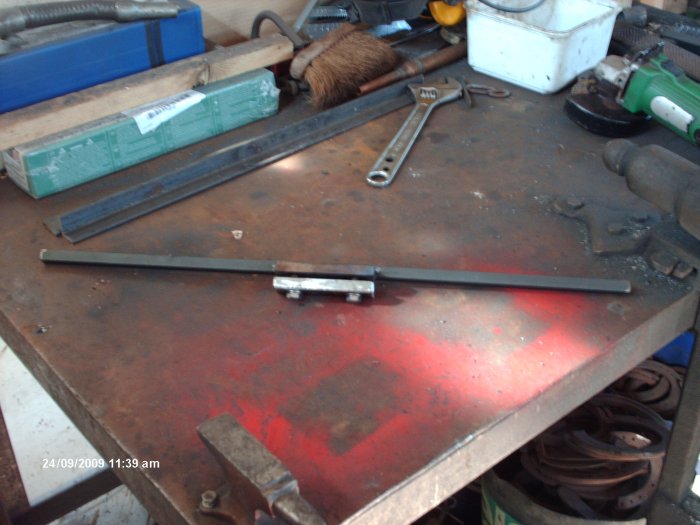

I knocked up a wrench to twist various flat bars this morning, had always used adjustable spanner before but since being supplied bright flat bar rather than black as usual I found hauling it round with a 12" adjustable a bit difficult not to mention dangerous, with the spanner at about face height and a 1/4 turn rebound on the spanner I could just see it twatting me round the head if i lost my grip.

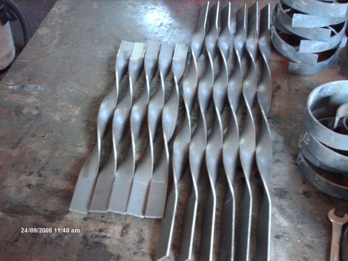

So pics below 1. the tool, 2 the tool and pipe (flat inside pipe), 3 finished twists.
