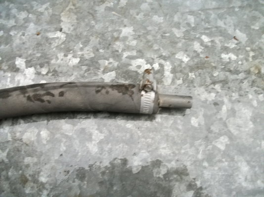

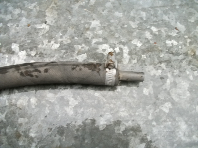

same here keep it simple. its a workhorse not a showpiece.If it's for your Ebay blast pot use one of these
http://www.blastitclean.co.uk/page9.html (3mm recommended)
Throw away the fancy fittings and fasten the nozzle straight into the end of the blast hose with a Jubilee clip.
Yes, I was about to contact them, their current price for Silicon Carbide was 1/2 what I was quoted last year from another supplier; when I was looking into things.You could contact Hodge Clemco - they do a complete range of industrial nozzles.
AFAIK everyone and his dog use the nozzles in my link above, they work perfectly well.
