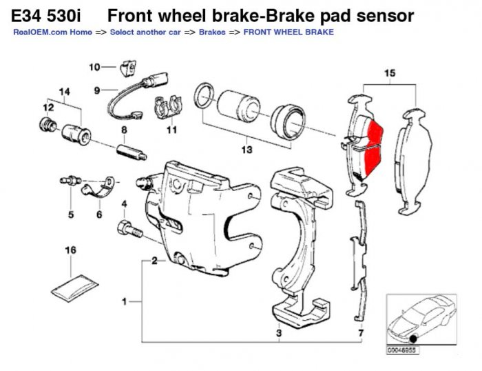

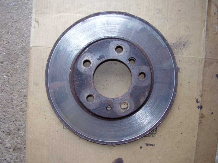

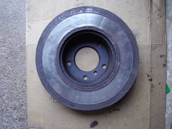

In the process of refurbishing the front brakes on a BMW E34 530i, new pads piston seals and rotors etc. With reference to the pictures, can any one give me a clue as to why this has happened to the old offside rotors? The front face is normal but the inside face (piston side) is not and the pads were nearly down to the metal, whereas the nearside pair (brake pad sensor side!) had a healthy amount left. Is it just a case of worn piston seals?
