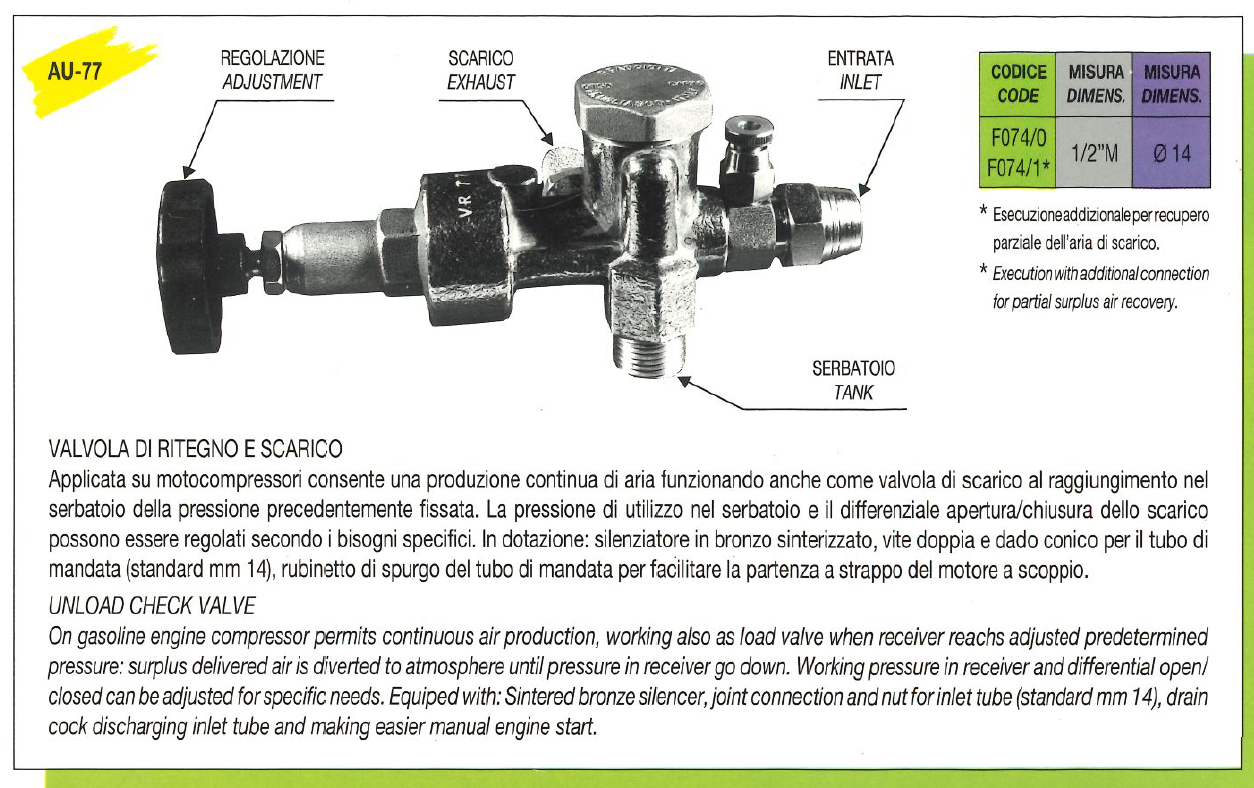

Hi,
I have a unloader valve that I’m going to install on a compressor I’m making, I am working away at present so am trying to source a few bits and pieces, the unloader valve is 1/2 bsp male to go into the tank, the other side is also male, I know it is a flared fitting, the od of the threads are 20.83/5 from memory and thread pitch is same as standard M12 bolt so is 1.75 and the flared seat (flared outwards) which is slightly smaller than od of threads is 45 degrees, does this thread size jump out at anyone as what it is, sorry I forgotten to take a few pictures but hopefully someone shall be able to tell Me the size of thread!
Kind regards,
Kev.
