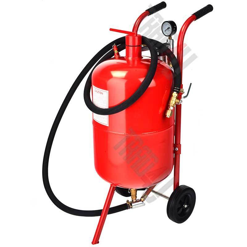

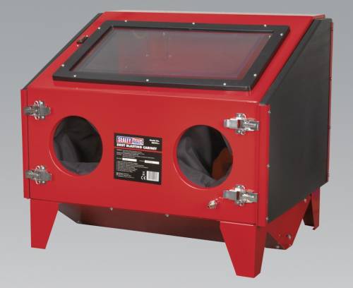

I have a blast cabinet with a suction style pickup and also have an ebay style blast pot (both pictured below), ideally I'd like to use the pot with the cabinet, is it realistically achievable and has anyone else done this? How would you guys recommended setting up the pipe work?
Have done this with a bigger pot & self made cabinet, put the control tap on the front face of cabinet, thing is to get the air & dust extracted so as to see, we made a cyclone
This site was a help http://www.jpthien.com/cy.htm
Then we did a cost analysis it was cheaper for us to farm it out than buy in media do job clean up
