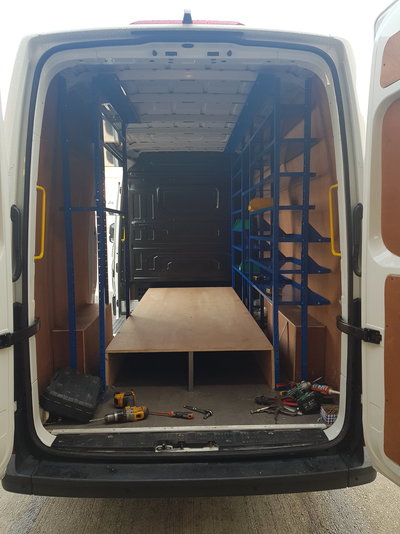

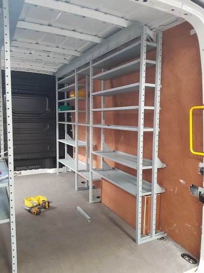

Tidy.
We need a fully loaded pic too.

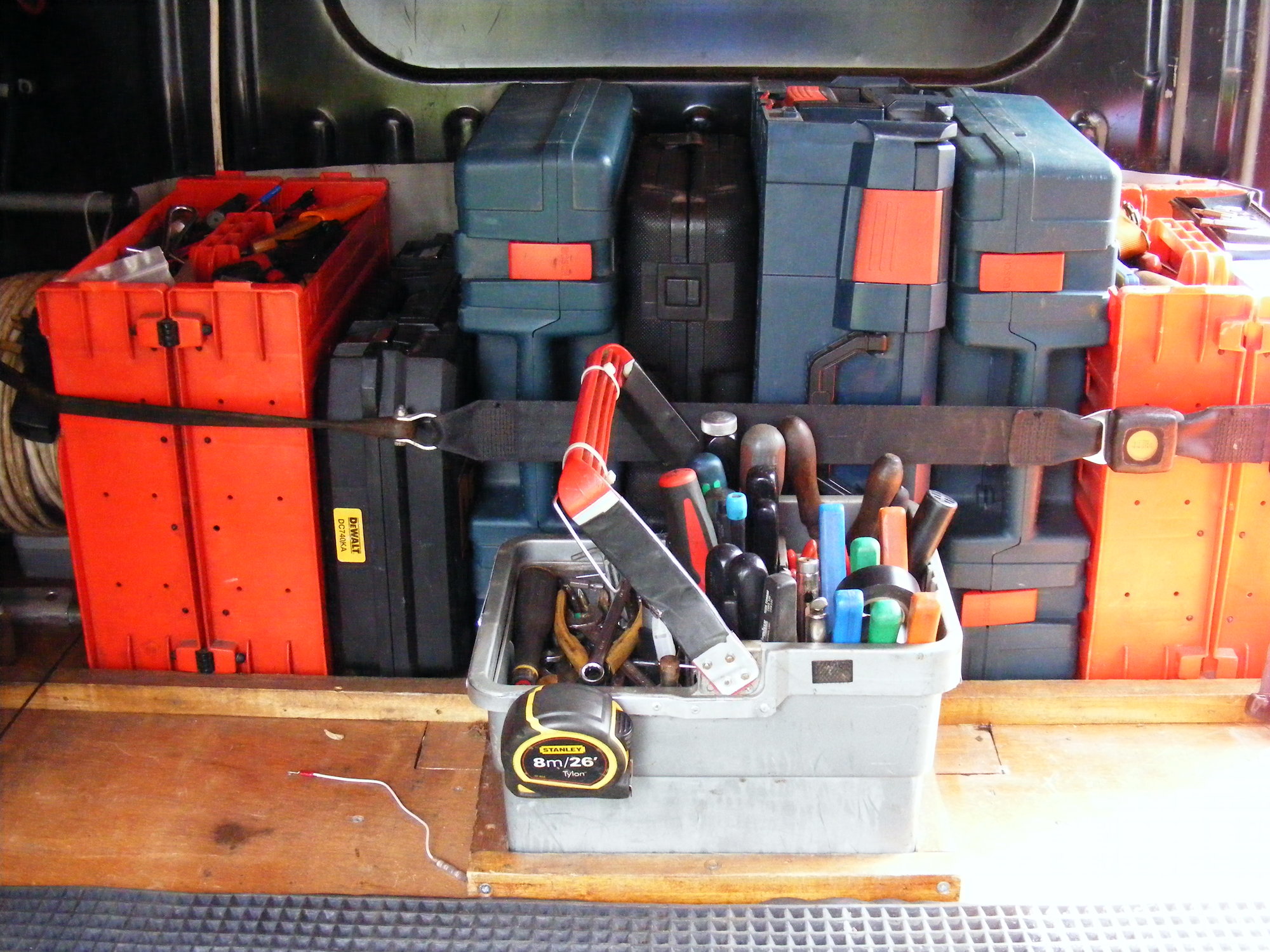

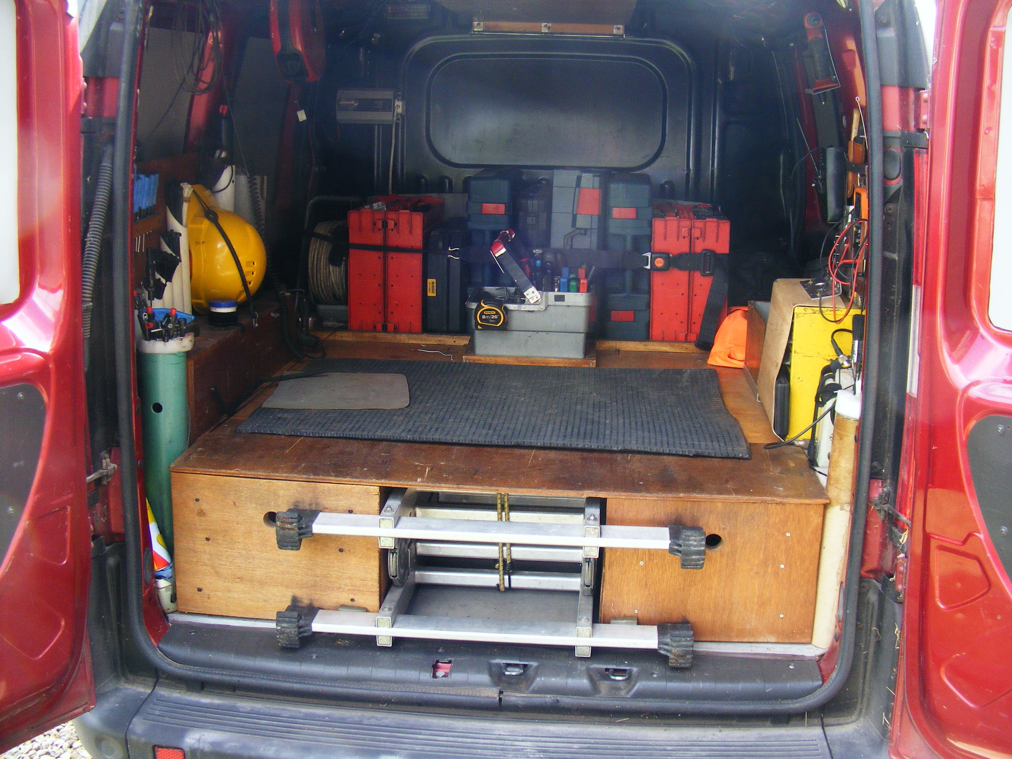

Gave up on racking.
No matter how much thought I out into it there's always something I want to change

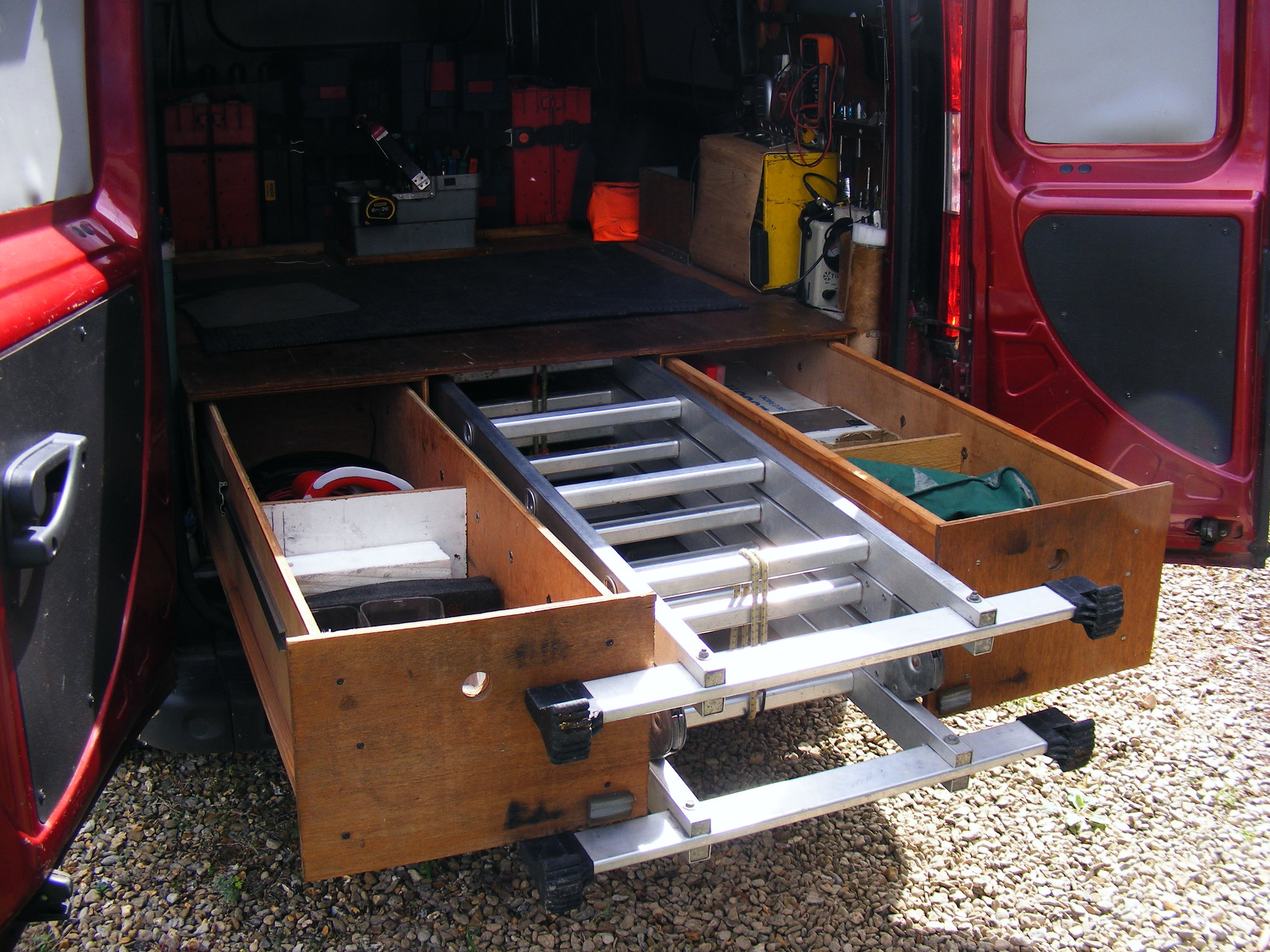

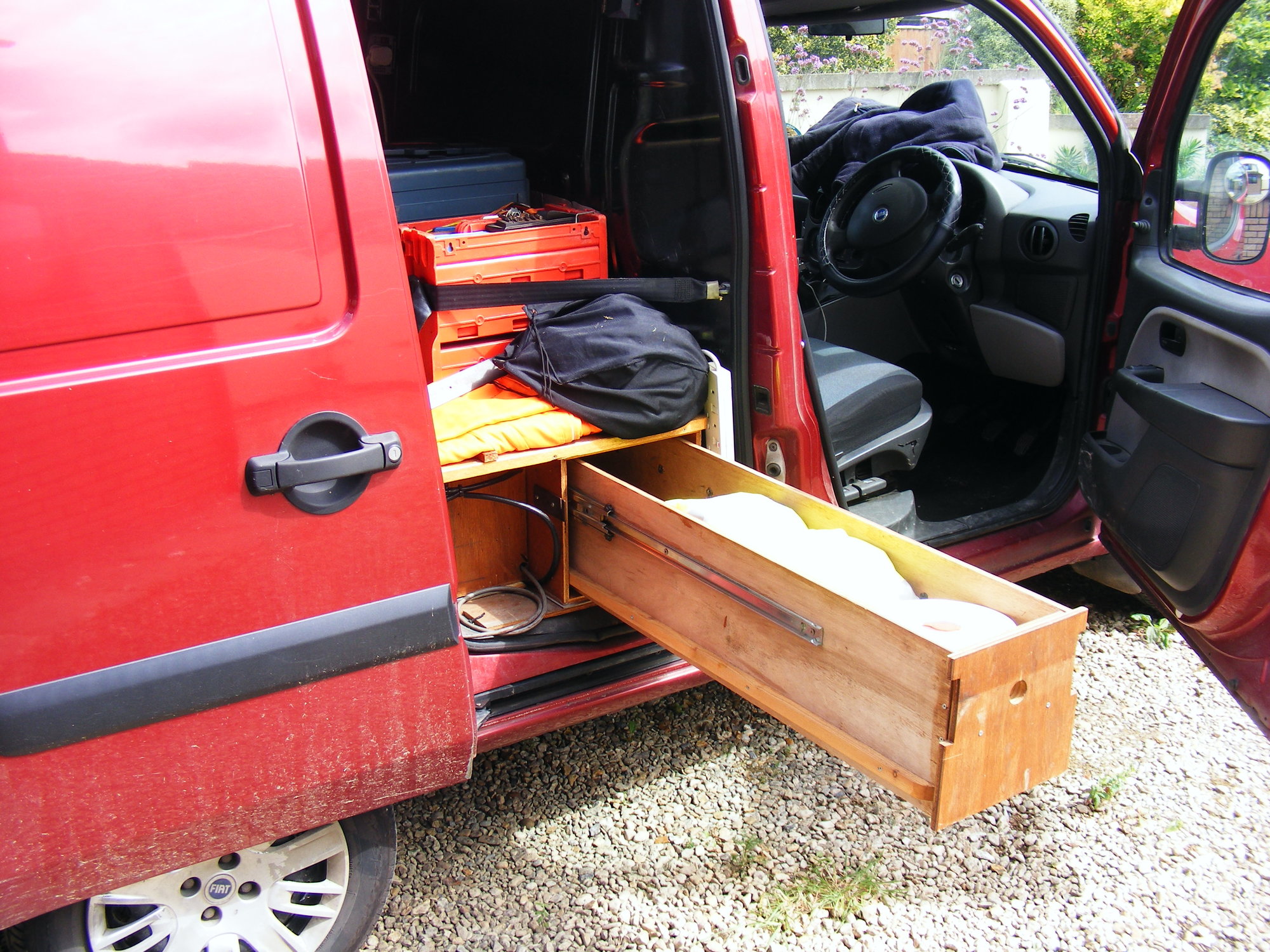

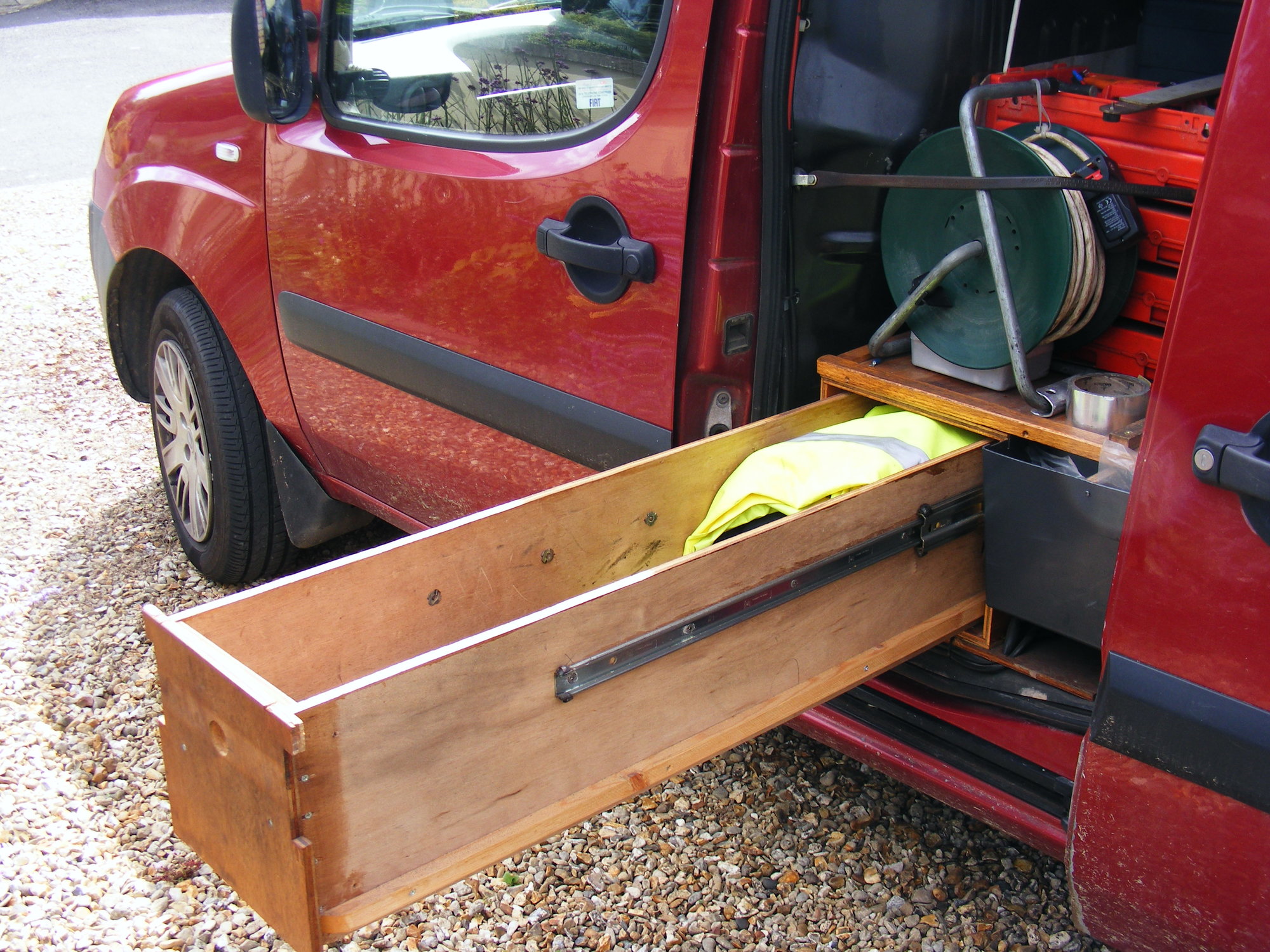

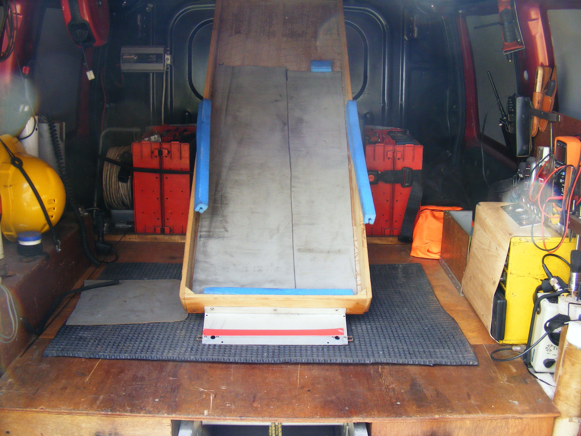

I just stack the Tstack and tough system boxes up and ratchet strap to the sides.I decides less is more, spaces for power tools, boxes of small stuff under the false floor and everything else stacked as I feel like it

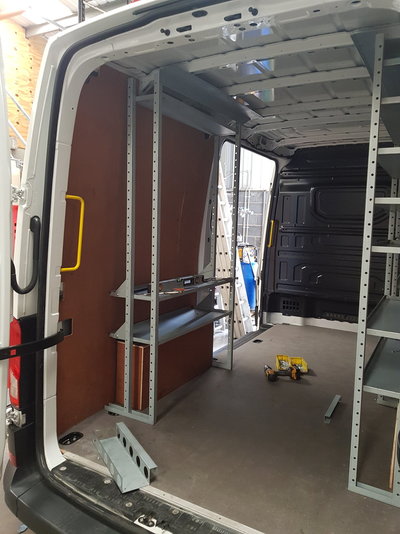

The shelves have an upstand front and back and one of the vans has been racked out for a couple of weeks with no problems
Always make my shelves 10 degrees slanted with a little lip. Had boxes up to the roof and never lost onetime will tell bungy straps come to mind
