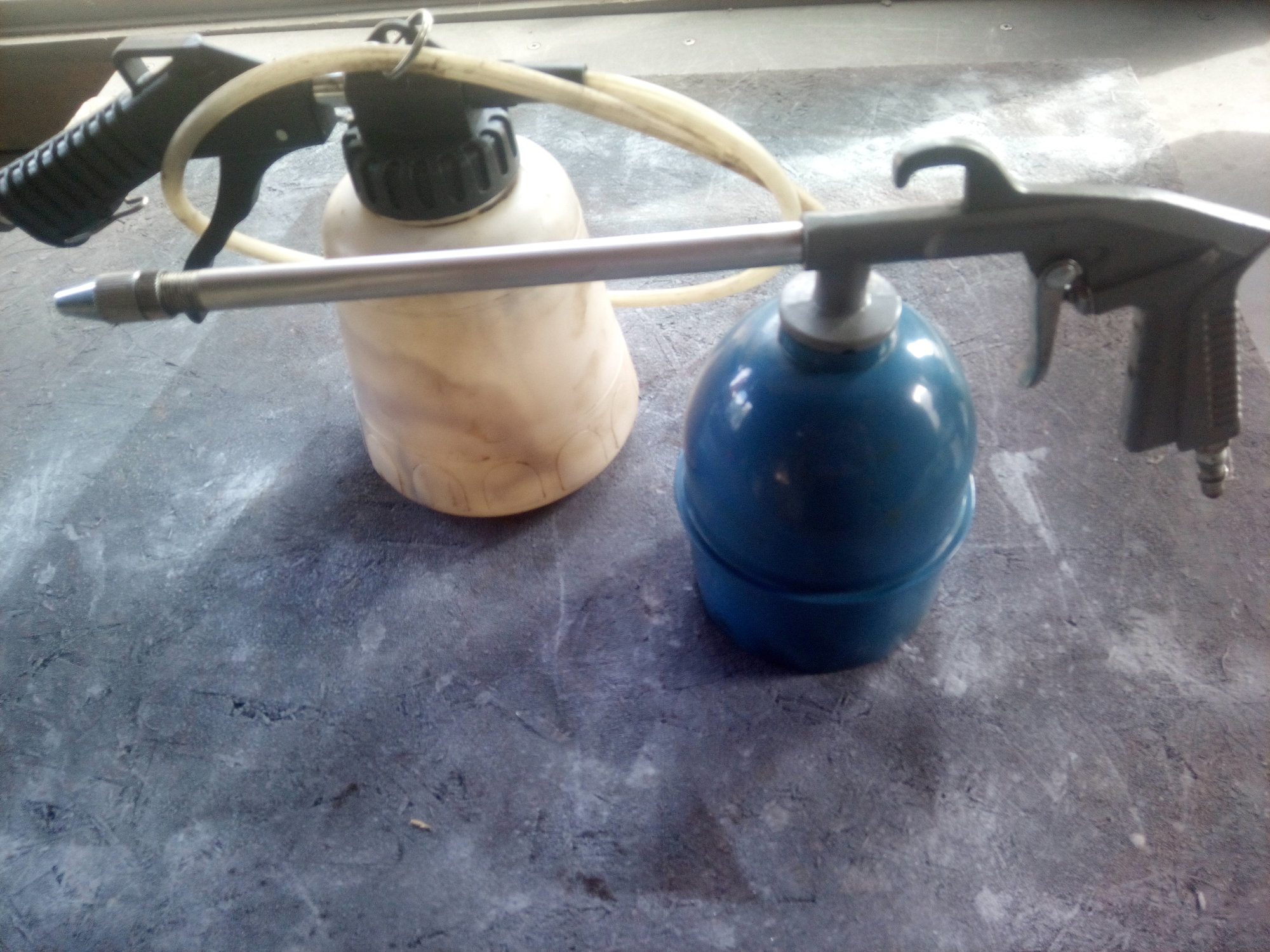

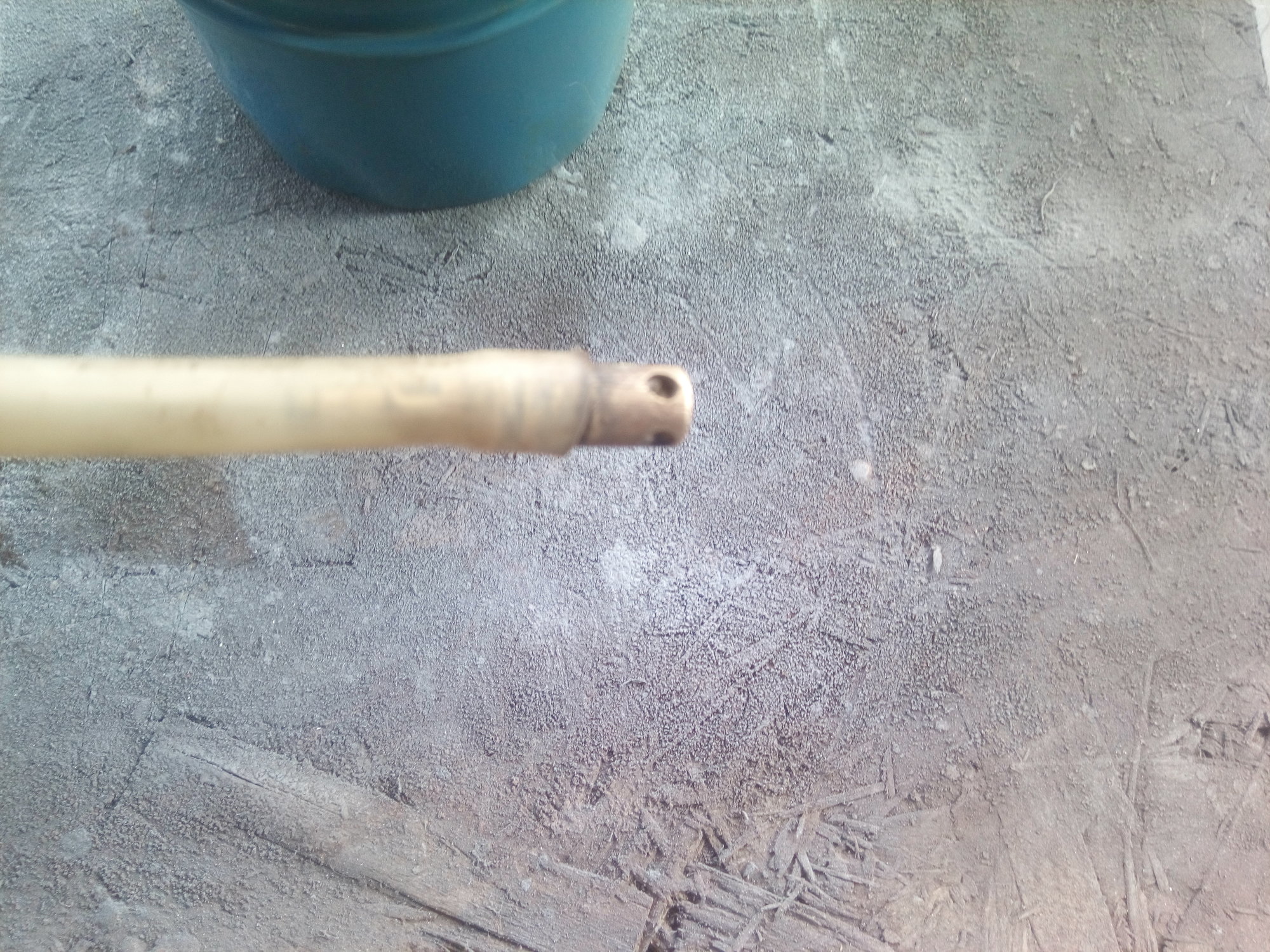

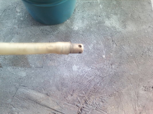

Just bought a Kennedy compressed air wax injection gun with a spray nozzle and an extension pipe for going in cavities, It useless with the injection pipe connected but it does works with just the nozzle. I have heated the wax to 65 degrees so it's runny and diluted it with white spirit but it still won't work.
It works with a Venturi effect and it's blowing air down the pickup into the tank as well as out of the pipe so the spray is useless.
I also tried the wax using a Shultz gun with its own extension with the same results.
I am running it at 120psi as recommended in the info and have also tried it at 90psi. I have lots of capacity with the compressor so this is not the problem. How do other people manage?

I will try slackening off the tube nut and see if that helps.
