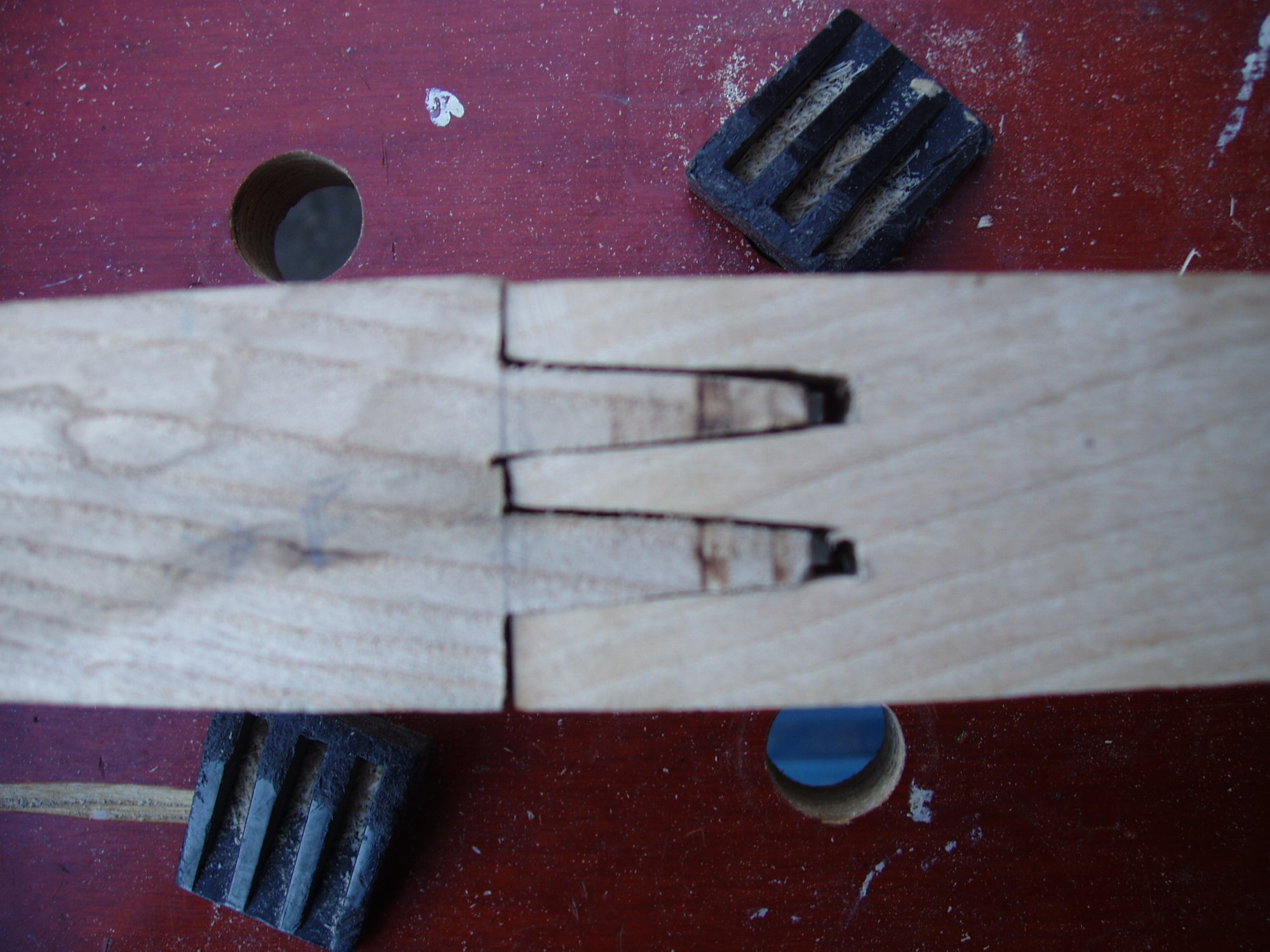

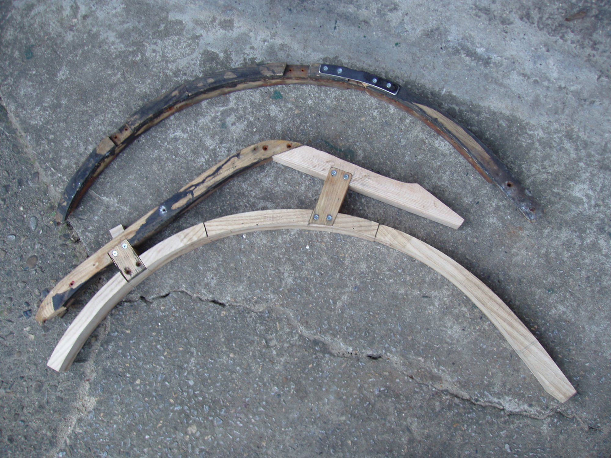

Bit of a misleading title but I am looking for a clamping solution or ideas.

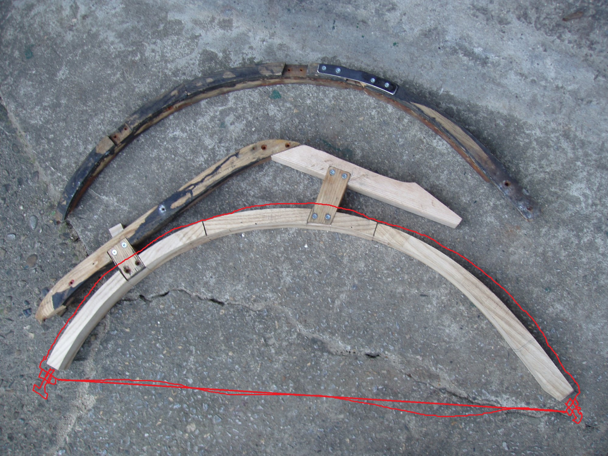

Problem revolves around the coach work I'm replacing on my post vintage sports car, specifically the rear wheel arches. The body is classic aluminium skin over ash framework.
I have fabricated new wooden wheel arches (see photo) which are in three pieces & they are joined together by finger joints (see photo). These will be glued together with prefere 4050 (previously known as Aerodux & allegedly used to glue WW2 mosquito airfcraft together) which is a two part adhesive with high strength combined with good water resistance/gap filling qualities. The joint will be then cross drilled & dowelled.
However I would like to pull the joints together as firmly as possible while the glue sets & therein lies the problem, how to pull the curved sections together, whilst maintaining the curve.
So far I have thought of putting screws either side of the joint & tightening binding wire round them while holding then on the old arch frames to keep the curve right.
Anybody any better ideas?
