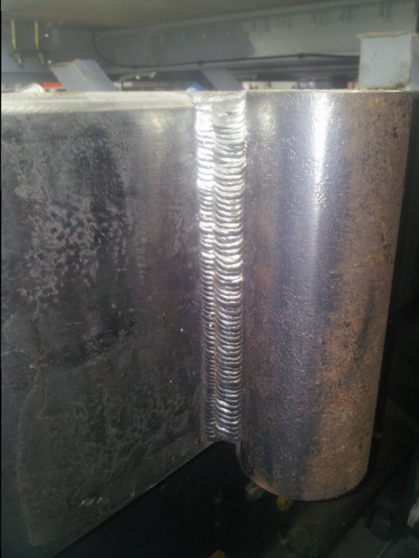

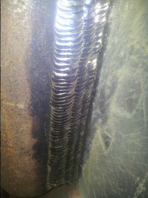

My thought process is if you produce a large weave their is more chance of undercut and slag inclusions . The problem we have here is we're all self taught and we havent got a weld inspector to pass the weld off .
Kent it isnt my business I'm employed was just looking to compare both weld procedures and the welds are put under stress the crane and bosses are tested at its lifting capacity plus 20% then locked off at 100% I have suggested putting a few of us through the codings . I've decided on looking into it abit more because I had to re-work some inadequate welds and noticed undercut on a large weave that was put on . Thanks for your reply.
