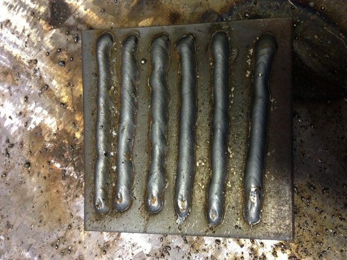

) Although the use of an etching solution is needed to get a proper look.if you chop one end off, and file it smooth, it will give some indication of weld profile and penetration (thats if you have a powered saw, because hand sawing a 6mm plate would be too much effort for the benefit got back)
Try a 3mm plate next time if you have one. and take a quick pic of the welder that you use and the settings.
your going in the right direction but all those welds are cold ....more amps needed
