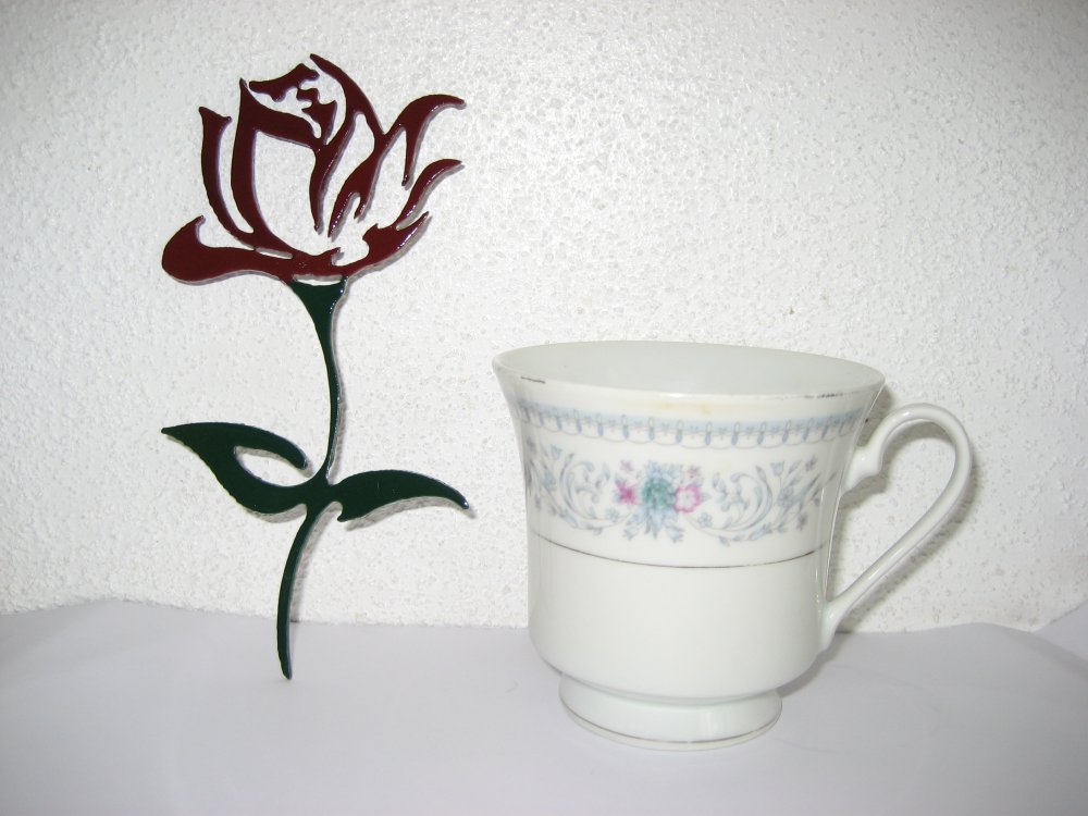

These two items were cut on my plasma CNC....posting them mainly to show how versatile the little Hypertherm 30 is.
The rose was cut from 1.5mm steel for a man who was making a little plaque for his recently deceased wife......the 'artistes' tea cup shown for scale..... ...it is very delicate and only 15cm high.

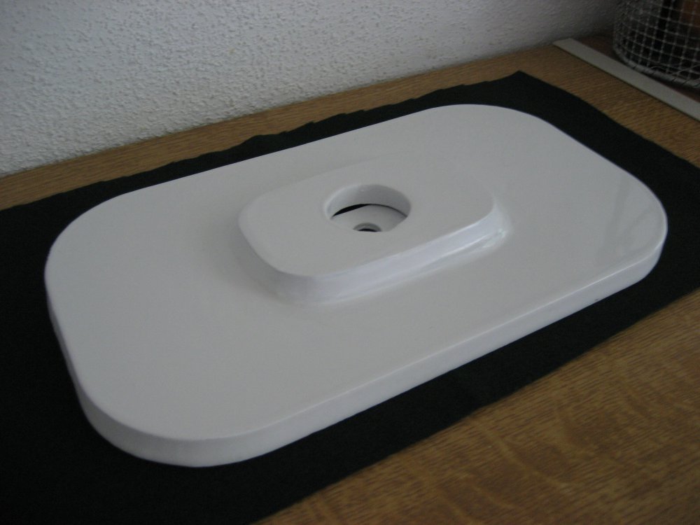

The other is a plinth I made for one of my larger sculptures....10mm steel cut with the 30 amp plasma..it was one solid piece and I cut out the middle and welded it back on top - that was fun welding 10mm with my 'smallish' mig welder! Although the little plasma struggled, and I had to run the CNC at only 200mm per minute, it did a fine cut on the 10mm.
