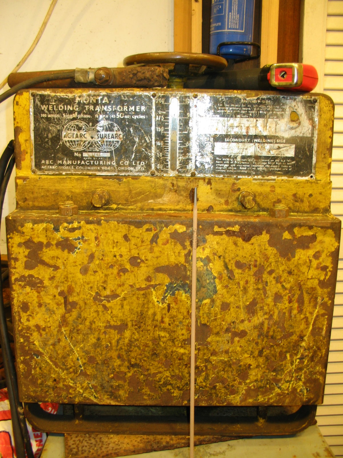

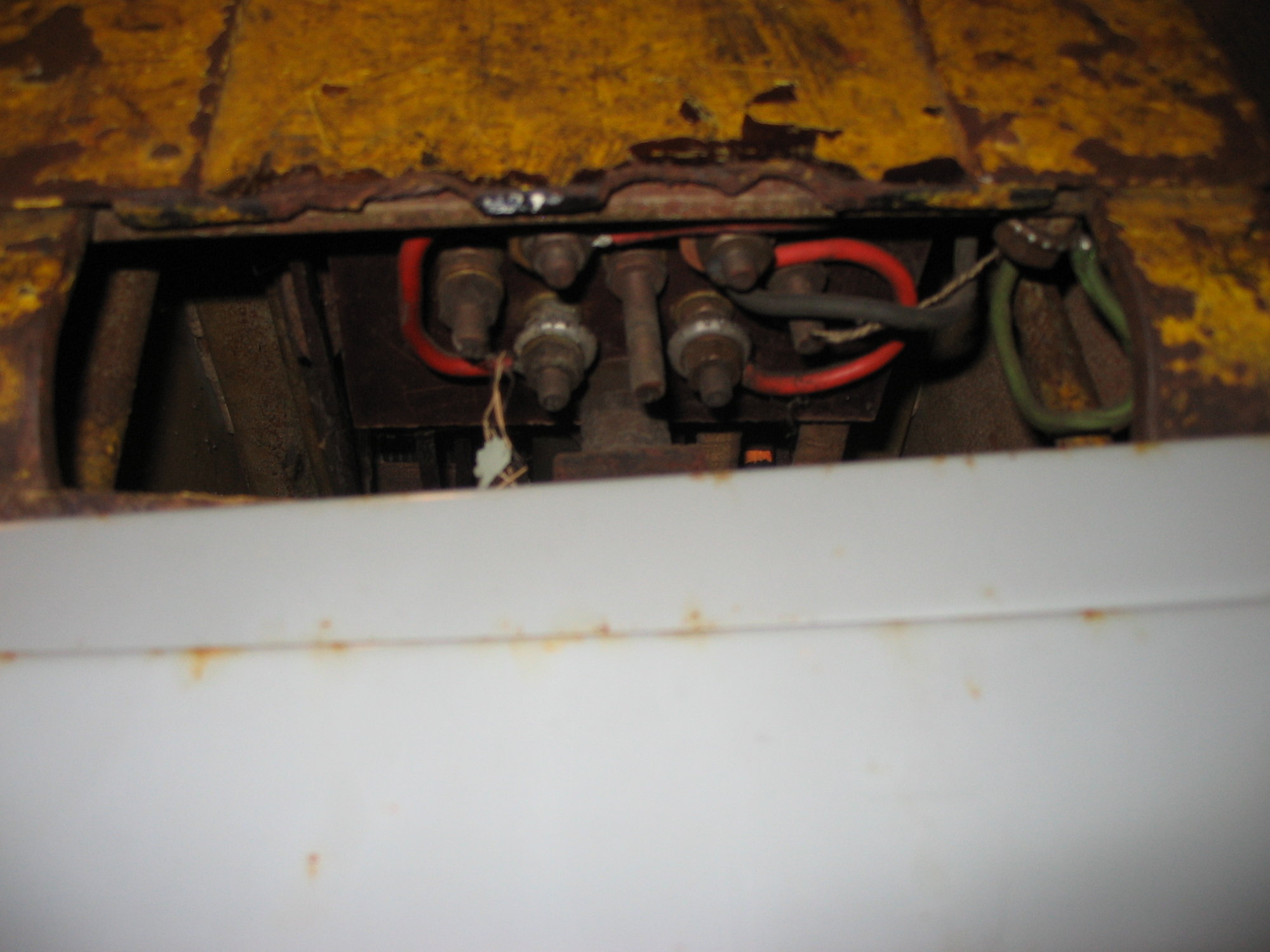

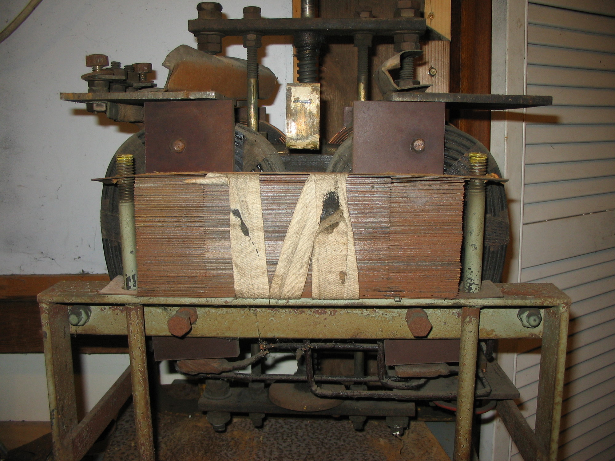

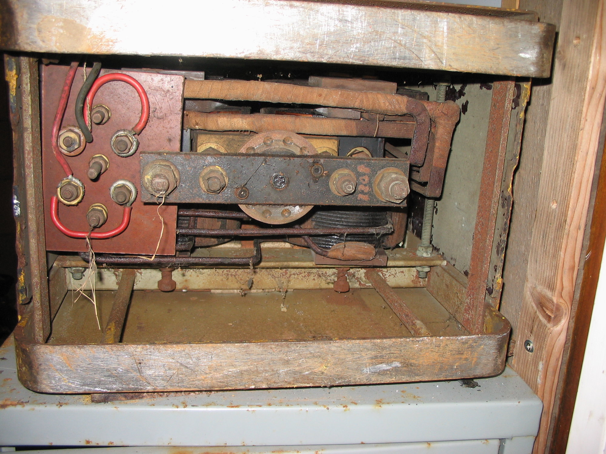

I have been given a Monta welding transformer with a tradename of actarc surearc made by arc manufacturing co ltd at actarc works goldhawk road london. This machine looks like it should be oil cooled but is air cooled with touchable mains input connectors with a 10kva yes 10 kva input for a 200 amp max output. My questions are is it a museum piece or useable but very power hungry and is it safe as if you try and lift it from the bottom you will touch the mains input wiring and it seems it is from the 1940s ish so the transformer insulation looks a bit knackered.
Without some photo's though, we don't know whether the problems mentioned are sortable or not. The exposed connections could just be due to a missing cover, and the insulation could just be referring to some perished sleeving, for all we know currently.
