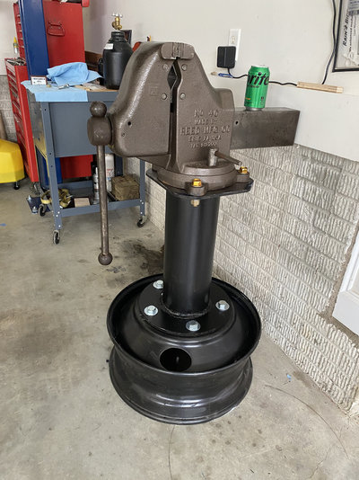

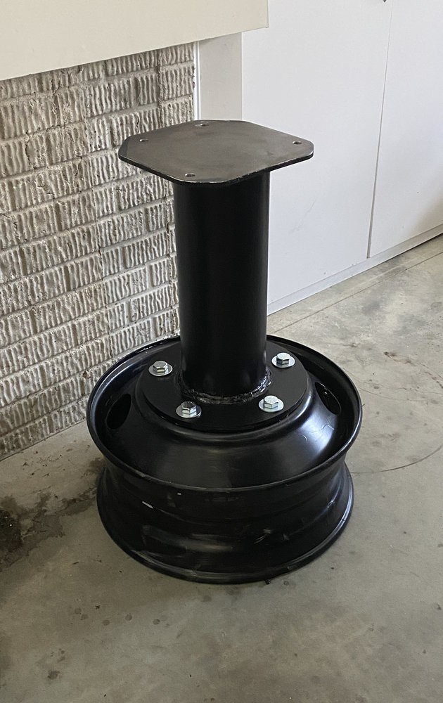

That's a good question. It would move fairly easily if I tried to bend a steel bar in it, or crank down on the handle with a long cheater bar. Fortunately, it won't with any work I foresee in my little home shop. If it ever becomes an issue, the obvious answer is to weld 3 or 4 tabs to the base and bolt them to the floor. The stand weighs about 160 lbs. The vise 185.Nice. Did you fill the rim with weight or is it heavy enough to hold itself still?
nice as long as you make a bracket to fit to the wall otherwise it will be all over the place using a hacksaw its bad enough on a bench if it isnt fastened to the wall or screwed to the ground

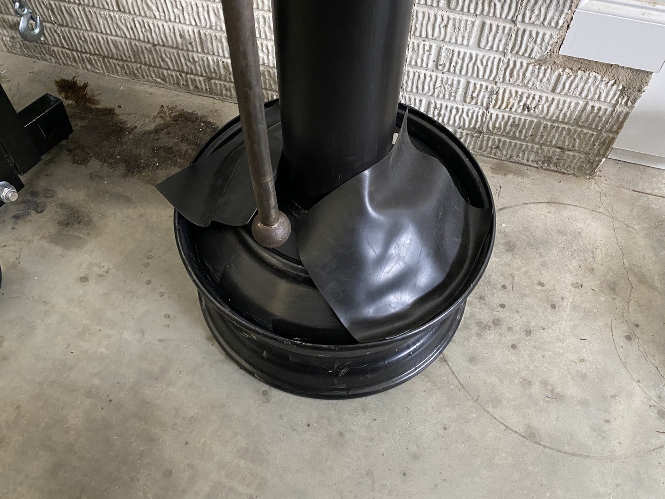

To the OP: it might be worth blocking the holes in the rim as they will attract every small object from above and you will have to lean it over to retrieve them.
Depends what I am cutting 24 teeth per inch general some times less if its the 4x4 and something needs off quickWhat tooth pitch blade do you use in the hacksaw?
