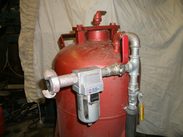

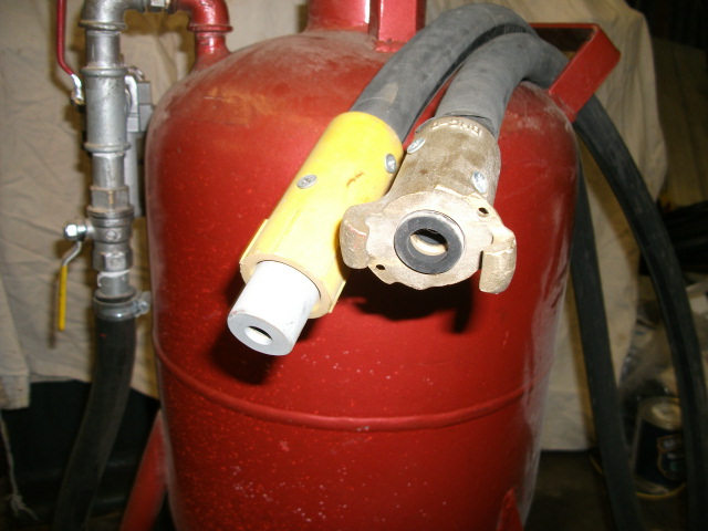

Evening gents, been outside all day playing with my sand blaster, Im blasting the underside of my campervan shell that ive rolled over on its side, I built a blast pot from a propane bottle and ive got a clemco 6mm nozzle/ blast hose and the compressor is a road compressor that ive borrowed from my mate, all was going well untill the media (small crushed glass) started clogging in the outlet of the pot. I dont have a water trap on it ! obviously this is my problem but can i use one of my water traps from my normal compressor setup or is something larger needed for 100cfm +?, the plumbing on the pot is 3/4" iron and im sure the outlets/inlets on the traps are 1/2".
Out of desperasion i joined another air feed hose that i left coiled up and submerged it in water to try and cool the air but now thinking about it the air already had the water in it when it was compressed so i think i should get the muppet award !!
