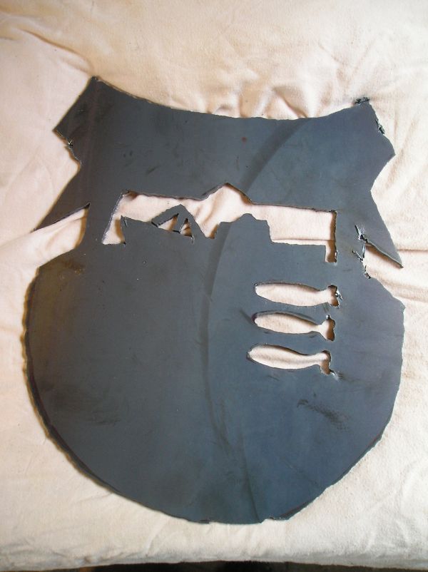

I found the badge on the internet and used Irfanview to print it out about five inches wide, ie, it fits on an A4 sheet. We discussed making and using a pantograph a few weeks ago and I used mine to double the size of the drawing. Then I cut around the outside and cut out parts like the trawler and the three fish. After transferring this to the 3mm plate I cut it out and with a bit of filing it was OK.

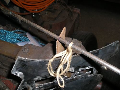

Balance was set by tying a piece of string to the badge and while balancing the centre point of the arrow on a bit of 3mm off-cut sticking up in the vice, I slid the string along the shaft until it balanced and I marked the shaft at that point.

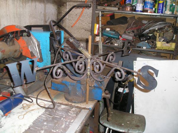

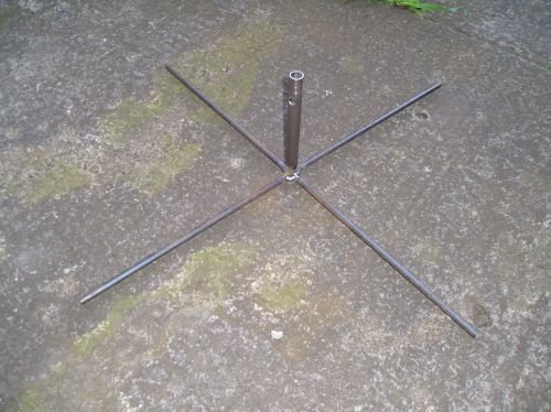

The direction pointers are each 1 foot long, welded to another piece of 5/8" tube. Don't forget the hole with a nut to take a locking bolt! I strengthened the pointers with 8" scrolls and finished off with the 'NSEW', scrolls and letters were also bought from DC Iron.

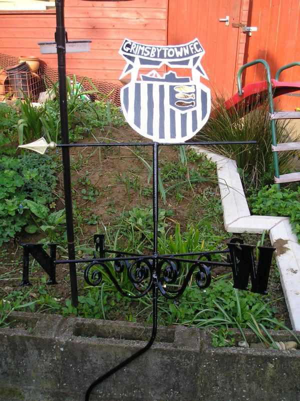

Painting this one is a bit tricky as it's black and white stripes with white lettering and edging and I'm not much of an artist. Doing one side at a time, I painted the black bits first. Bobbie (the wife) bought me a set of artists brushes for a couple of quid and I set to on the writing. Screwed up the first attempt writing 'Grimby Town FC' but couldn't see what was wrong for some time afterwards!
Fortunately it hadn't dried when I noticed the missing 'S' so it was easy to clean it off with thinners and I tried again. These artists brushes are brilliant. They seem to hold masses of paint and I found I could follow a reasonably good line considering I've always been useless at this sort of thing!
