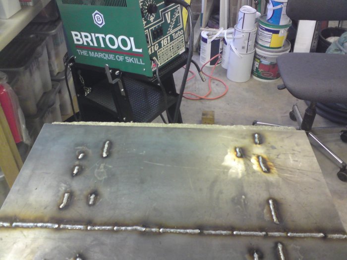

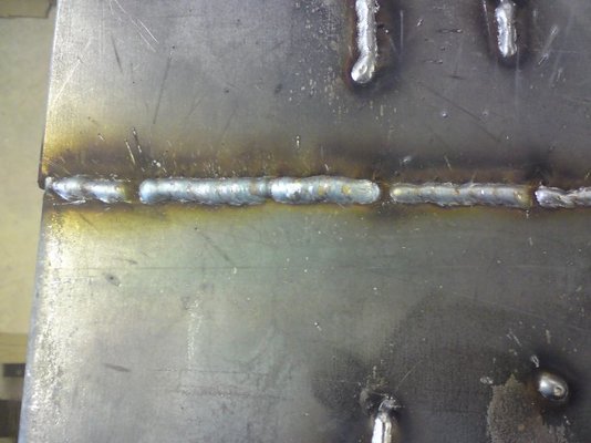

I have managed to aquire a couple of 8mm thick off cuts and want to join them to make a welding table/platform to fit on my black & decker workmate (set fire to the wooden top last year whilst practising).

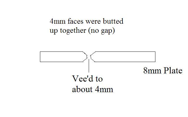

My Britool welder has a maximum output of 160 amps which i figure is good to weld upto about 5mm thick, so therefore i will have to put a V on the two 8mm joining edges
As i am still a newbie and dont want to ruin the 2 peices, do i i need to V the top and underneath and then weld the same
Thanks
Mark
