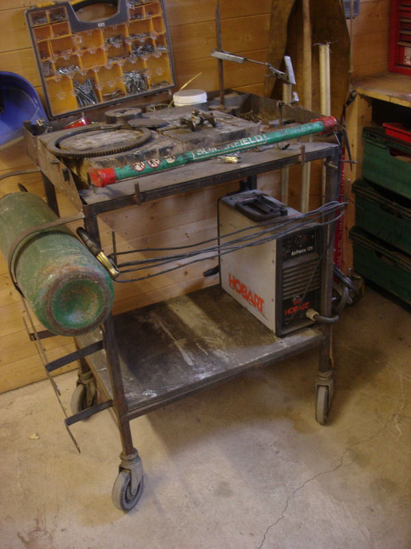

Finally, after months of saving, I finally order a load of stuff from IS&G, so now I can start my welding bench.
I bought a load of 50mm x2.5mm box for the frame and some 4mm sheet to sit on the wooden top.

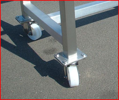

As its going to be a fairly heavy weight table by the end of it, I wanted to add braked castors so I can move it around. Slight problem with finding a castor with a 50mm square top plate, that can hold any kind of weight, so have to use one with a bigger plate.
What would be the best way to mount the castors:
Seam weld to the base of the leg
Seam to base, then add triangular pieces on either the corners (green triangle) or the midpoints along each side (red triangle)
Seam to base and then shaped plates on all four sides (blue shape)
