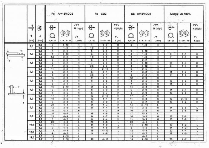

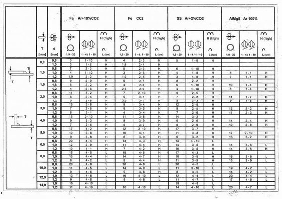

im glenn and im a newbie to welding so i thought i would jump straight in with a question. i have been given a sealey supermig 185 by a mate and im looking at getting started with some welding. i have been looking on the internet for one of the charts that some welders have in the lid. you know the ones, they tell you your ampage and wire speed for each size of plate. i cant find one anywhere!!!
