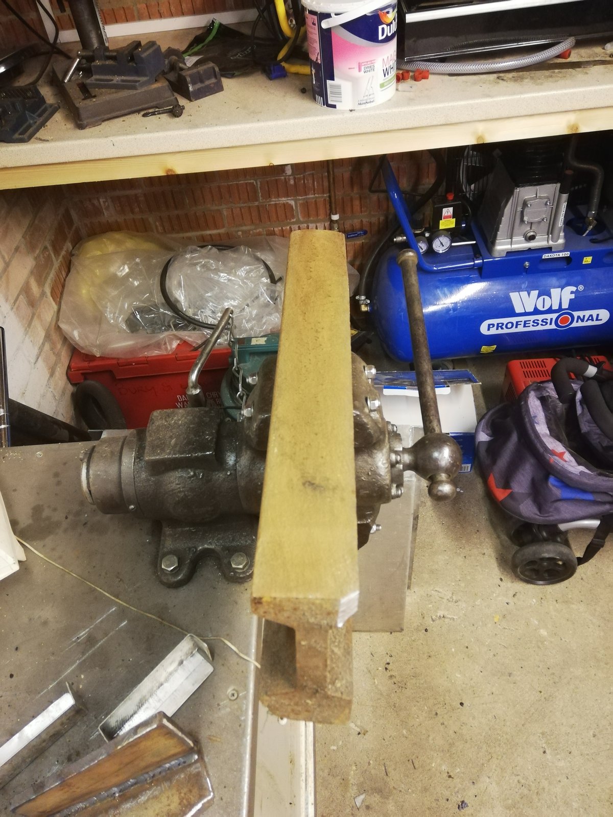

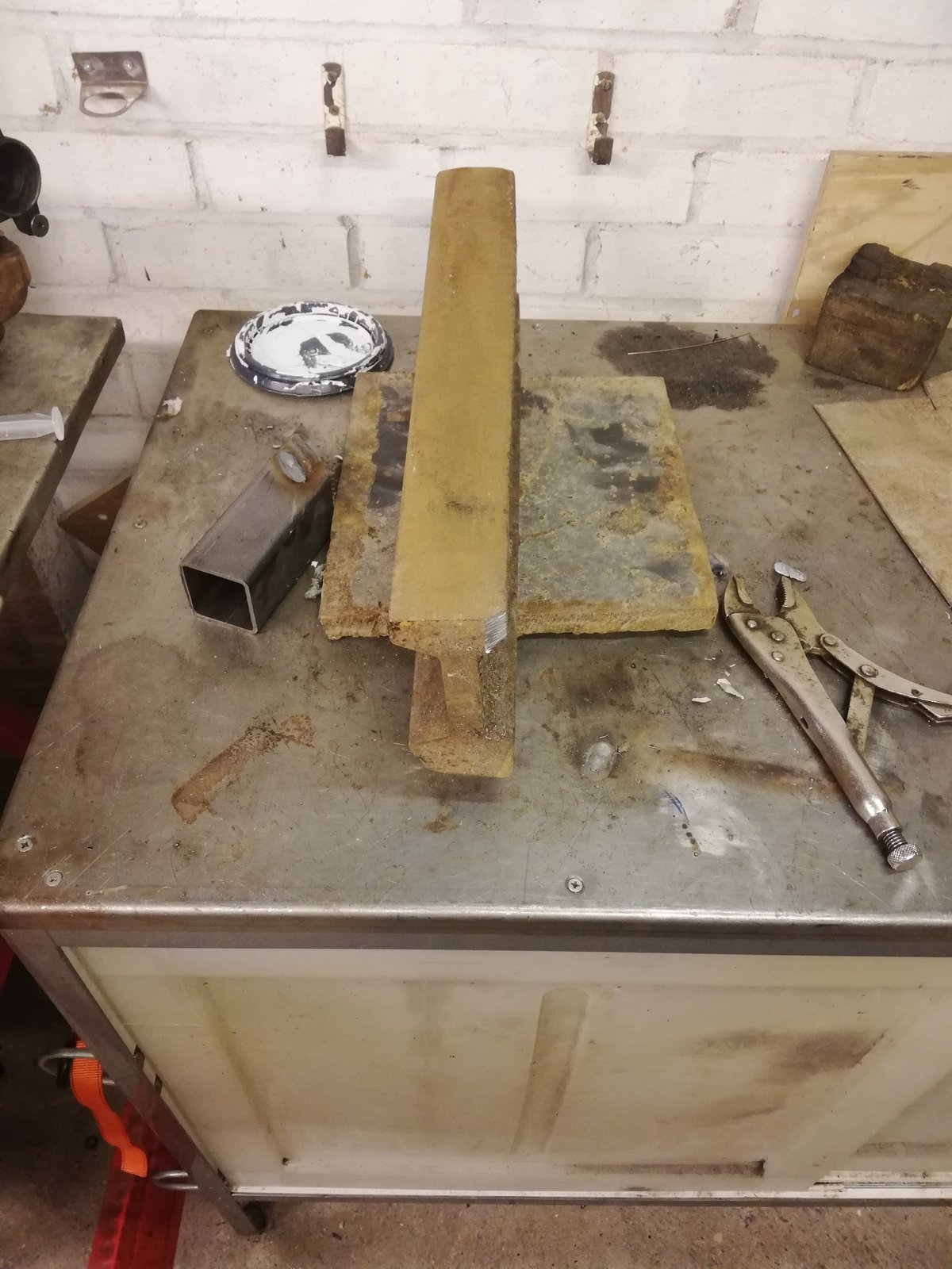

Depends entirely on what you’ve got.
Main line rail is a high carbon steel. A bit crack sensitive but a bit of pre heat and a few stitches should see it stuck down fine.
Crossing section rail is a high manganese stainless steel usually something like a 307 grade. In this case you’d probably be best using a stainless consumable 312 would be best but for slapping it on a bench your 316 would do. Again crack sensitive but to excess heat. Weld it as cool as possible.
High Mn rail was designed to work harden so if you’ve got a lump of that expect it to be very hard.

I’m gonna say cost but cannot be sure. Logically part of a crossing has a long tapered nose and long tapered switching blades. These areas are gonna be most vulnerable to wear so an expensive work hardening material makes sense. They are manufactured via a casting process and dropped into the line. Main line does wear and goes under regular repair but probably not to the same extreme as a crossing so expensive casting materials are probably not justified for miles and miles of mainline.Why do they use different materials for main line and crossing section?
Good job it's 312 i have, for some reasons I thought 316312 will be a good bet
Wheel burns from trains wheel spinning at start up are really all the main line suffers from but crossings take a real battering and those blades can get pretty thin.
Two totally different welding/cladding procedures for addressing them as well. Main line is 400°c preheat and maintain through welding hot.
Crossing is zero preheat with a 100°c max inter pass temp. Both can quite easily crack if the temp isn’t monitored properly.
