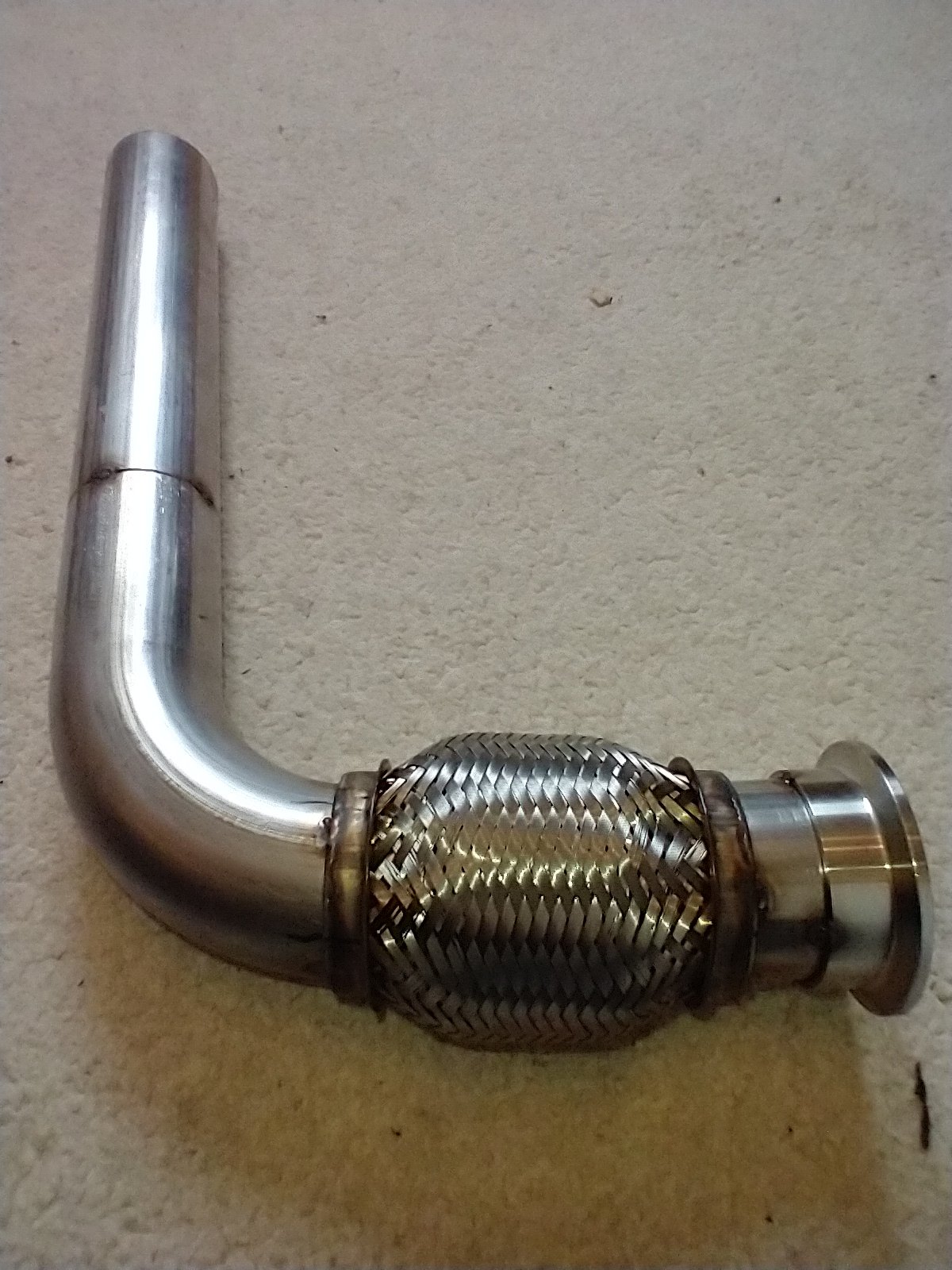

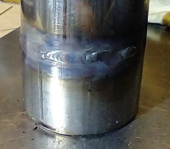

Hello, I’m about to embark on welding up a stainless steel exhaust system (304) for the first time and have a few concerns I would like your thoughts on.
I’ve opted to do down the Solar Flux route. I've bought this stuff. I’ve done this because I weld very slowly. I know this isn't ideal for SS, but will compensate with shorter stitches.

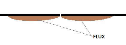

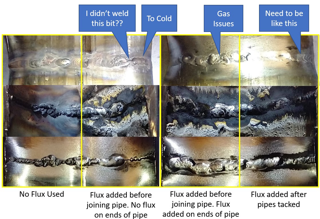

Butt Joints
Where I have a but joint, because I will have to apply the flux before tacking the pipe, will I not still have a gap where the weld is? Will it still work as intended? Or does the flux flow when heated to fill any gaps?

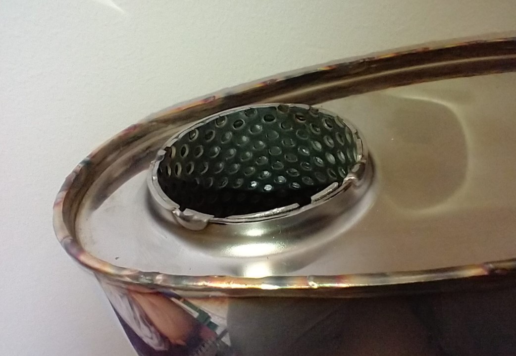

Lap Joints
When welding pipe to the silencer it’s effectively a lap joint with a perforated pipe sandwiched between the silencer skin and the pipe. I have no way of protecting this perforate pipe from oxidising. Is this just deemed acceptable?

Towards the end of the video he adds the hangers to the silencers. There is no way of using solar flux inside the silencer. How is this ok?
