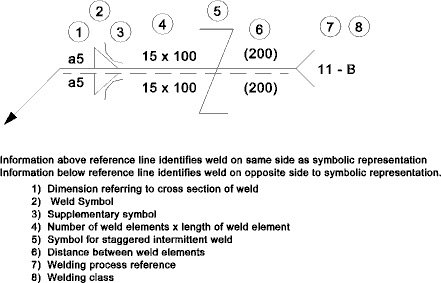

Here's something that might clear up some things:
(you either use system A, with the dashed lines, or system B, without those dashed lines. Doesn't matter, but you have to be consistent)
Richard, what standard/year does your extract comes from? Never seen drawings with references in the tail that don't say what kind of references they are.
Normally, there should be both the procedure or standard + the detail that the draftsman wants to emphasize, in the tail.
See attached screenshot, from the EN ISO 2553 : 2013
you see amongst others quality level C according to ISO 5817 in the open tail example
or a reference to a general note "A1" in the closed tail.
(like, "A1: all welds to be made in position PB")
