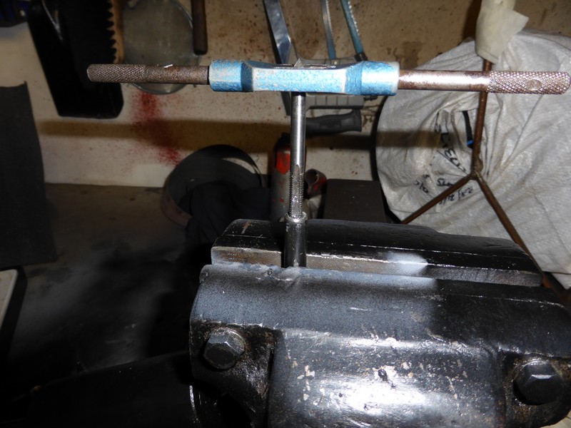

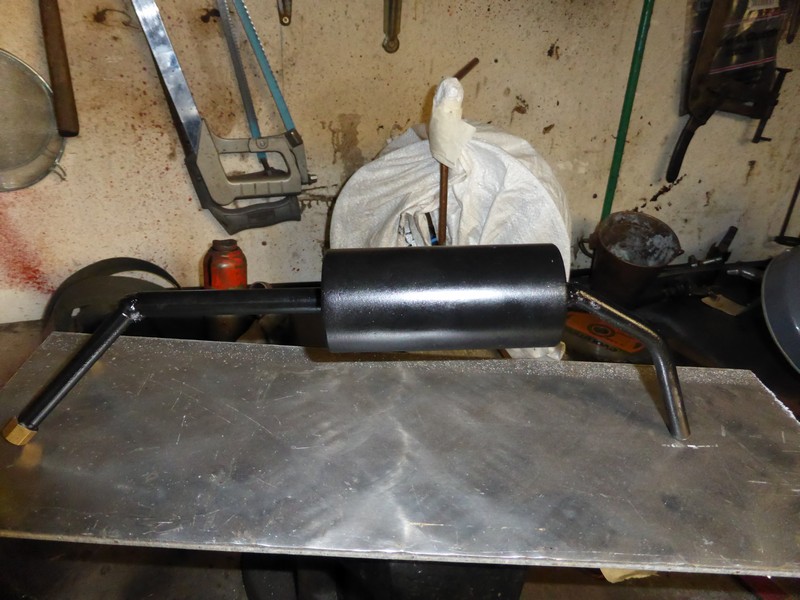

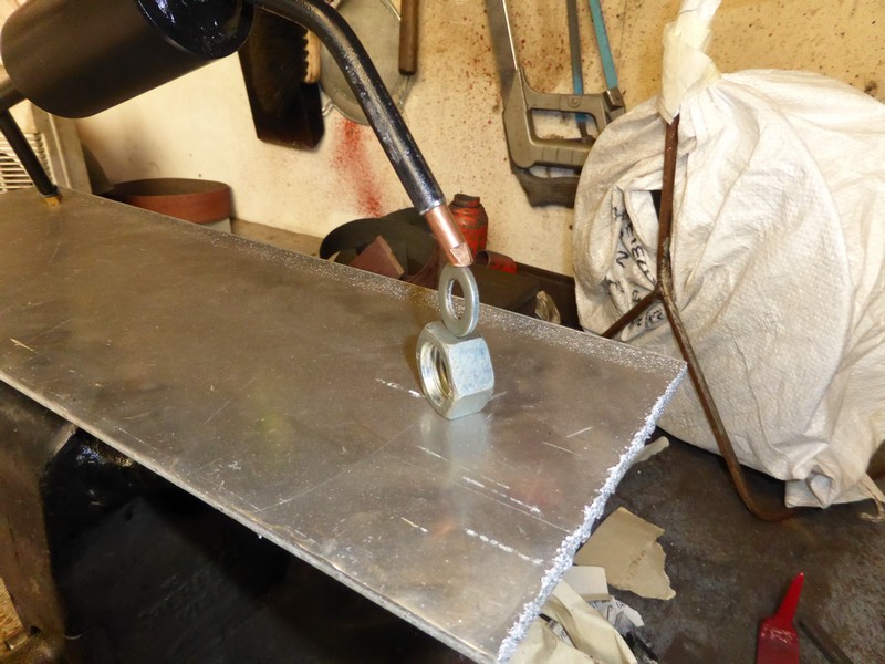

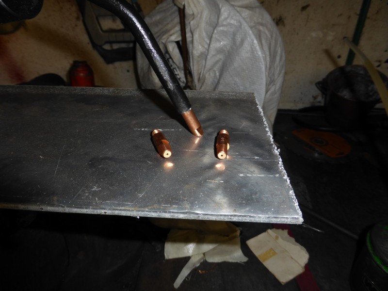

I know we've all seen made and used a welding hand but done something a little different! I've threaded the end and used mig tips for the contact this way you can grind whatever shape you want on the end eg/ a groove to help holding small round profile or just flat if that's better all you do is unscrew and grind the tip to shape or grind a new mig tip
