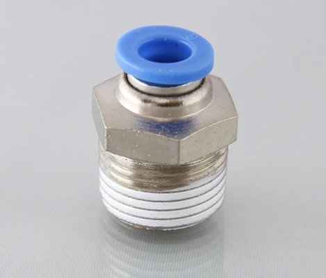

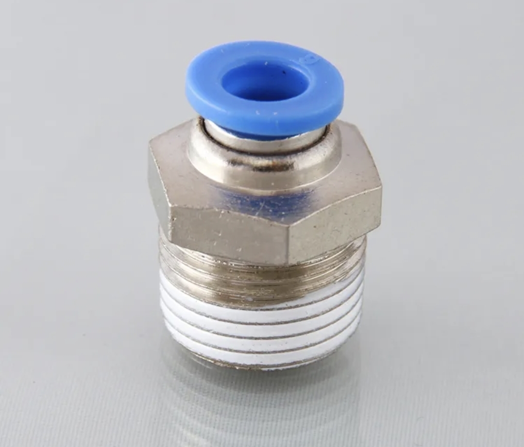

So.its a bulkhead I need to search for.4mm push-in fitting but that's not a bulkhead type. You might get it to seal into a tapped thread but doubtful in a 3mm plastic wall.
So it's a bulkhead I need to search for.

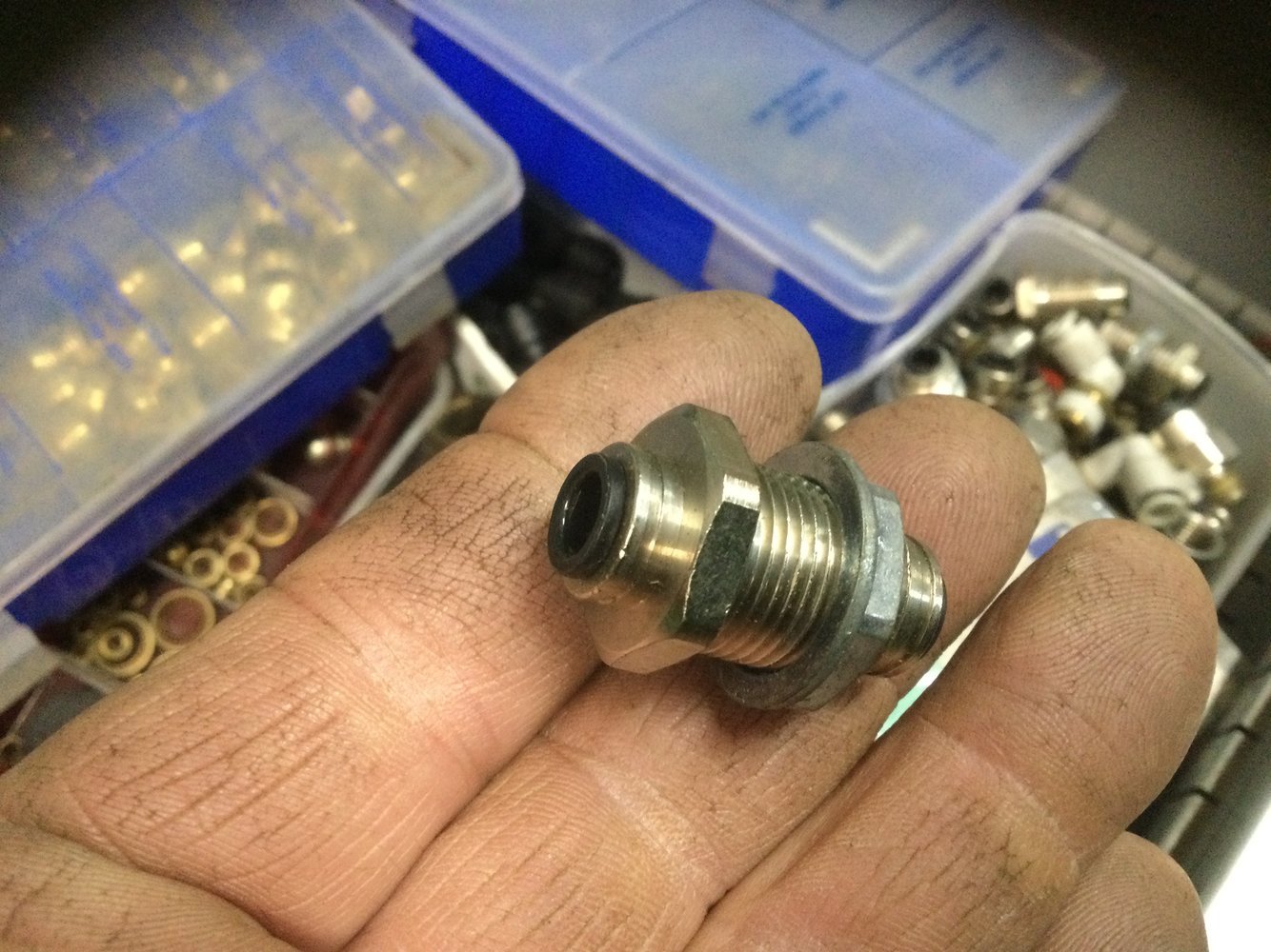

Cheers Bob. I have 6mm OD 4mmID pipe though but thanks anyway.I have a few 3mm bulkhead fittings, if you need one pm me an address and I will stick it in a Jiffy bag.
Bob

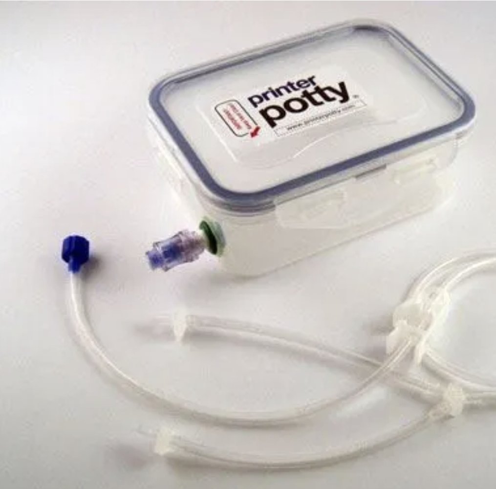

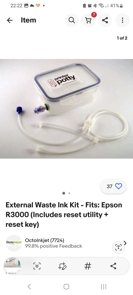

Yes, could have looked it up but it may just be an example and its for something else...The big writing on the photograph saying 'printer potty' might be a bit of a clue:
I am.using sublimation ink.Yes, could have looked it up but it may just be an example and its for something else...
So it appears Epson printers waste so much ink, that they require an external container
We had an Epson a long time ago, the print head continously blocked up. It seems the answer is, waste lots of ink...
