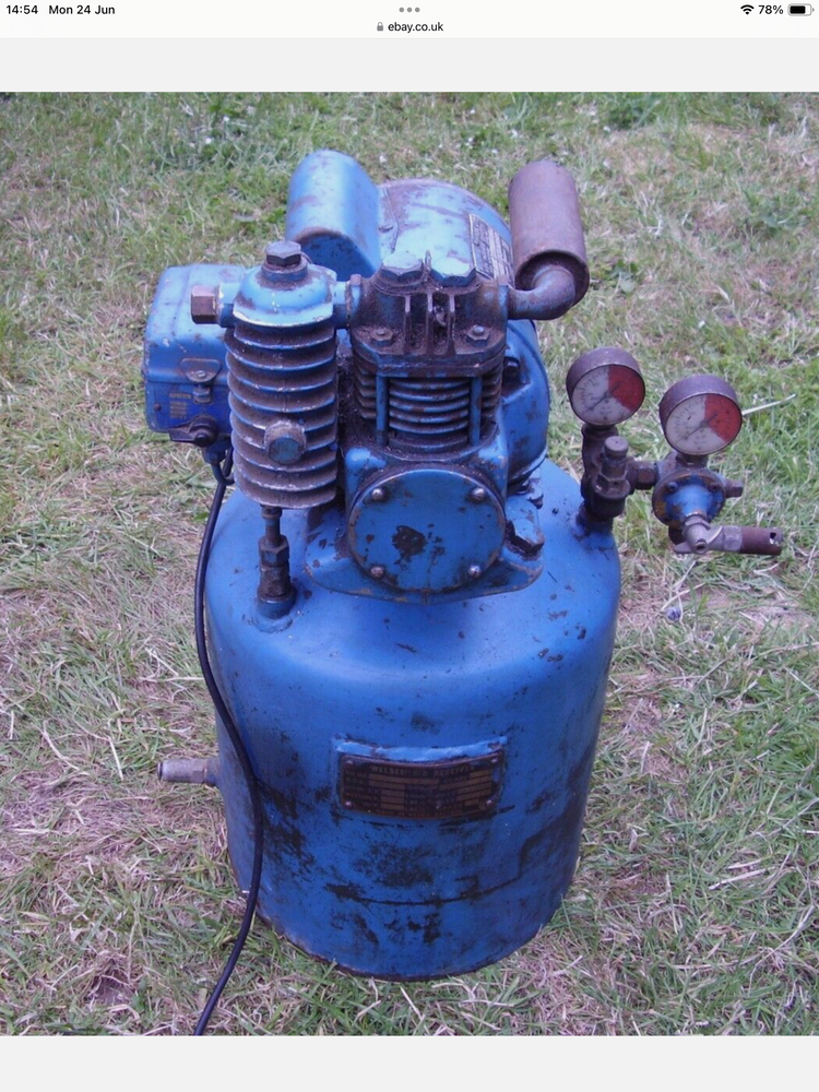

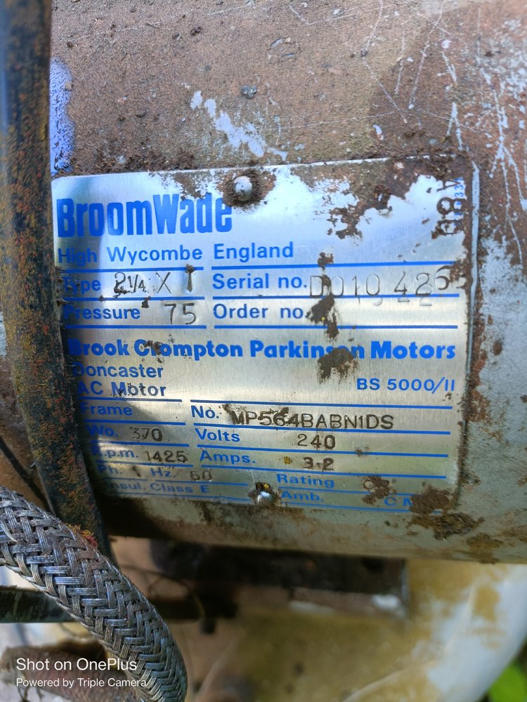

Thank you, the compressor looks like this (from eBay)if i am reading the data plate correctly the kw is 750w ie about 1 hp so very low power for a compressor would normally be say 3kw 4hp so the cfm produced will be low if my maths is correct. have you got a picture of the whole thing
There is a receiver. Different bore and lower p.s.i. For mine.There's one mentioned in another thread Mig welding 2x1. Looking at that I'd say as it has no receiver then its more suited to an air brush rather than a spray gun
