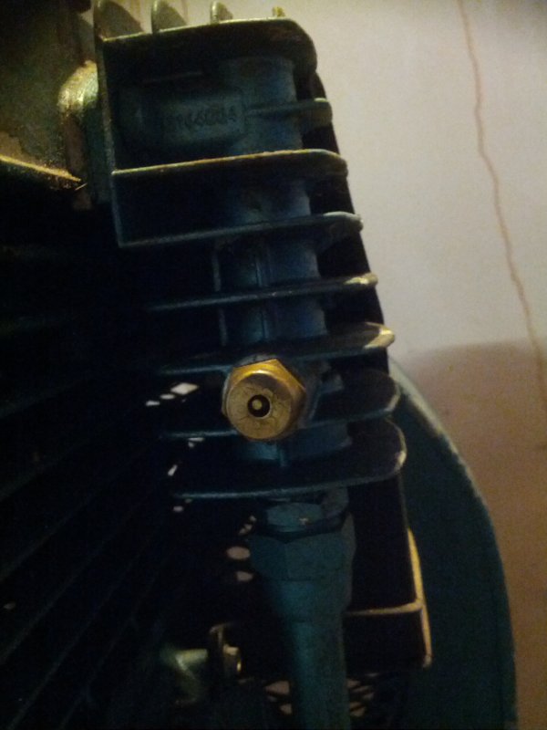

It stays open until pressure builds up to about 20 psi then it closes. It's to allow the pump to reach running speed before a load is imposed on the motor.
