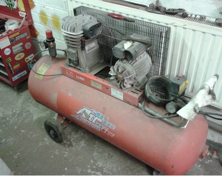

I have just brought a compressor off DrNik on here but have noticed it is low on oil but am unsure on the correct oil I need to buy ? also I have drained the tank and what came out was very thick rusty water , can I flush the tank out with clean water ? or am I just been stupid ?

the thing that looks more worrying to me is that the pump looks dry on the outside so the only way oil has gotten into tank is through worn pump internals.
I allways tend to use a thinner oil in the winter to help the starting, because thick oil causes drag but if yours is going to live alongside that radiator then that shouldnt be a problem.
motor oil is better than no oil.
because compressor pumps don't have an oil pump and more importantly a filter detergent motor oils should be avoided, IIRC motor oils also have a high sulphur content which absorbs water and can cause emulsification
some people prefer hydraulic oil
