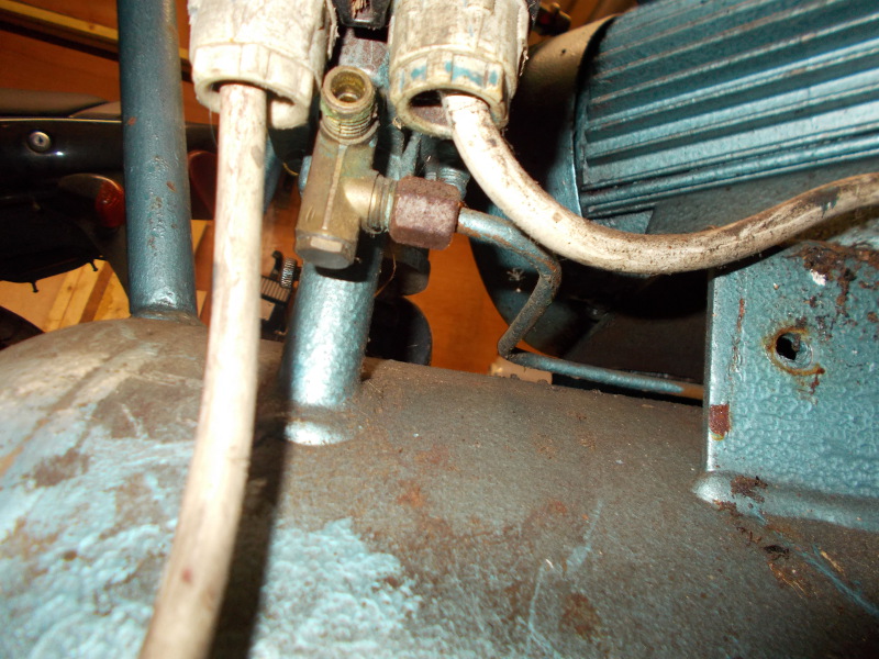

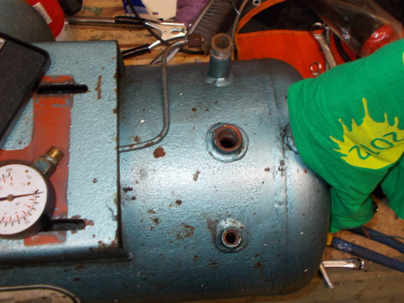

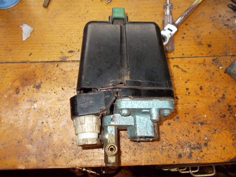

I picked up a "working" used compressor last September, since then its been rolling around in a relative's trailer until they passed by here in the week.
First time trying to start it buzzed for a few seconds then blew a fuse, seems the starting capacitor is knackered, so waiting on another one.
I also want to replace the switch as parts of it have been broken off and the "on" button won't work unless you smack it fairly hard. The main connection to the tank is 1/2" BSP female and the unloader valve is an assembly that pokes out the bottom and then connects sideways. It looks like an older version of a Condor MDR 5 switch, but I don't want to spend that much on one if I can avoid it.
Does anyone have any alternative suggestions? Is the unloader pipe likely to survive being bent and twisted to reach the bottom-entry position on generic Chinese switches?
Thanks
