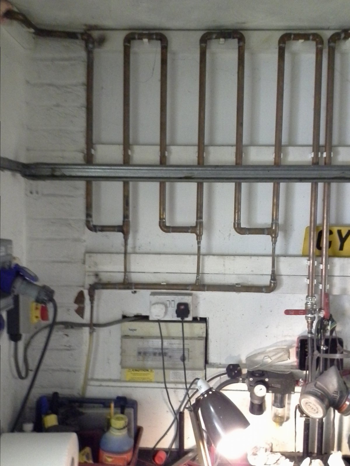

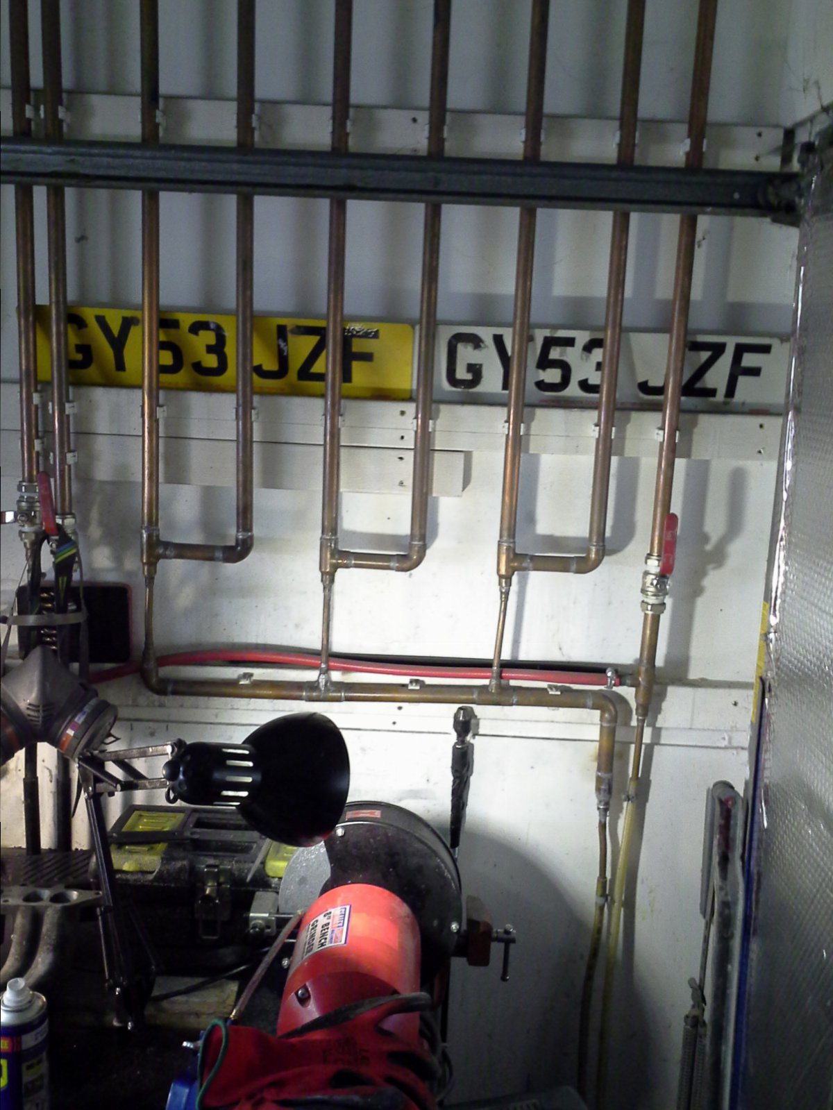

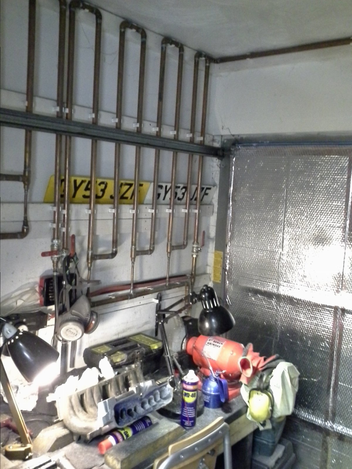

I've started building my compressor hut to move the compressors out back of the workshop. Is it ok to run in 15mm copper or should I use 22mm? I have a 3HP 150L 14CFM compressor and two small DIY compressors and at most I use an airfed mask and LVLP gun together.

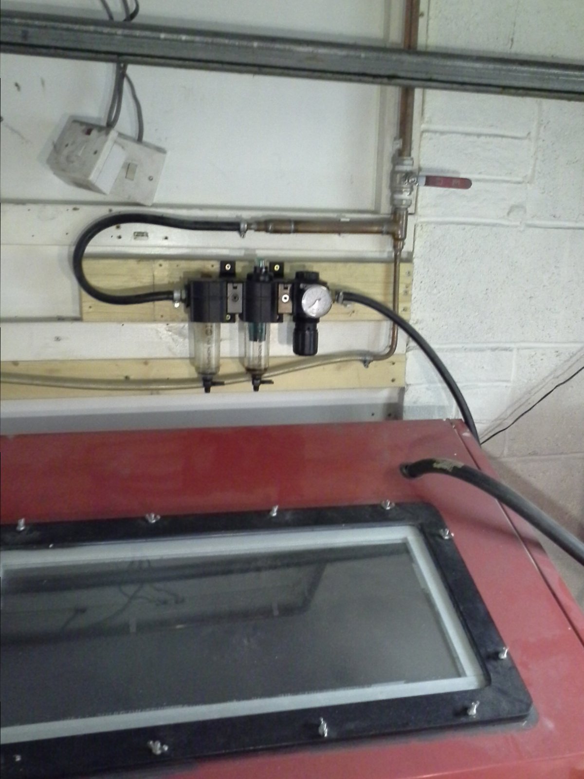

I have a Metalworks regulator which may be the bottleneck, it's same as the Devilbiss one, has 1/2" ports.
The compressor hut is only a metre away from the regulator and my quick connect ports but I was going to zigzag the copper a bit to condense out the water so that my desiccant doesn't get used up so quick.
