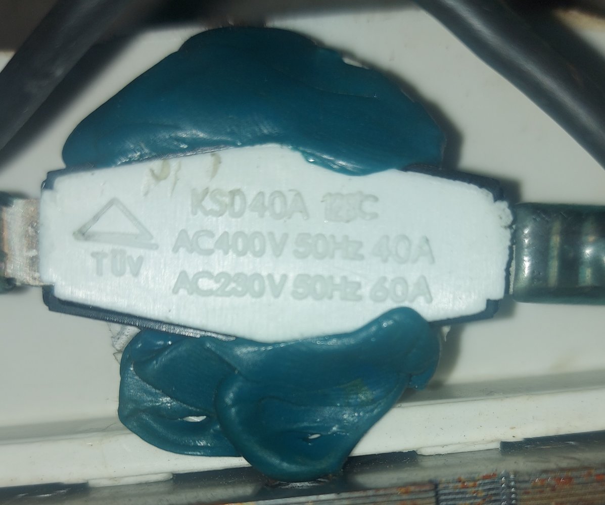

The 125 C thermal cutout switch will normally be closed. It is probably glued to the side of the main transformer...? Tapping or hitting it may help it to close again. If it has failed open-circuit, you could bypass it by joining the two wires together. For a replacement, search eBay for "thermal cutout switch".

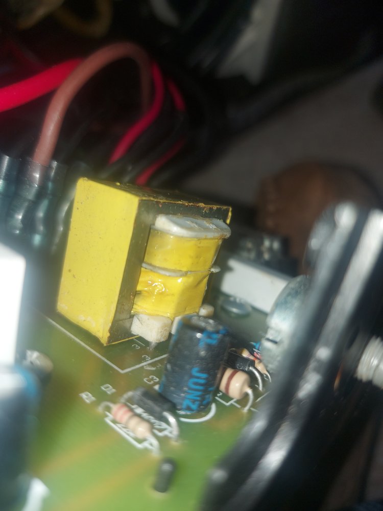

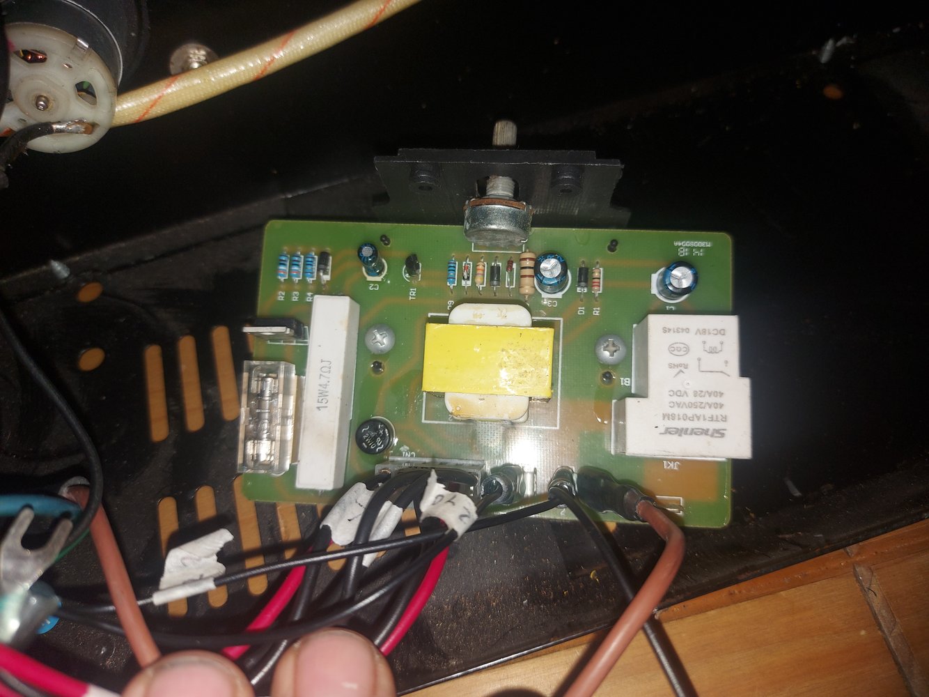

The small transformer on the board drives the relay when the torch trigger switch is pressed. The relay is marked "18v DC", so you need to search eBay for "PCB transformer 18v". To confirm that the component actually has failed, check for AC voltage across the secondary when the welder is plugged in and powered on ( and the thermal cutout is closed ), or for continuity of the primary and secondary windings. The resistance of the primary ( which is the most likely to have burnt out ) may be surprisingly high - up to 3k Ohms, and a couple of hundred Ohms for the secondary.
Post #3 of this earlier thread may be a circuit diagram of the welder:
and this may be the circuit diagram of the PCB:WOLF WELD 140 NO WIRE FEED!!!!

https://easyeda.com/Tonyataintree/wolf-weld-wire-feed-control-pcb
Even if it was in the supply circuit for the primary winding, a 10 Amp thermal cutout would actually be able to supply 2,300 Watts, which would be enough to run the output of a MIG welder at 100 Amps. However, as per the diagram I linked above, the cutout is only in the circuit for the primary winding of the small control transformer, so a rating of 10 Amps, or 40 Amps or 60 Amps is unimportant.
However, on closer inspection of that diagram, I was wrong about the cutout being normally closed. It should be open, and at high temperature it will close and light the Overtemperature indicator. Is your cutout open or closed, and is that light on or off?
Here is an example of an eBay listing for the small transformer:
This may require extra holes and wire links to allow fitting to the board.
