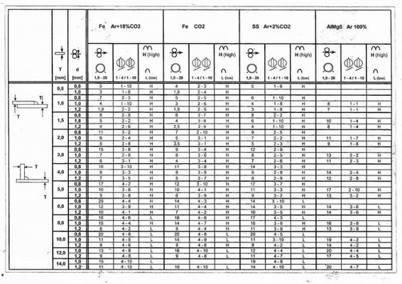

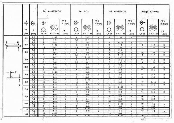

hello i got my swp 210amp welder the other day and was hoping it would come with Wire speed and power setting suggestion chart, but it did not anyone know where i can get one
yes iv seen that mick.. but are based on experimental results from a Clarke 90EN, a Clarke 155T, and a Portamig 181, and gaps have been filled in by extrapolation it something to work of tho
may be someone will have the swp setting chart ??
I Agree Its Not Perfect But Approx Settings Will Do - Plug In And Play With Settings On Some Scrap To Get A Feel Of The Machines Settings And Take Some Notes As A Reminder. 2-3mm Is Best To Start With.
I Have A Chart For My Clarke Mig But Its Just A Guide Really.
