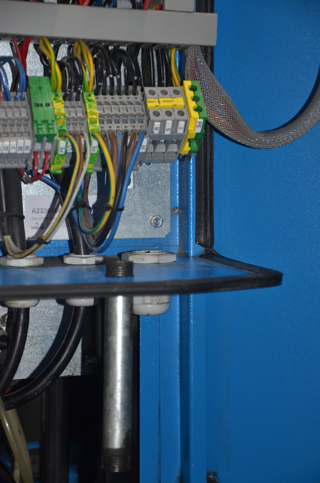

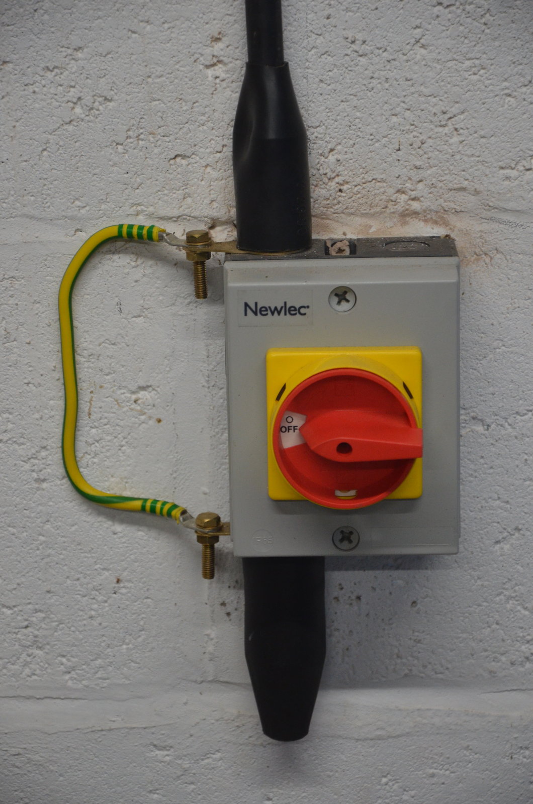

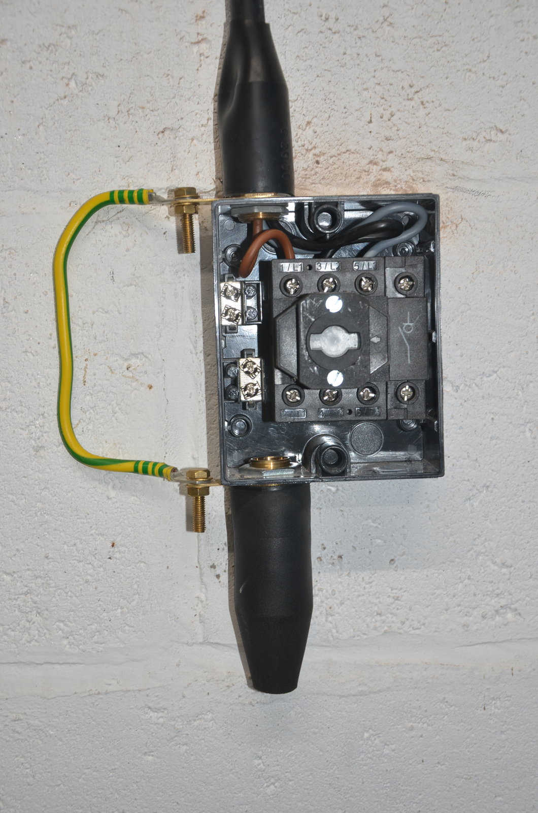

I was wondering what is the best way to wire in this compressor . Should I use armoured cable clamped to the compressor or should I use a 4 core cable and plug it into the block which has connections for the three phases and an earth connection.
def flexy cable for no other reason than vibes and if u hve a fair length u can move it, asuming it's on wheels to sweep underneath.........or is sweeping a dirty word.........hahaha......
frank

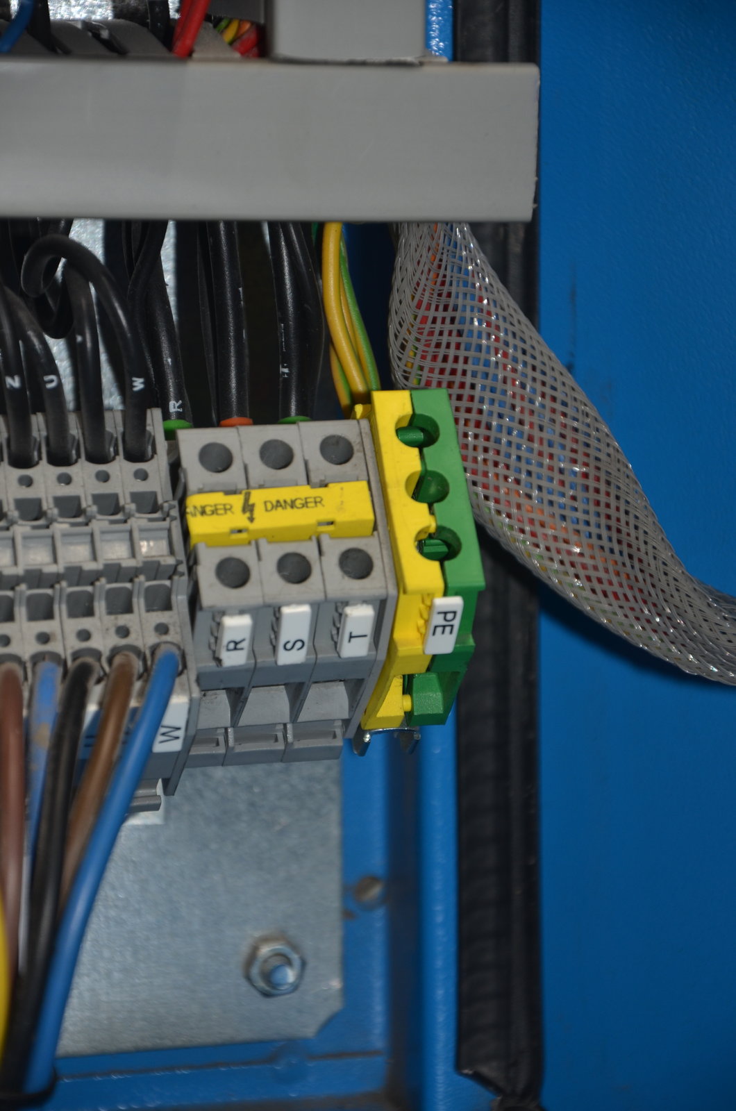

I was going to use flexy cable but was wondering about the actual connections. In the manual it says to use 6mm core which I presume is the thickness of the wire for each phase. I presume I would get flexy cable with 3 wires for the 3 phases and an earth wire for connecting to the block?
Hi Chris It is a 11kw motor,i forgot to say,would the first cable you selected be large enough? When it says in the compressor manual it requires 6mm wire,is that in total or for each phase? Cheers Andy
6mm should be fine 11kw 15hp the full load current will be around 22Amps at 415v .
But at above if you are not sure its best to get it looked over.
The most important test is that the earth has full continuity back to the point of origin.
Looking at the control pictures i can't see if this compressor has a phase failure and rotation shut down unit built in.
If it has and its wired out of phase it normally wont let you start it up.
But if it hasn't you need to find where the direction is marked(often close to the drive coupling) and very briefly power up to see its running in the correct direction.
Caution some screw and vane compressors can be damaged by incorrect rotation, make sure you find out first, if this is the case you would be well advised to seek out a compressor installation and supply company to commission or a electrician with industrial experience and the relevant test gear to confirm the phase sequence prior to applying power.
