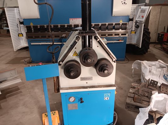

Way back but we got an urgent job to build two machines to make the rebar stirrups for the piles they used to support the Drax Power Station.Four passes through one of these, experimenting with roller pressure. You might have to put a small, constant bend into it with the first pass and then remove it with the 180 degree pass. After the first length, you will motorise the roller.
Heavy Duty Ring Roller, Tube, Square, Flat Bars, Roller, Profile Box, Roll Bende | eBay UK
Heavy Duty Ring Roller. This is hand-held device attached directly to the table. The pictures show full versions with flat bending rollers. The roller is equipped with a ruler for easy repetition of arches.www.ebay.co.uk

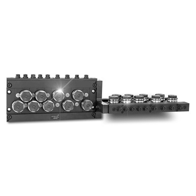

This is what is used for circular wires. As in the link above, a super-duty version would work for box section:
Witels Albert PR NT Series Straightener - Techna
techna.co.uk
