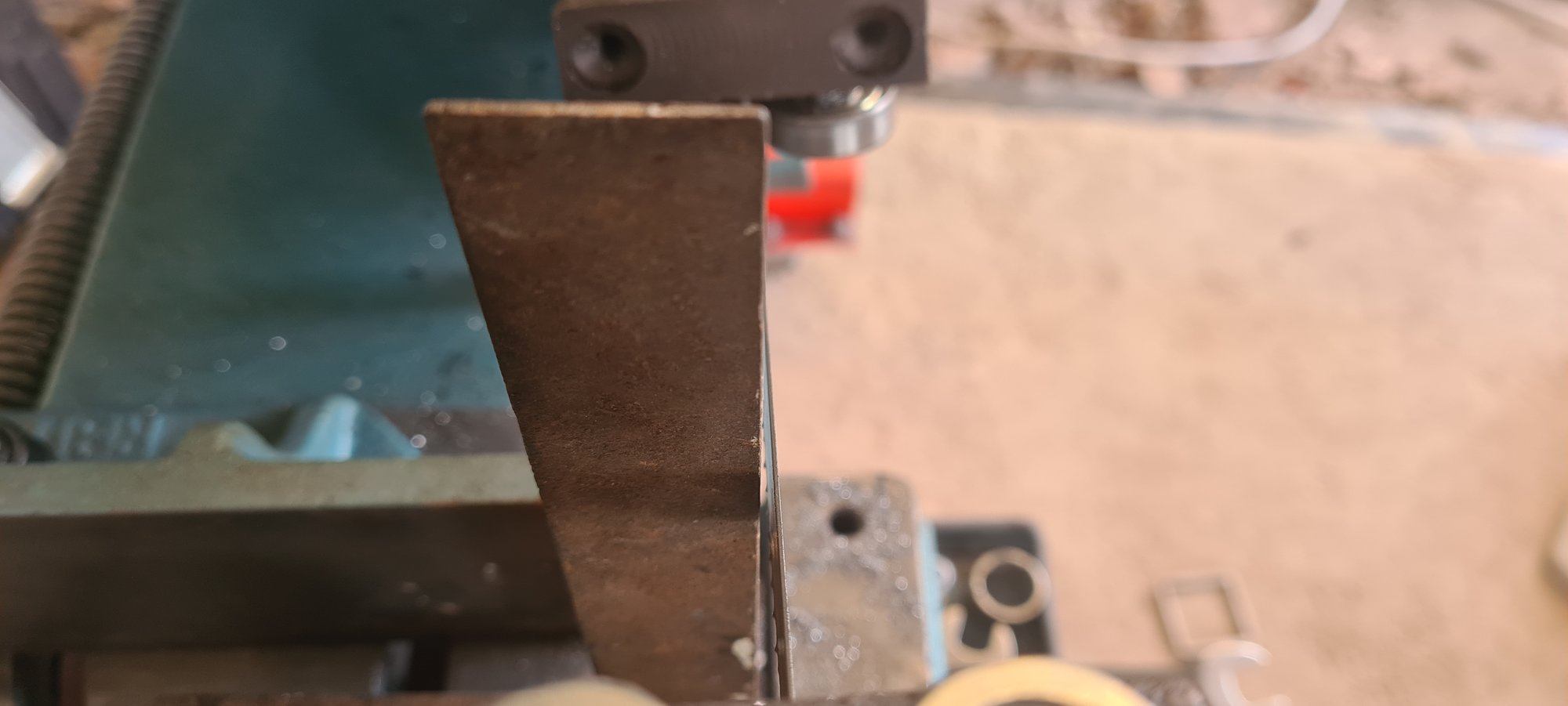

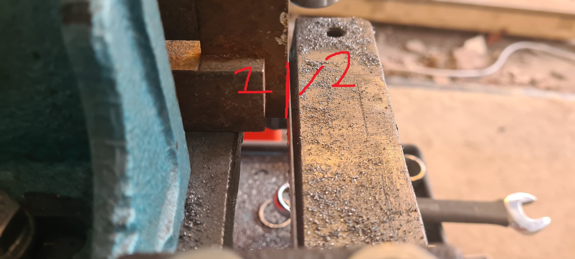

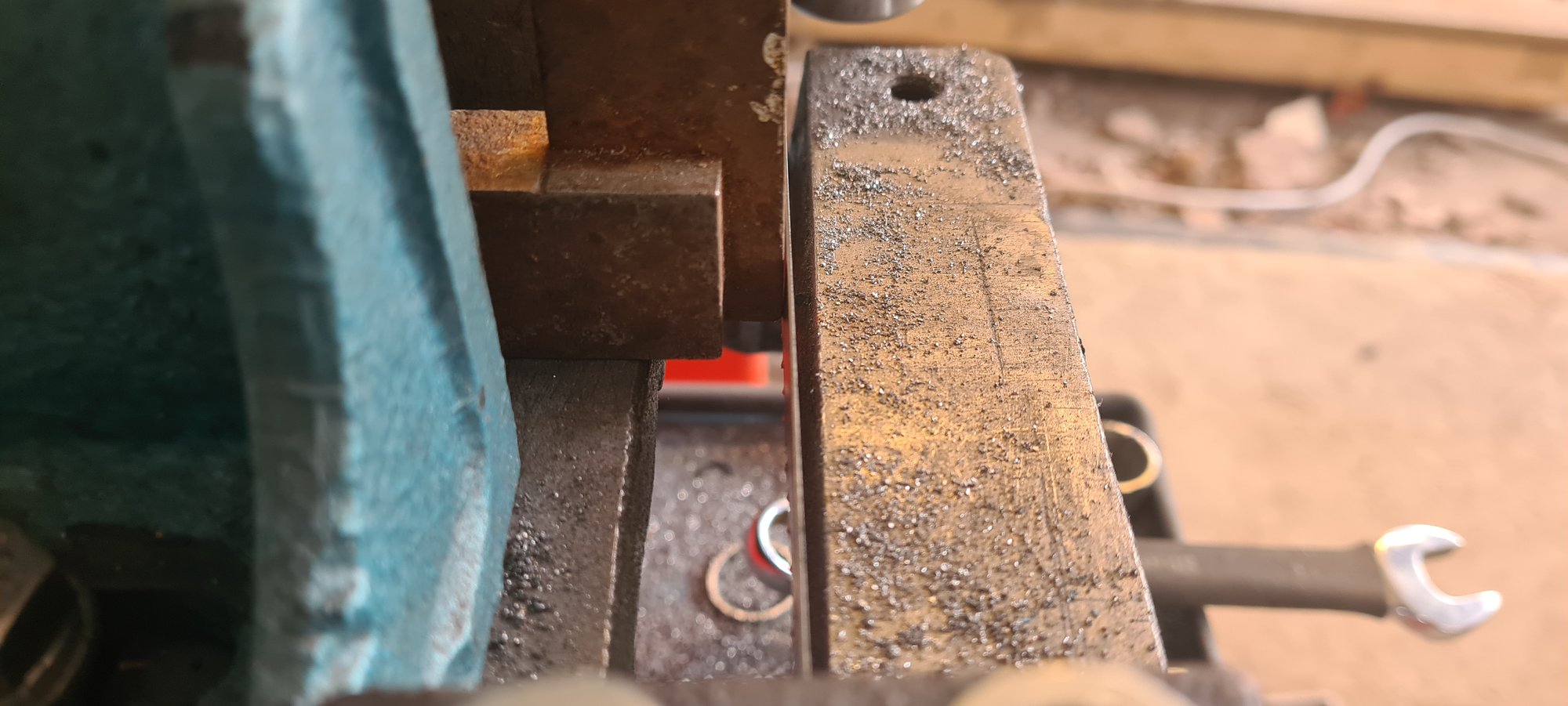

Well picked up the band saw off @WvW that we knew was not cutting straight vertically Last night and today i spent a few hours setting it up the best i can to find out this.
bottom of cut the blade is touching the square but when around 75mm up when raised the arm, so in effect at point of the start of the cut its away from the square by a good few mm.
bottom of cut with squared up blade
and start of cut
So this is what is making the cut out i would guess.

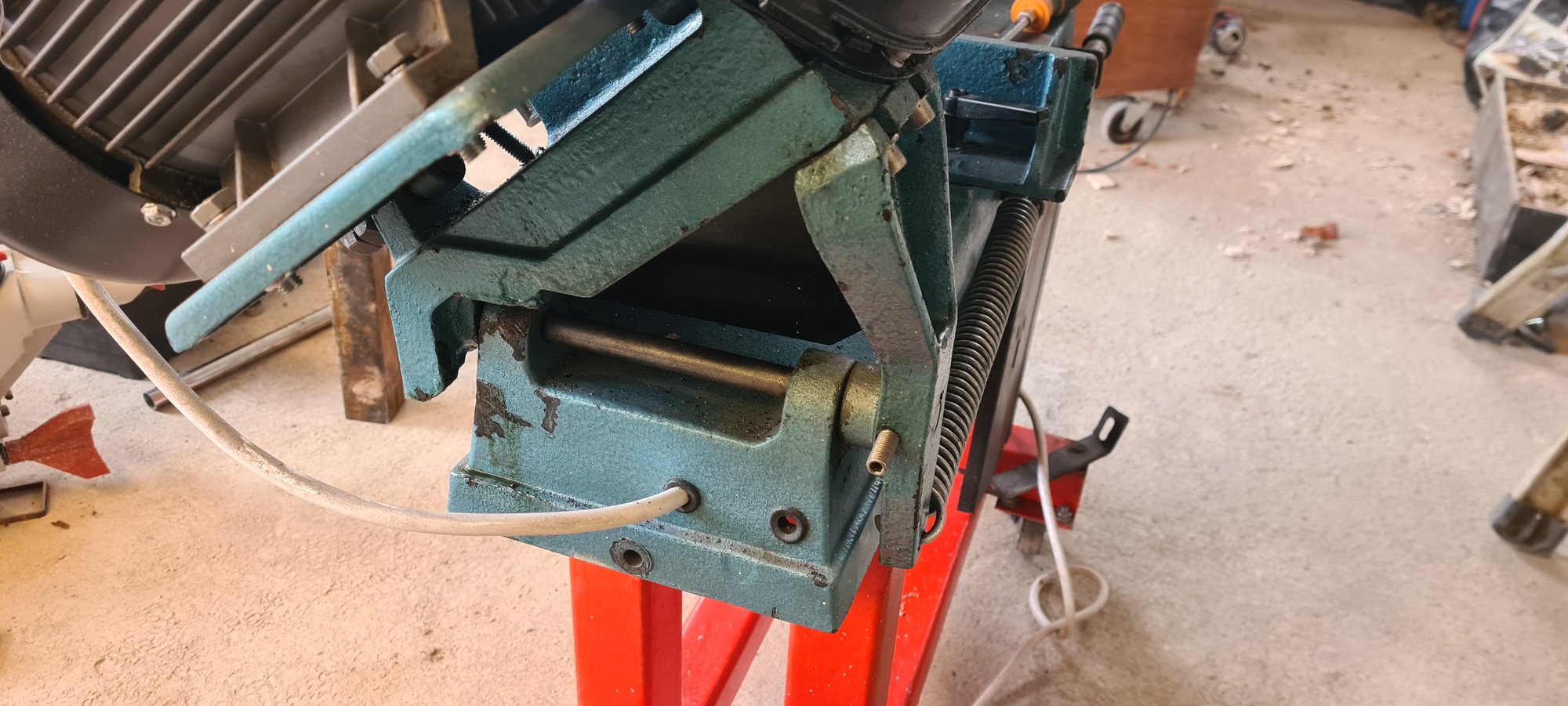

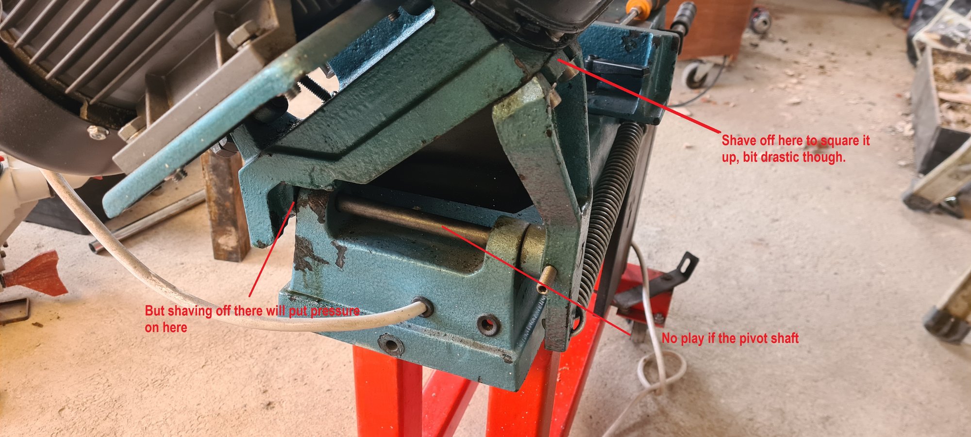

All i can think of is that the pivot point is out. I cant see or feel any ware in it.
.any idea please folks, or is it a scraper ?
