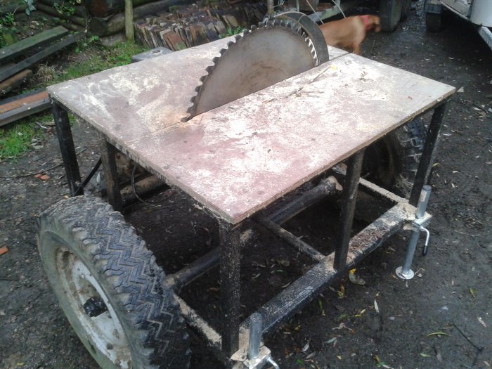

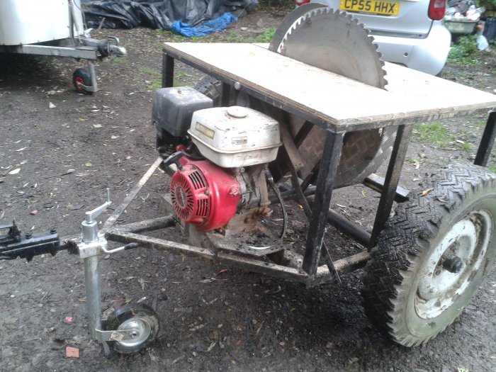

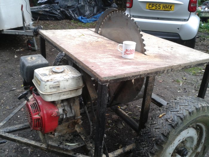

i built this last christmas holiday, it started off on a scrap heap as a worn out saw blade, a broken generator rotating shaft with bearings, and whats left of my horsebox trailer,
took the engine off the generator, 11hp engine which starts first pull, added a double pulley, made a frame out whatever i could find fitted the blade on the rotating shaft, kept undoing the nut when it spun so put a locating peg on the saw blade so it wont over-run, bolted the axle on and a couple pieces ply on top, a reeving knife and an underguard, can be towed behind the landy if needed
was a bit scary on the first couple of goes, the blade cuts very well despite having a few teeth tips missing,i can have the blade nearly past singing, should make a top shield sometime, maybe over xmas
there is a blood brothers cup for scale (apt mug maybe)
