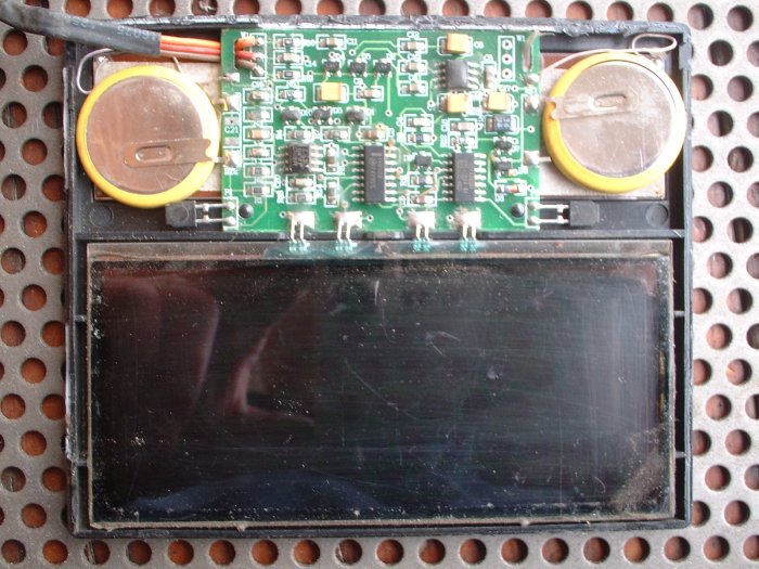

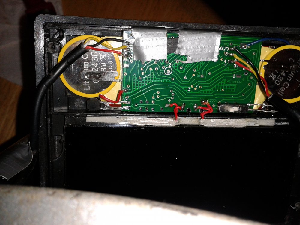

They've all got batteries - just some don't advertise the fact and/or they aren't realistically replaceable. I had an Esab I quite liked but the batteries had gone so after I'd got the replacement I tried cracking it open to see if I could maybe replace them and have two helmets - the innards were full of potting compound so no way to extract the old batteries without doing damage.
