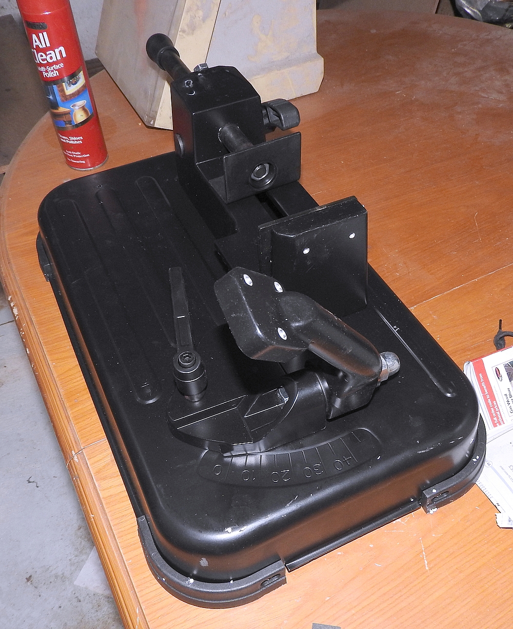

First impression.

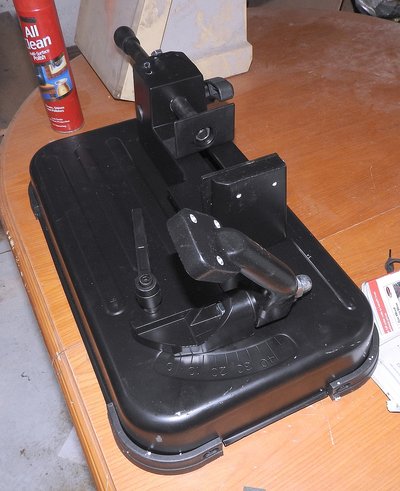

Well made; the base is pressed steel and weighs 7Kg. It has quick-release vice and the arm which the saw itself fastens to:
You can rotate the arm about the base to give up to a 45 degree cut. The machine screw with the lever attached clamps the arm in the desired position and the lever can be re-positioned on the screw so it doesn't foul the saw when it is lowered. The arm and vice castings are aluminium.

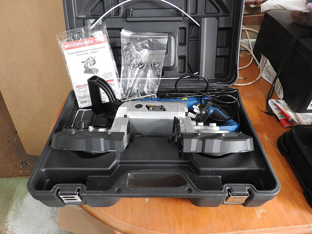

The saw itself is made from plastic and aluminium, weighs 10 Kg and comes in a moulded case:

Assembly.
Assembly is straightforward, the instructions are very clear and printed on good quality paper. There are two points worth mentioning.
1) I feel the screws holding the saw to the arm could be a bit longer, they screw directly into the aluminium casting.
2) It tells you to adjust the guide bar, but doesn't say what you are trying to achieve by the adjustment. In fact the guide bar is a stop which limits the downward travel of the saw, I set it so the teeth on the blade just drop below the vice, thus ensuring cutting all the way through without moving too far down.
Installing the blade was fun. It's quite stiff and at one point it jumped out and bit me on the forehead. The manual advises wearing gloves when fitting the blade, a hard hat wouldn't be a bad idea either. There's a simple lever to tension the blade. It has 2 positions, tight & slack, no adjustment.
There are two handles but when using it with the base you just need the one with the trigger. It looks like the other one would allow you to use the saw without the base, but this is not mentioned in the instructions, but there is a photo of someone doing just that.
