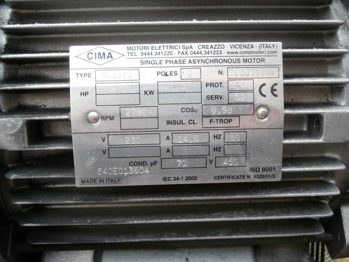

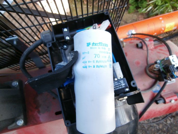

I have recently perchased a new compressor (SIP 13/200 belt drive compressor). Looked to be in really good condition and was sold as a runner but when plugged in it just buzzed and blew fuses. The motor and the pump both turned freely.
Had a good read of some threads on here (Thanks Guys) and when I took off the cover from the motor it was obvious that capacitor was blown (quite literally).
Can anyone confirm whether this is a START or RUN capacitor? How do you tell?
Many thanks (and apologies for my ignorance)
