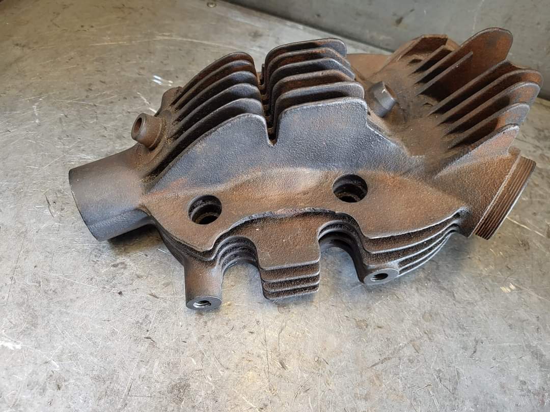

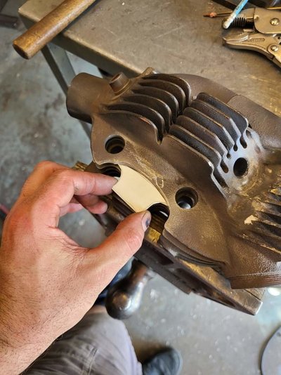

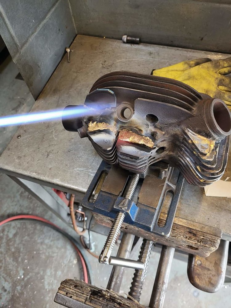

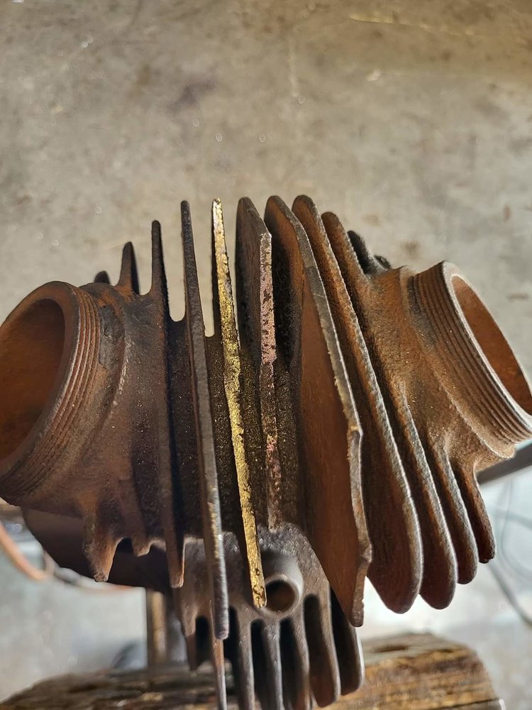

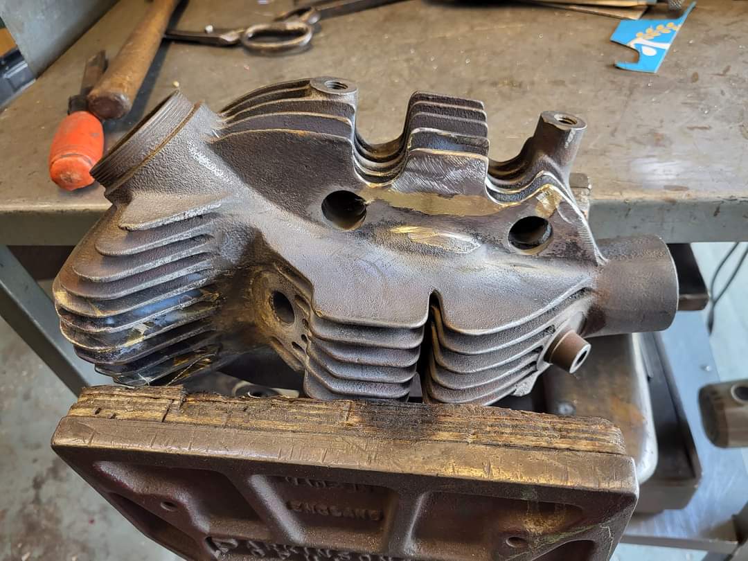

Fazerruss Member Messages 3,039 Apr 20, 2024 #1 Here's a repair I did on an old Sunbeam motorbike. This was a serious challenge as it had 10 broken fins and they are cast iron. Made new fin tips and brazed them on. It was bloody tight for space.

outofthefire Member Messages 2,854 Apr 22, 2024 #3 Great job, do you use old fins for the repair material?
Fazerruss Member Messages 3,039 Apr 22, 2024 #4 outofthefire said: Great job, do you use old fins for the repair material? Click to expand... No the old fins were long gone. I made new ones from mild steel
