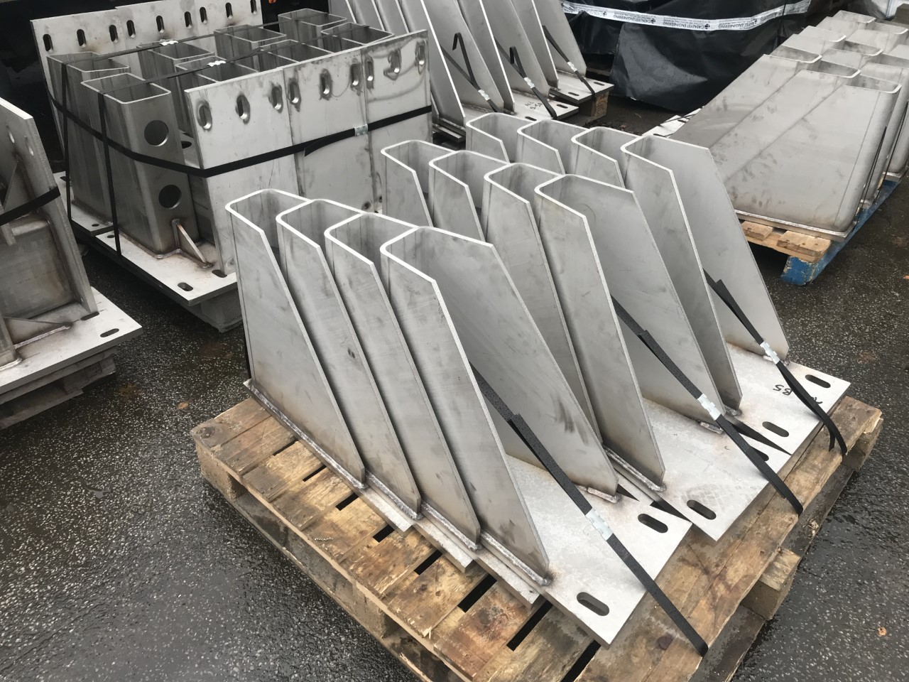

Don't think i've posted this before.. 350+ stainless brackets made up from 25, 20, 12 and 10mm thick plate, laser cut and pressbraked. 250x150x10 stainless RHS brought in from overseas. About 35T in total.
These hold up some very large and very heavy overhead precast concrete beams on collanade walkways on a certain very large job in East London, 15M above street level.
6mm CFW, 10% DPI, and to Execution Class 3. A good few days of drilling holes and milling slots
Some photos of a few of them.
