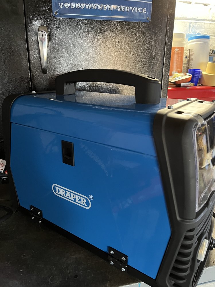

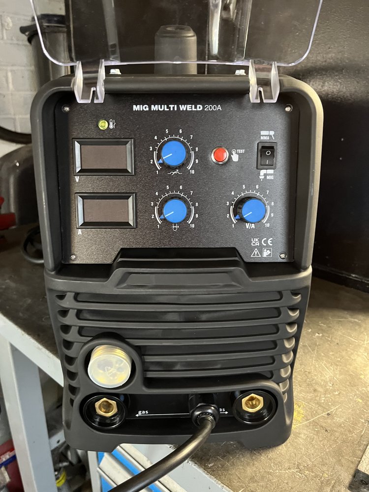

Hi I’m about to set up my new welder for gasless welding on sheet metal I just need a starting point as to where I should set the controls so I can work from there ? I’ve only ever used my old sealey transformer welder with gas ! Regards
Hi there, I'm definitely not an expert on welding but I think I started by measuring the wire feed speed on each setting using a tape measure and then comparing against some charts online.
So wire speed setting one: hold the trigger for 6 seconds then measure and multiply by 10 gets your cm/per minute. I did this for each wire speed setting on my machine and made my own chart.
Hope this helps to get you started.
