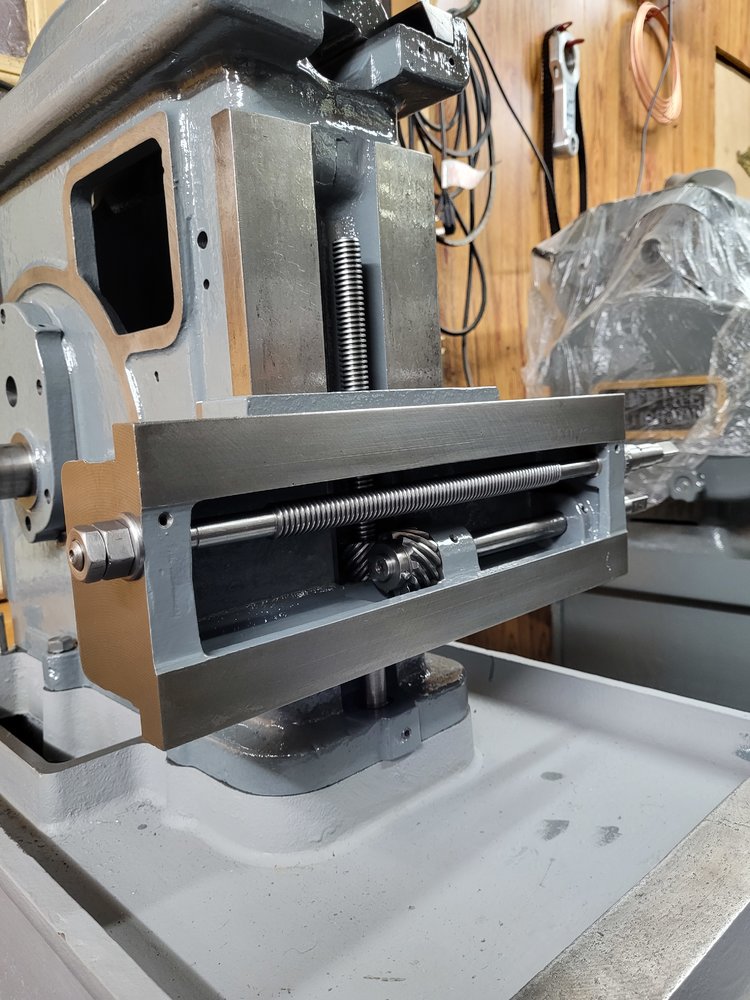

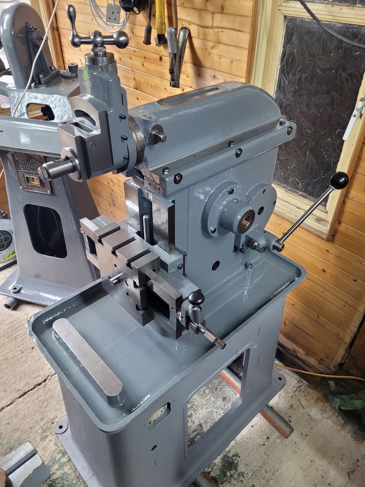

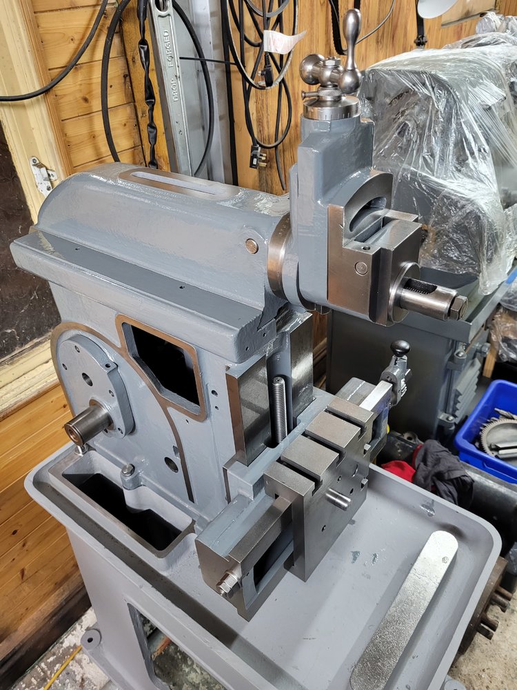

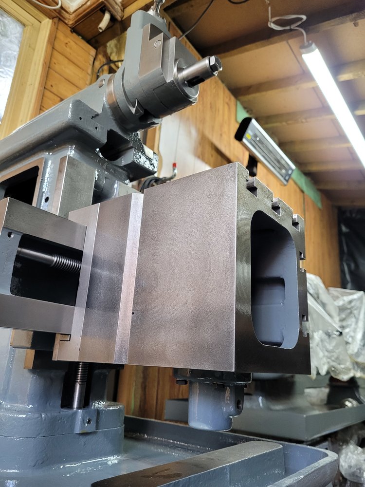

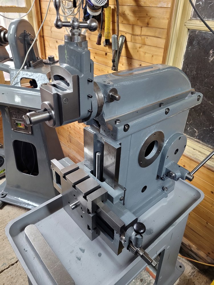

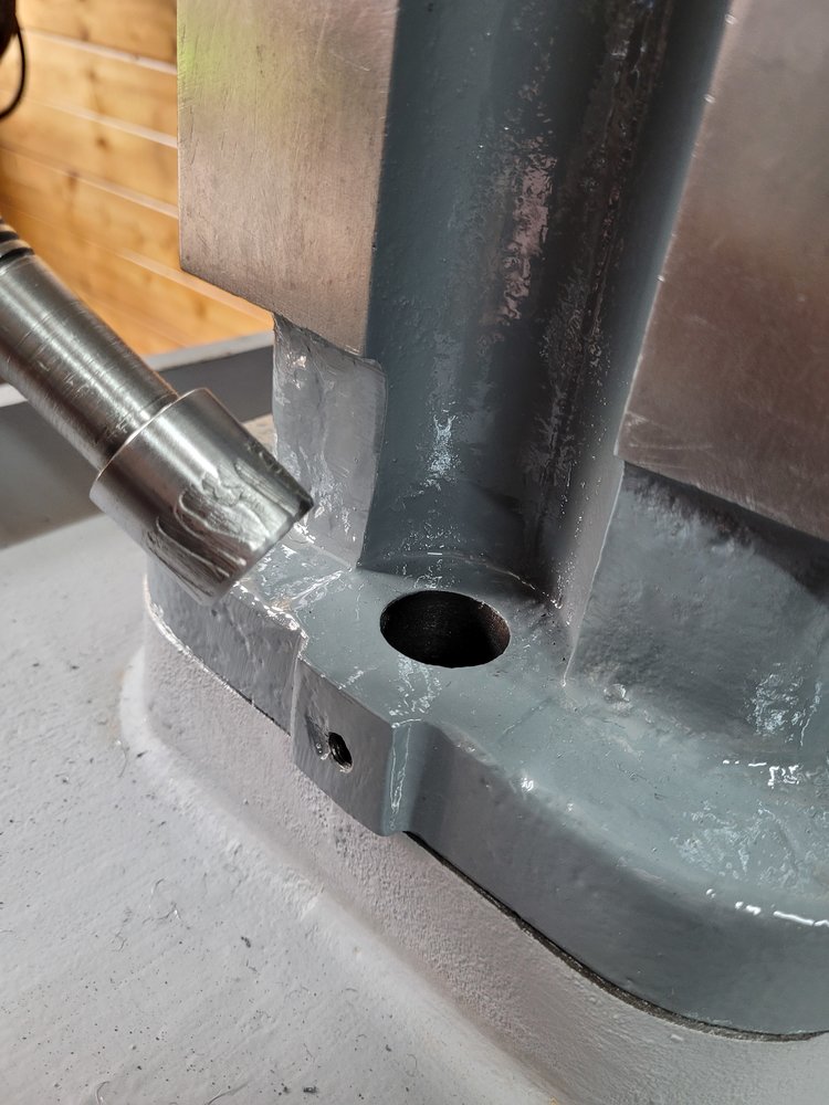

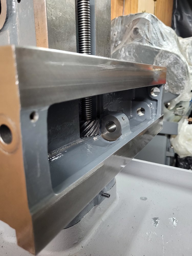

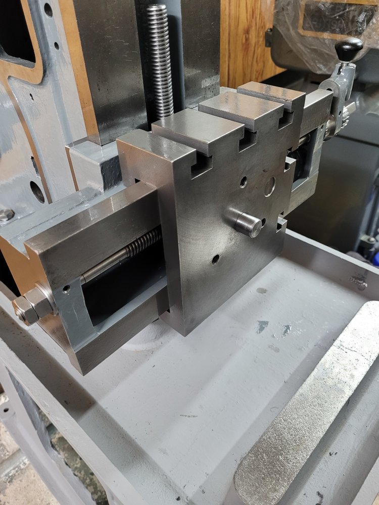

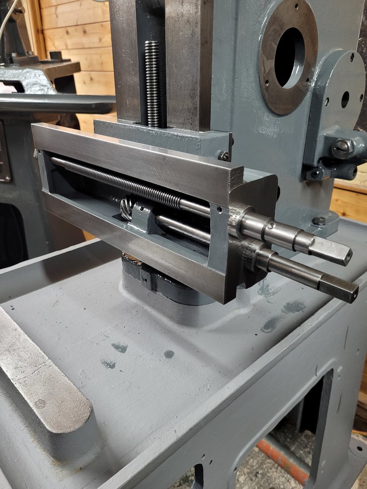

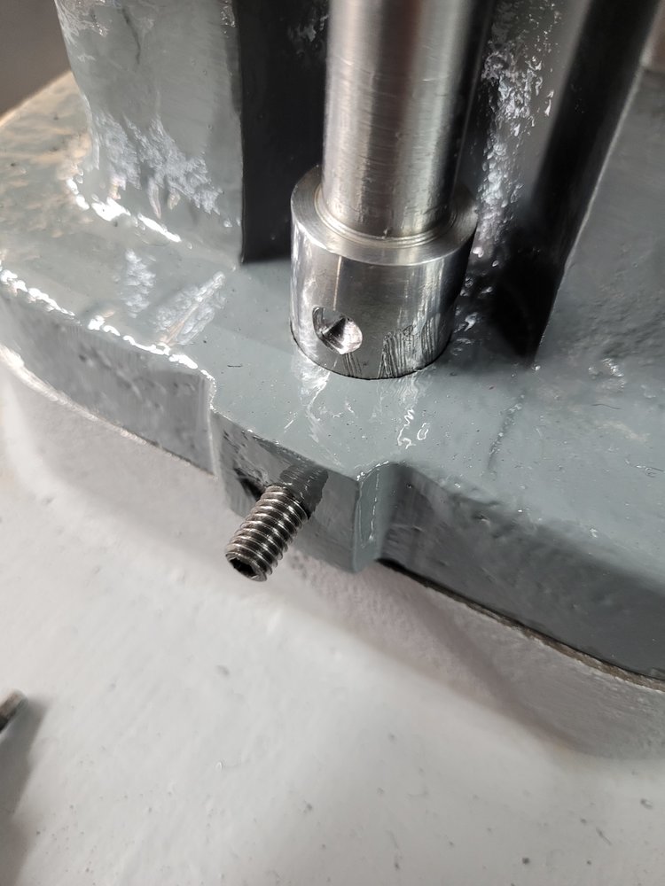

I did look at that and thought swarf could possibly get it. Now you mentioned it I will indeed make a note znd look in to itLater versions have a tube over the vertical screw to stop chips getting to it and causing it to jam, maybe worth thinking about fitting something similar while you're in there.

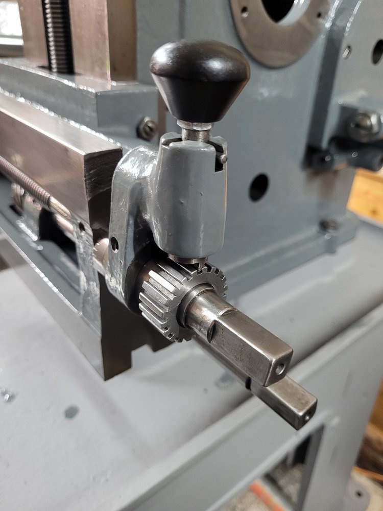

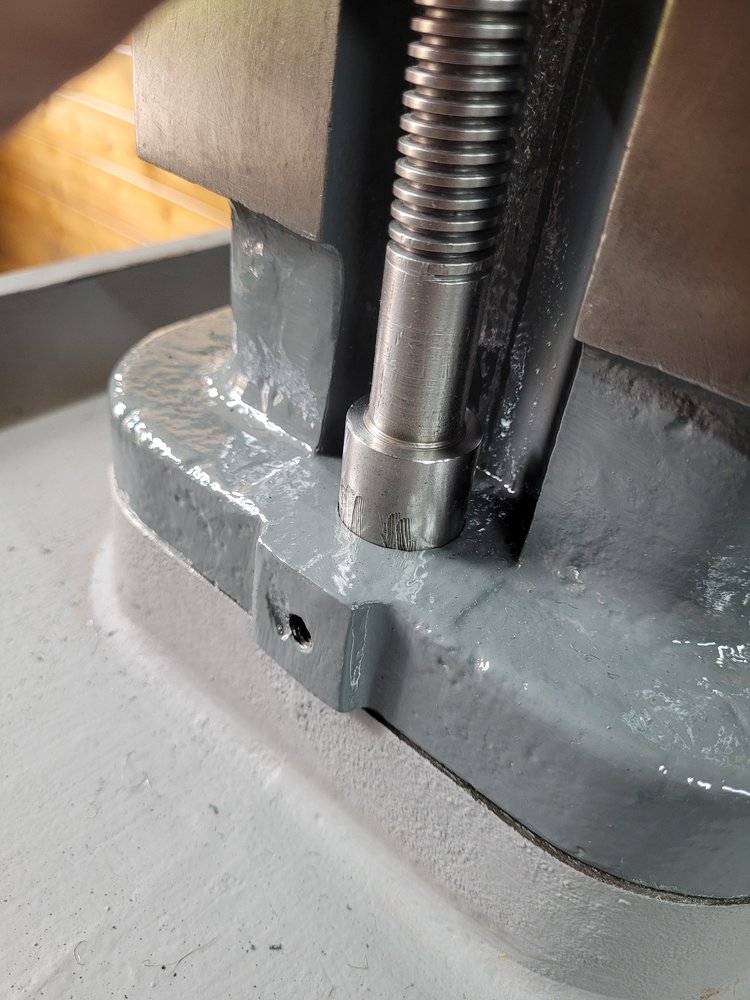

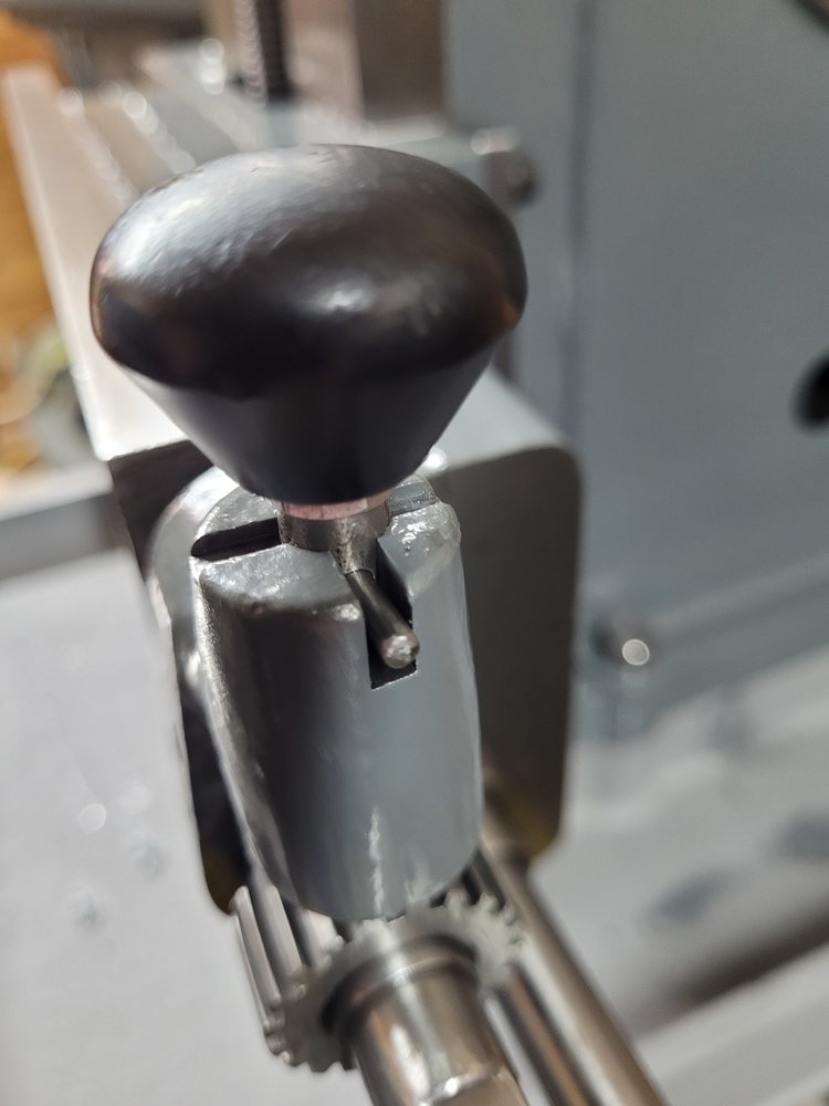

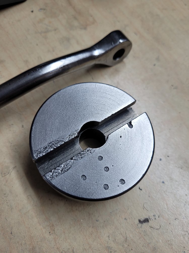

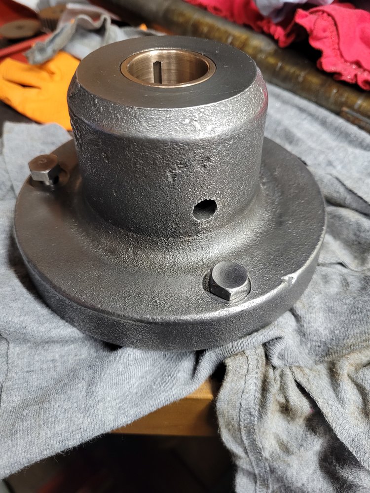

A couple of bits that absolutely annoying me... this part in its past has had a little bit of stick from someone previously not using the correct washer/spacer resulting in this chewed up area and those little holes that must be a castings defect. A new one latter being made I thinks...also need to replace the very small taper pin that holds the plunger in the upwards position...and I accidentally smudge my paint...

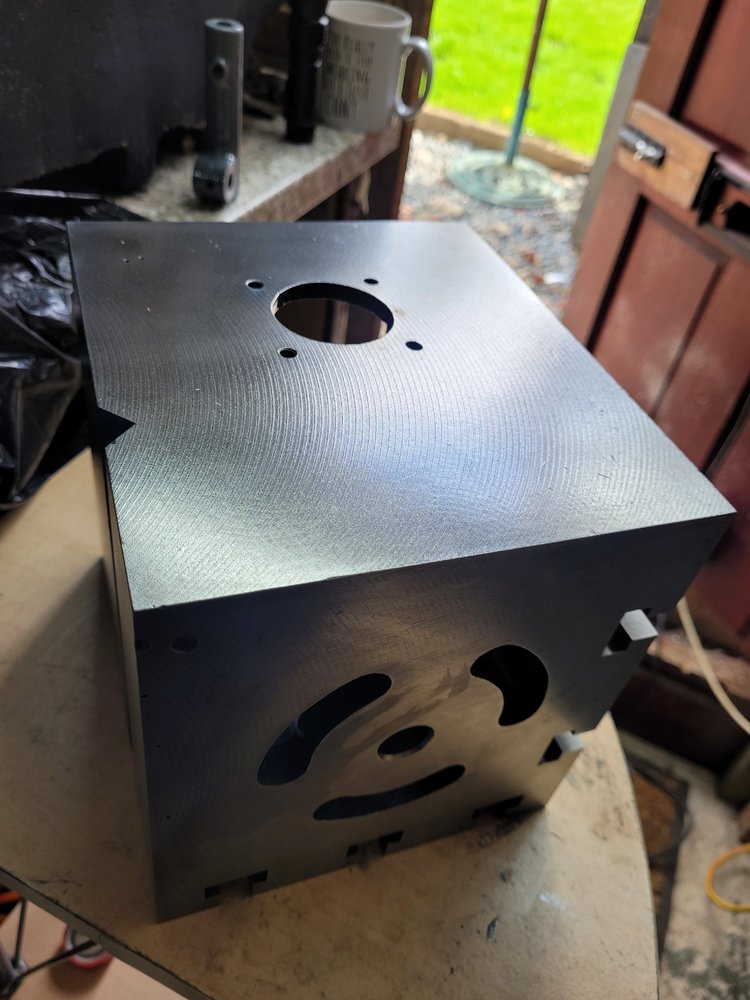

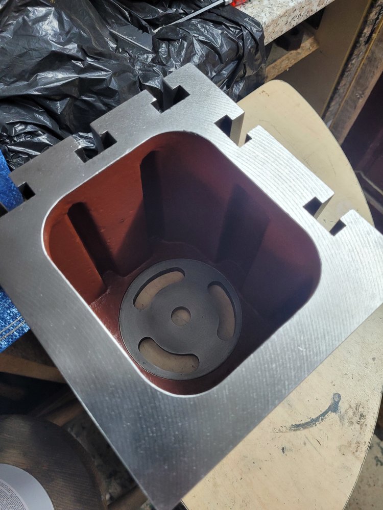

Will do Pete. Or I could borrow the monarch when I visit at some pointI'd chuck that up and face it off. It's probably only 20 thou deep.
