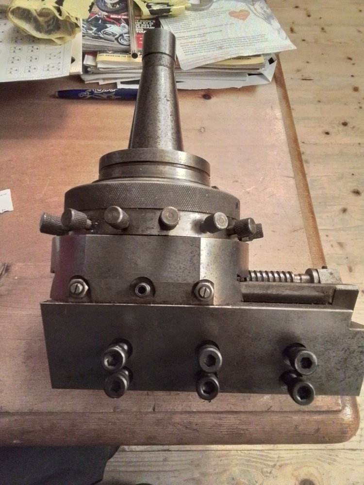

No idea but only a few machines could give that some serious RPM
I would not want to spin that very fast, looks like a #30 or #40 taper.No idea but only a few machines could give that some serious RPM
He wishesIt has the look of a Wolhaupter.
Indeed so.I would not want to spin that very fast, looks like a #30 or #40 taper.
Also the boring bar is on an extension, looks like it can go out to 6" or so.
That's allot of un-balanced weight swing 'round.
What is the function of the radial adjustment screws?
I don't think it's a Wohlhaupter.
Narex and Kuroda may look like copies but they are on par or better made in some aspects.100% it is not, for exactly the reason you state.
The 'other side photo' is a good call as it would show the trip dog arrangement.
Old Emil would be boring a hole in his coffin and facing downwards if he thought his name had been attached to that.
Wohlhaupter seems to have been the one that everyone else copied - Narex, Kuroda, Vertex, the Chinese one ArcEuro sells all look the same and work in the same manner.
